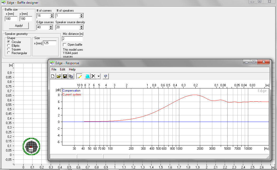

This is true, I have not seen anyone do that however. One of the things that concern me is having a driver in the middle of the baffle, that should give problems with diffraction. Maybe I'll try to design an asymmetric cornu...[\QUOTE]
The boundary can be any geometry you like, e.g., an offset ellipse would be my choice.

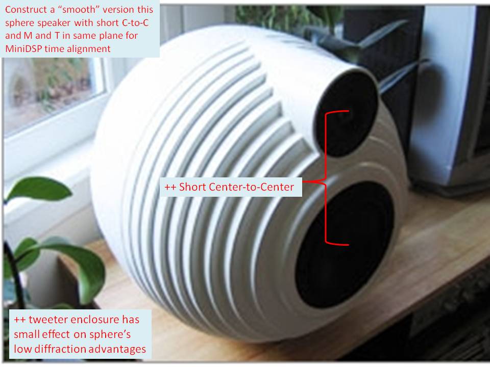

Interesting! Thanks for the info.Smart Sphere enclosures:
French.... includes modest amount of absorption material at the rear of the sphere, plus a resonant rear chamber that removes the 3D equal path lengths in a sphere.
British.... Sphere + stuffed rear tapered tube to spread out resonances and absorb rear cone eneregy.
A rotatable MT with tapered/beveled edges also has good diffraction response. Just add a W or WW bass bottom for a proven design with many DIY Xovers on the web, including SBacoustics. It can be painted to match your cabinet colors. Camouflage?

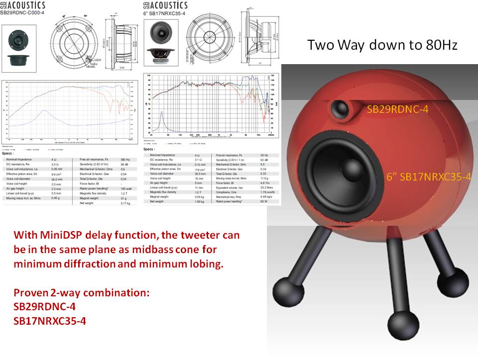

I read SB29RDNC as SB29RDC and made this:2-way
With MiniDSP delay function, the tweeter can be in the same plane as midbass cone for minimum diffraction and minimum lobing.
Proven 2-way combination:
SB29RDNC-4
SB17NRXC35-4
