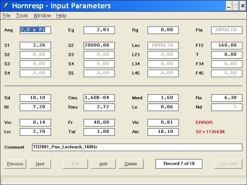

Hello,
An important thing if you want to build a Le Cléac'h horn and in order to reduce reflection of wave from mouth to throat is to continue the profile until the aperture will come back (angle at the mouth greater than 180°). To do this use the wizard and for a given cut-off frequency entry a large value of mouth area. Hornresp will indicate you (in red color at bottom right ) the max value to entry for the mouth area. This will lead to a more complete profile.
See attached file:
for this example of a 160Hz horn the max area for the mouth should be 11354cm².
Best regards from Paris, France
Jean-Michel Le Cléac'h
See attached file:

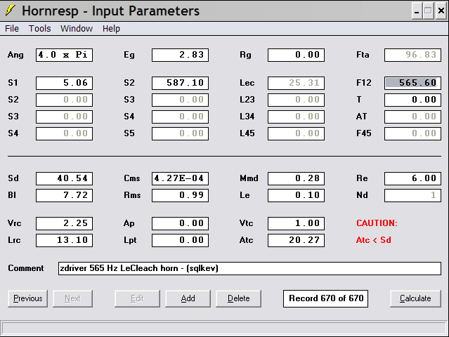

GM said:Well, I'd never tried to do a LeCleac'h using HR and with its HELP files being a bit cryptic/hard to read (for me) I just used a theoretical 1" compression driver I'd done to sim a 400 Hz Tractrix recently to experiment with.
Anyway, designing a 565.6 Hz expo for an 800 Hz loading (0.707*800 ) using the horn Wizard, then hitting the 'L' key when the L12 field is highlighted (AKA 'has the focus' in the HELP files) magically makes it a LeCleac'h, then hit 'calculate' to view the results:
GM

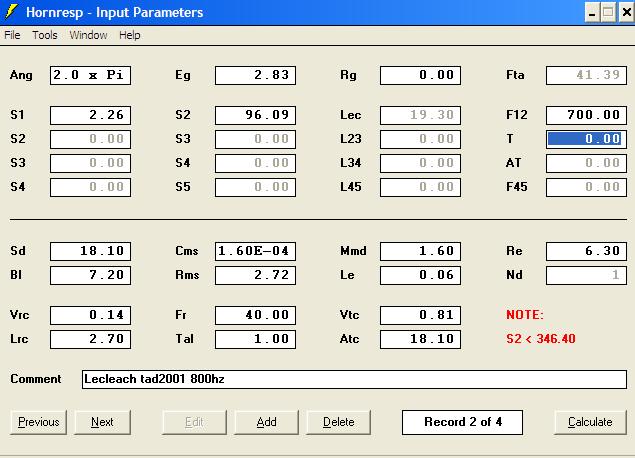

GM and JMMLC,
I didn't expect that you both decided to help me in this thread. Truly appreciate it.
Indeed the help file is a bit "advanced" to someone new at this like me.
No matter what I do, I couldn't change the L12 parameter to Lec (I have to type in letter L before hitting calculation correct?).
This is what I've got using the TAD2001 compression driver specs from the page Jean-Michel Le Cléac'h linked to. The lower cut off is 700hz, upper cut off 20khz.
How come it's showing hyperbolic-exponential flare?

Finally, I'm getting Lec.
I had to go into edit first (with all the input parameters for the compression driver inserted), then hit the 3rd box on the 2nd row (3rd from left). Either by double clicking or hit the L key, Le Cle'ach' horn function comes up.
So what's the next step?
Do I go to Tools>system design>from specs? and hit calculate?
does this picture look right at all?
since I don't have all the specs from the B&C 1" compression drivers in details as the tad2001 JMMLC provided, can I just use the schematic from the tad2001 to make the horns anyway?
