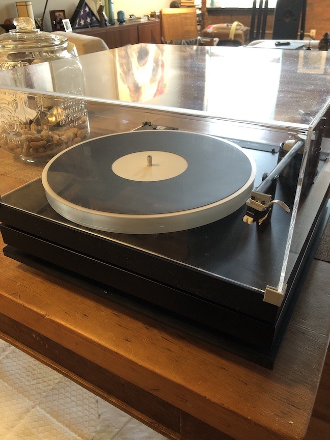

Here's a pic of my Neat-made Shield MO-19 idler with the 12" arm.

Here's the Simplex table with another self-made arm.

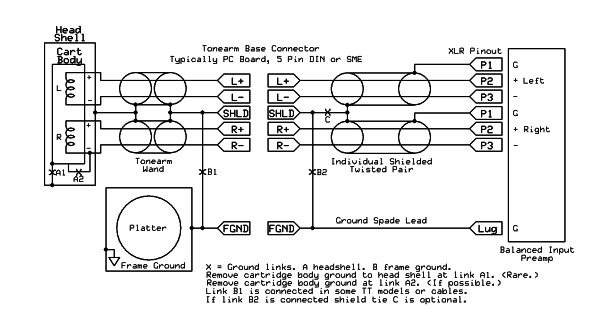

The diagram from the link below shows where to open the ground points (each point marked with X) to provide an osolated ground path for the audio signal, effectively converting the cart to balanced. The arm then also has a single path. It might be worthwhile.

I have no tonearms that have a DIN or multi-pin connections. My arms terminated to an external PIB box with unbalanced jacks and a ground terminal. Blew my mind testing continuity with the multi meter. I'll try adding a hole and screw on either carbon arm tube and connect to a phono stage ground terminal. I have Litz wire coming at some point soon with which to play.
