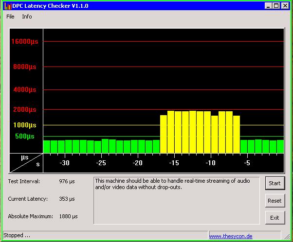

I think you may have hit the cause in your earlier post. Latency issues/problems. I tried this freeware program:
http://www.thesycon.de/eng/free_download.shtml
It's called DPC latency checker (you may know a better one). I found something on my laptop that grabbed the system every minute or so (I suspect the infra red port).
I created a new hardware profile with the following turned off:
1) on-board sound chip
2) ethernet port
3) wireless port
4) I-R port
5) parallel port
6) serial port
I think this may help ravslanka, it cleared up two things on my laptop:
1) Occasional measurements that didn't make sense (obviously incorrect imp & SPL measurements taken when the offending device grabbed the system)
2) Before turning everything off with the second hardware profile, even when I got seemingly good results, the impedance would either drop on the high end, or not rise as high as it should have. Not as much as your impedance plot rav, but in the same way.
The attached pic is the obvious latency problem showing on my laptop. It took 1 to 2 minutes for it to show.
Just another thought (follow soongsc's & John's recommendations first)
Jay
