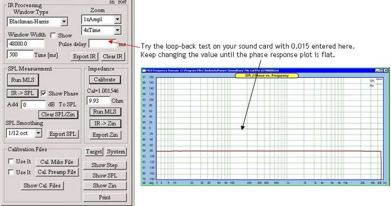

The SPL result does show a latency problem. I would suggest that you try a 0.015 SEC pulse delay. Fine tune it so that the phase in the SPL loop test is flat. I did some tests and latency does effect both magnitude and phase of a Z measurement. However, it effects only phase in the SPL measurement. Soongc was correct on this.

I don't think soongsc means you need a multi test level jig like his, just that a jig of some sort is highly recommended (I agree).
What John and soongsc have both recommended is that you adjust the pulse delay setting in the MLS window until the phase response in your sound card loop-back test is flat. Like John said, start with 0.015 and increase or decrease the value until the phase response is flat.

That pretty much says you are good to go. Nit picking, it looks like your sound card has some chanel to channel high frequency variation, but I wouldn't be too worried about it. It doesn't look like this would be the cause of the wiggles in the driver Z at high frequency you see. I would say at this point they are something associated with the driver.

Additionally, to repeat myself again:
soongsc said:
Please do that following and post the results of loop back.
1. check "Show Phase"
2. set window to "rectangular"
3. set smoothing to "none"
If I don't see the results of the setup I recommended, there is no way I can help diagnose the problem.

Optimizing the pc does not effect the interchannel latency as far as I have experienced. But if data are not consistent and the impulse location is not at 0, the optimizing the pc for audio is the first thing I look into.
"Setting the interchannel latency" section is where I put an example on determining the delay increment. If this works, then good, if not, then I will investigate to see what the problem is.
