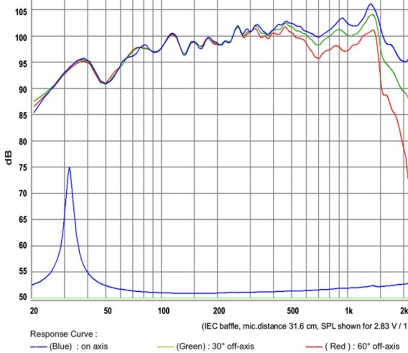

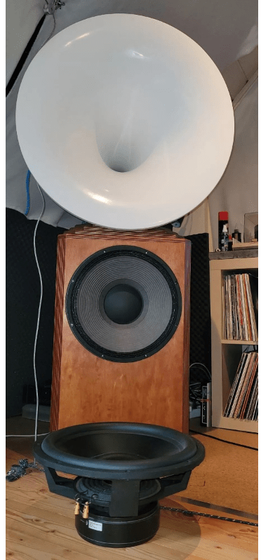

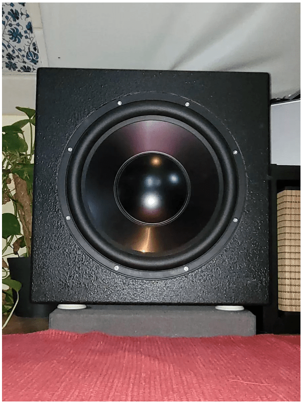

here the screenshots from the post coming from a german forum
here the audio enthusiast replaced the Dayton that sounded bad in the deep mid and kick bass frequency area with a decent drive unit, a specialist for the kickbass that fits better to the large horn
you can't get the xmax = 27 mm from the RSS390HE-22 and the fabulous Qms > 20 and Rms < 2 kg / s of the Beyma 15LX60V2 in one drive unit, here you need to take for the subwoofer a different drive unit than for the kick bass
he moved the subwoofer to a small GHP enclosure with a really powerful subwoofer plate amp
with the chance to place the subwoofer in a different place he could get rid of the massive room modes problem in his very peculiar room situation
so far - so good, Stefano
P.S.: if you are happy with a cut off frequency about 40 - 45 Hz you may stay happy with two way and a larger onken bass enclosure or you need a subwoofer to go down to a cut off about 30 Hz (if your room can make it) - for 30 Hz with really high SPL you need 4 - 6 15 inch subs and not only one or two

Well, in my 30m2 room 2 150l Boxes would be already a Lot. 4-6 subwoofers would make me sit without girlfriend:-(P.S.: if you are happy with a cut off frequency about 40 - 45 Hz you may stay happy with two way and a larger onken bass enclosure or you need a subwoofer to go down to a cut off about 30 Hz (if your room can make it) - for 30 Hz with really high SPL you need 4 - 6 15 inch subs and not only one or two
I also dont have room for huge subs, so I go for mall sealed box with Q between 0.5 and 0.7 with DSP / Eq and take advamtage of room gain ( corner location if possible) to achieve great results. The only requirement is that you need decent 200 watt to 400 watt power amps to drive them.Well, in my 30m2 room 2 150l Boxes would be already a Lot. 4-6 subwoofers would make me sit without girlfriend:-(
I have used a the Beyma subs, 12 LX60 and the 15LX60 and really like them... A pair (one in each corner) of 15 LX60 will reach way down low with accuracy and texture... Very nice. Mms 147g with 21.1 = 6.9 ratio. This is ok, but I would not class it as "fast"

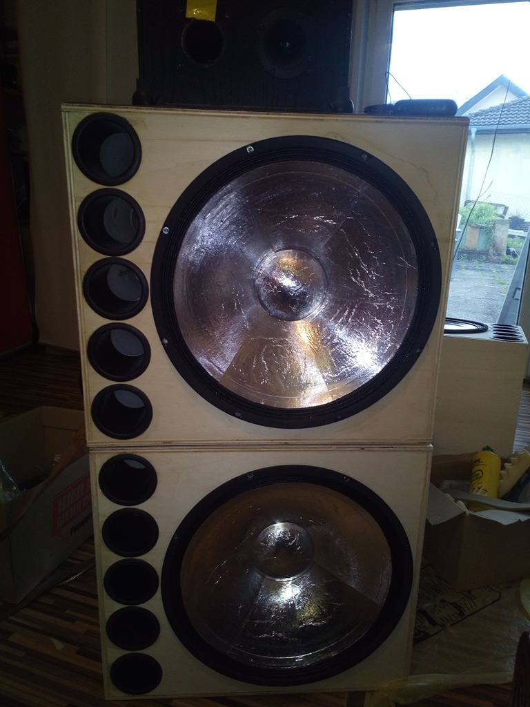

Please, while talking about paper cone drivers working up close to 1khz, think of making DIY the cone more stable.
Big drivers rarely have modern cone materials.
But with one sided aluminium foil or even two sided (sandwich cone) your big driver will sound completely different.
https://www.diyaudio.com/community/...loudspeaker-sandwich-cone.402917/post-7443474
Here a project I realized with 18inch drivers and do it yourself cone treated with alu foil.

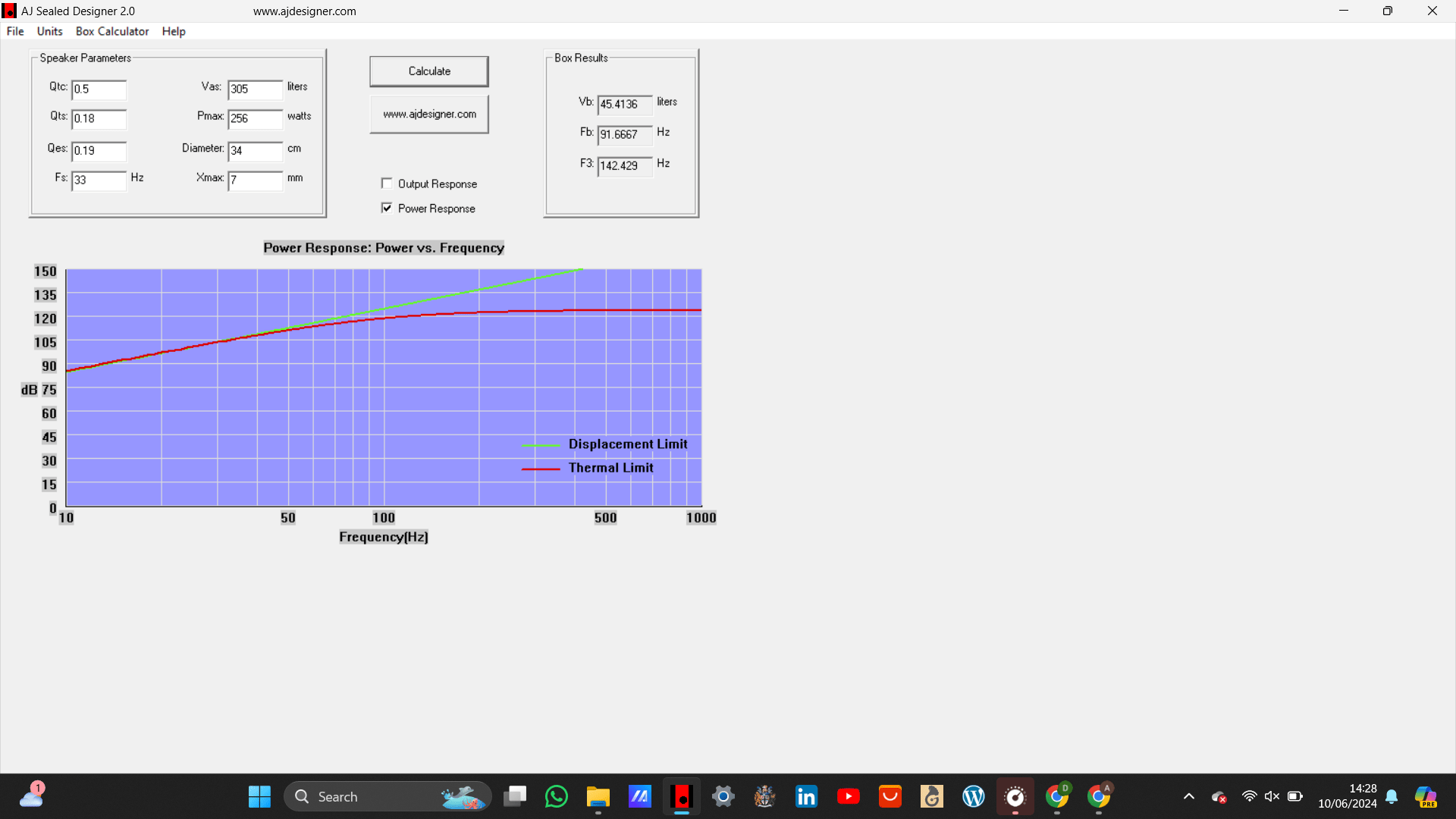

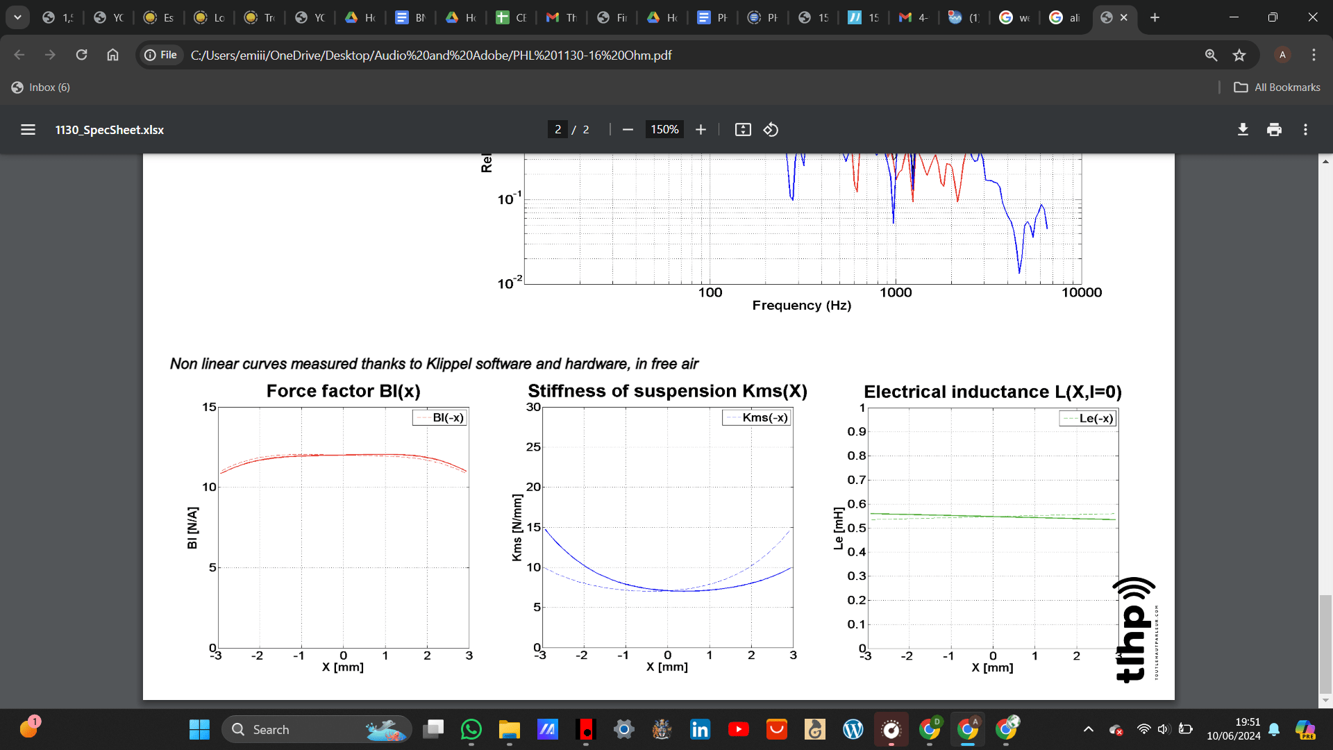

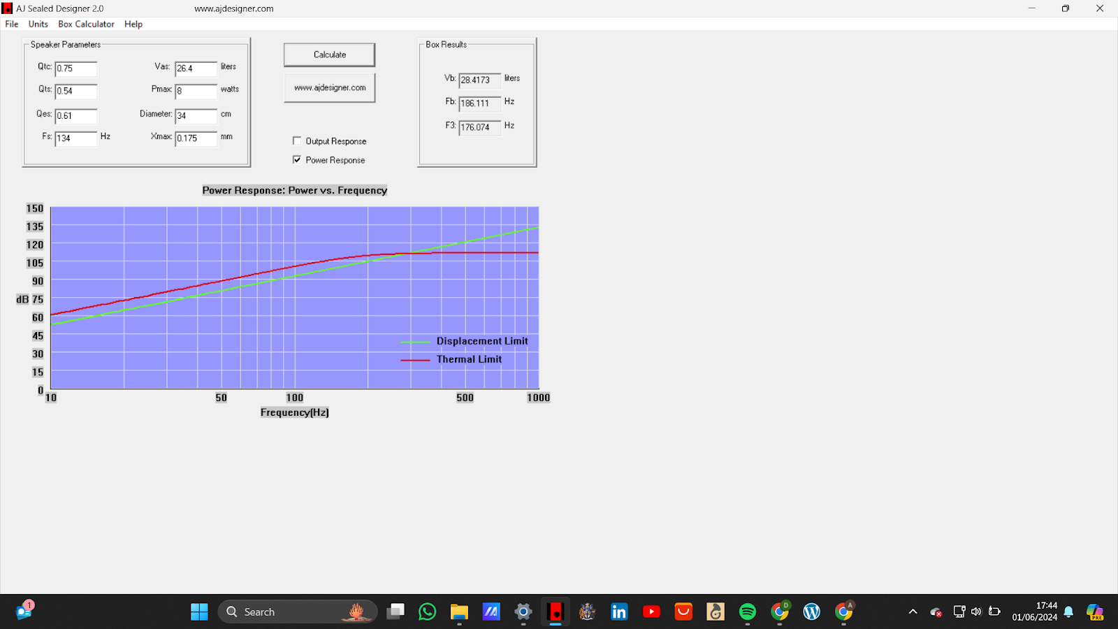

Another huge and important point... I dont want to derail this thread so please seek out my recent posts from abot 8 weeks ago I think... I have a "heated debate" with several of the DIY Guru's on this vital subject... I think I won the day!Yes, indeed impressive from the 15P80 Fe/N. But don't forget that all this derived from only the T/S datas, which are a low level parameters and once a driver starts to move significantly, the picture may change. Im wondering what could be the downside of such a high acceleration factor and low Qts other than the early bass roll-off (which otherwise can even be beneficial).
Long story short... The single biggest upgrade to loudspeaker designs is to "Prioritise Minimising" real world cone travel and keep it in the low level zone...
My favorite small midrange is a PHL 1130 with plus/minus 2 mm Xmax and 130 watts AES power handling... Nowhere near good enough!!
So I use 6 of them in an array and look at what happens... One cabinet (6 drivers) holds 111dB at 1 meter with just 8 watts...A pair os speakers holds 114 dB at 1 meter with 8 watts... BUT look at the cone travel 0.175 mm and thats at 300Hz crossover... In the critical 1KHz zone cone travel is a minuscule 0.02mm !!!
Look at the Klippel data... Plus / minus 0.5mm cone travel... The PHL array is not great... IT IS PERFECT!! It never deviates from full linearity by all three criteria.
Now The PHL is rare, but not unique (although 10g Mms with 12.7 Bl ratio of 0.0.87(!) is incredibly rare) and other drivers can be used... Even bass and mid bass.
Thats basically PERFECT! Zero time domain/thermal/non linear, IMD, THD or any distortion....
Six 6.5 inch cones Sd = one 15 inch cone Sd... All the slam with none of limitations of a 15 inch mid trying to cover 300Hz to 2KHz.
I have developed ways to combine "Prioritise Minimising" with other key techniques and I love the results.... YMMV.
