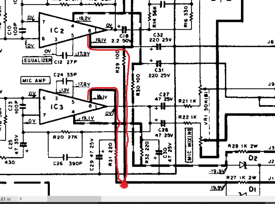

Mooly I checked for continuity from both pin 8 & 4 back to the resistors then thru to the Zener. I had continuity all the way there. I also took a reading from J-1 and j-3 that has both B+ and B- rescpectively they read 42.5 volts thanks again
J1 and J3 will be around -/+43 volts. That is the unregulated raw supply before it reaches the zeners.
It is the reading on IC3 where you mentioned above that you still had 46 and -53 volts on it.
I dont know whats going on at IC-3 as its still reads +46 at pin 8 and -53.
Mooly Yes, I still have the +46v on pin 8 and -53v on pin 4. I traced it all the way back and did some other traces as well for continuity. I had continuity across 2 of my capacitors took them both out of circuit and they were not shorted. I have noticed on where J-19 is there is distinct cut of the foil. I'm not sure if that was factory cut as there is no green protective coating over that cut. That makes me question whether it was done after the fact by some other repair tech in an attempt to find the problem. My schematic is not an orginal it was downloaded Via HIFI website. So I see a dotted line across there so not sure to be honest with you. I thought maybe no ground would give a floating voltages, but they're constant no fluctuation like you would see with a floating ground. Has me scratching my head for sure! Anyways thats where I'm at right now!
Lets concentrate on pin 8.
Look at the diagram attached. Pin 8 of IC 2 and pin 8 of IC 1 both return to the same point (via the resistors of course) and that point is the stable 19 volt supply rail.
You say you have +46 on pin 8 of IC3. At some point along the way that 46 volts has to suddenly change to the correct 19 volts you are measuring for the other IC's.
Where is that happening ? Something has to be open circuit.
Do you actually have 46 volts on one end of R31 and only 19 volts on the other ?
If so then switch off and check the resistor out of circuit to see it measures correctly. If the resistor is open then its almost a certainty that there is an issue with IC3 and it has zapped the feed resistors. If that has happened then the negative rail feed will be the same.

Mooly I checked R-31 it read 47v going into and 49V going out?? I also check R-32 and it had -55v in -53v out.
Tracing the voltage across from the J-1 & J-2 I had no varition a solid 42.5V +/- respectively, once they go across to D-1 & D-2 the voltage had jumped up to +48 and -55 the voltage drops only after it leaves R-29 and R-30 to IC 1 & IC-2. Shouldn't it of been rectified after the D-1 R-27 & D-2 R-28 or am I reading this schematic wrong? If that is the case then R-31 and R-32 should of rectified the voltage to the right voltage and then did not. However I pulled them out of circuit and they test correct on their Resistance!

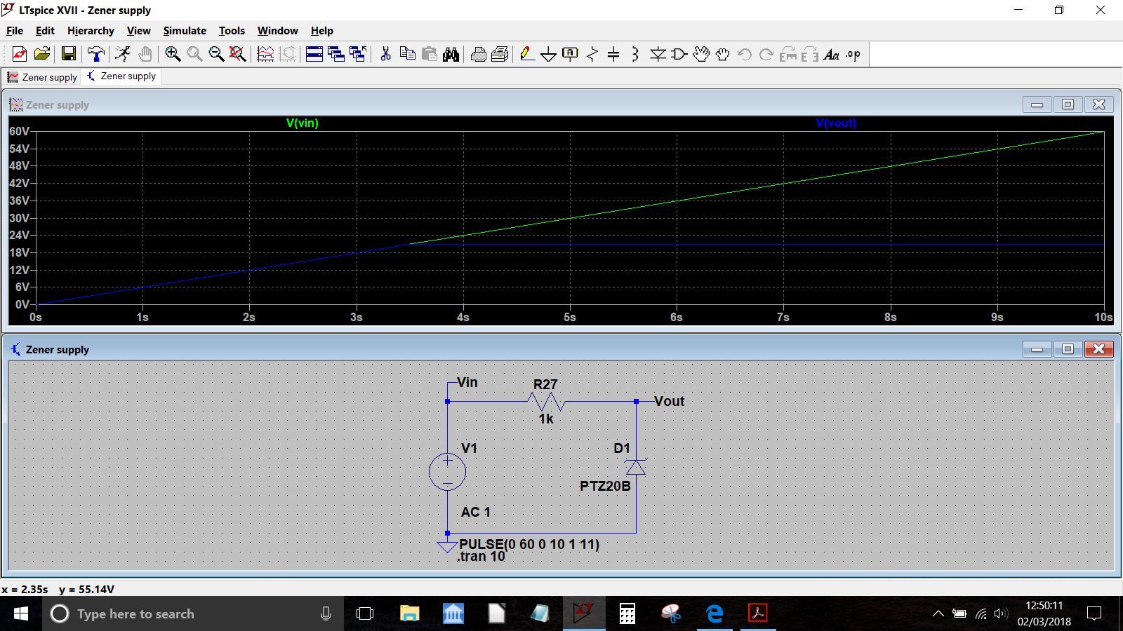

R27 and D1 form a classic zener diode shunt stabilizer. Raw (that means unregulated, noisy and variable) DC voltage is applied to R27. The diode connects via R27 to ground and clamps the voltage to 19 volts which will be the value of the zener.
The negative rail functions identically.
If you are seeing higher than 19 volt at either of the zener diodes then either the zener is faulty or you have inadvertently introduced a 'short' to somewhere else, or you have created a wiring error somewhere.
If you can measure higher than 19 volts across the either diode then that diode is open circuit/faulty.
This shows how it works. Vin is an unregulated supply rising in this case to 60 volts. The output voltage (Vout) is regulated to the zener diode voltage once sufficient input voltage is present.
Your unexpected high voltage readings must be coming from something else feeding into that board (a man made fault) or you are having problems making the measurements correctly.
All the rectification is done elsewhere in the power supply.
