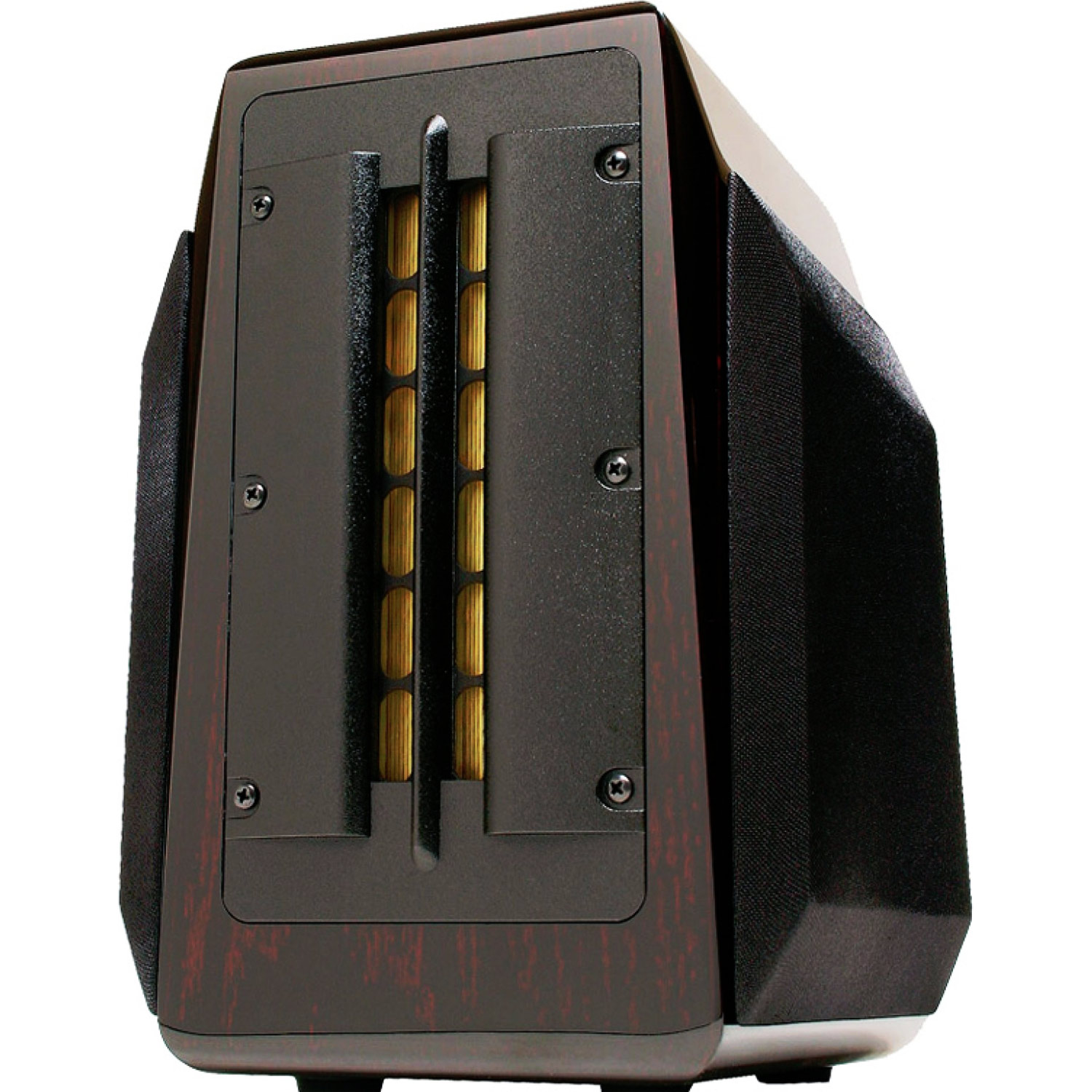

Was trying to remove the back cap of the tweeters but there was some insulation and i didnt want to ruin it.
That's fine, if you like the sound *well-enough then there really isn't any need to try it dipole (..plus, there are a host of issues when you do that related to pressure loss from the dipole **cancellation.) Something you can also try-out with the Edge when checking the "dipole" box. (..and if you don't use it with any baffle, you'd just make the baffle the same size as the driver and place that driver on top of that out-line making sure it's actually on it and not "grey'ed out").
**that's something automatically accounted for with the Great Heil: it's specifically measured without any baffle and designed to be without any baffle (unlike the Beyma).
*for a subjective opinion on this here is Danny from GR Research:
Selecting Tweeters and Why it Matters! - YouTube
