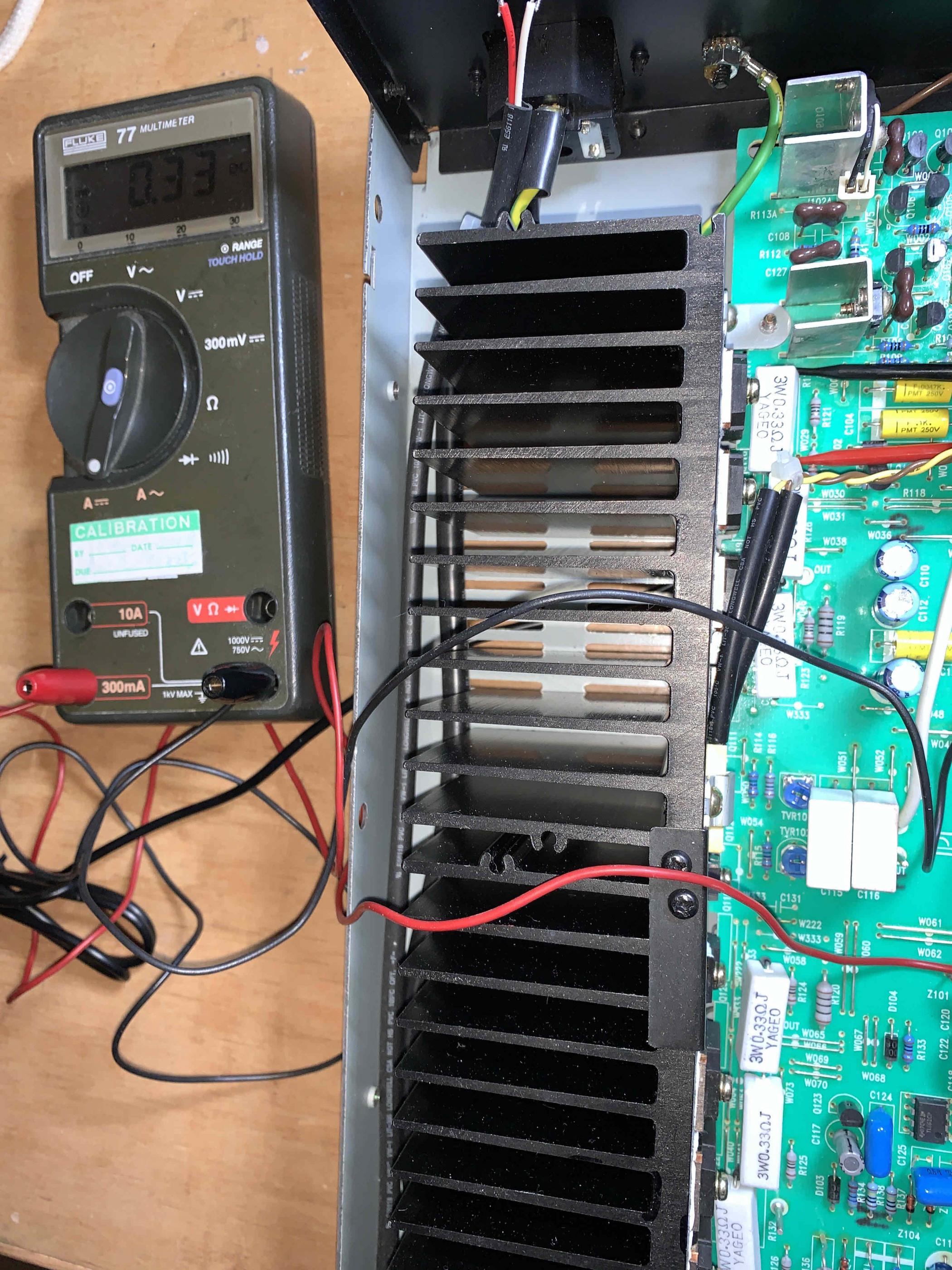

Maybe I can get some help with setting up my DMM correctly. I’ve measure across both R127 and R227 with my multimeter set to measure current in DC. Both emitter resistors measure about this same way: 0.30 when first powered on and after a few minutes are up to around 0.70 before I power off.
Something seems amiss. Here is a pic of my DMM and on the right is seen the clamps on the legs of R227.
Am I setting something up incorrectly? Are my DMM setting incorrect?

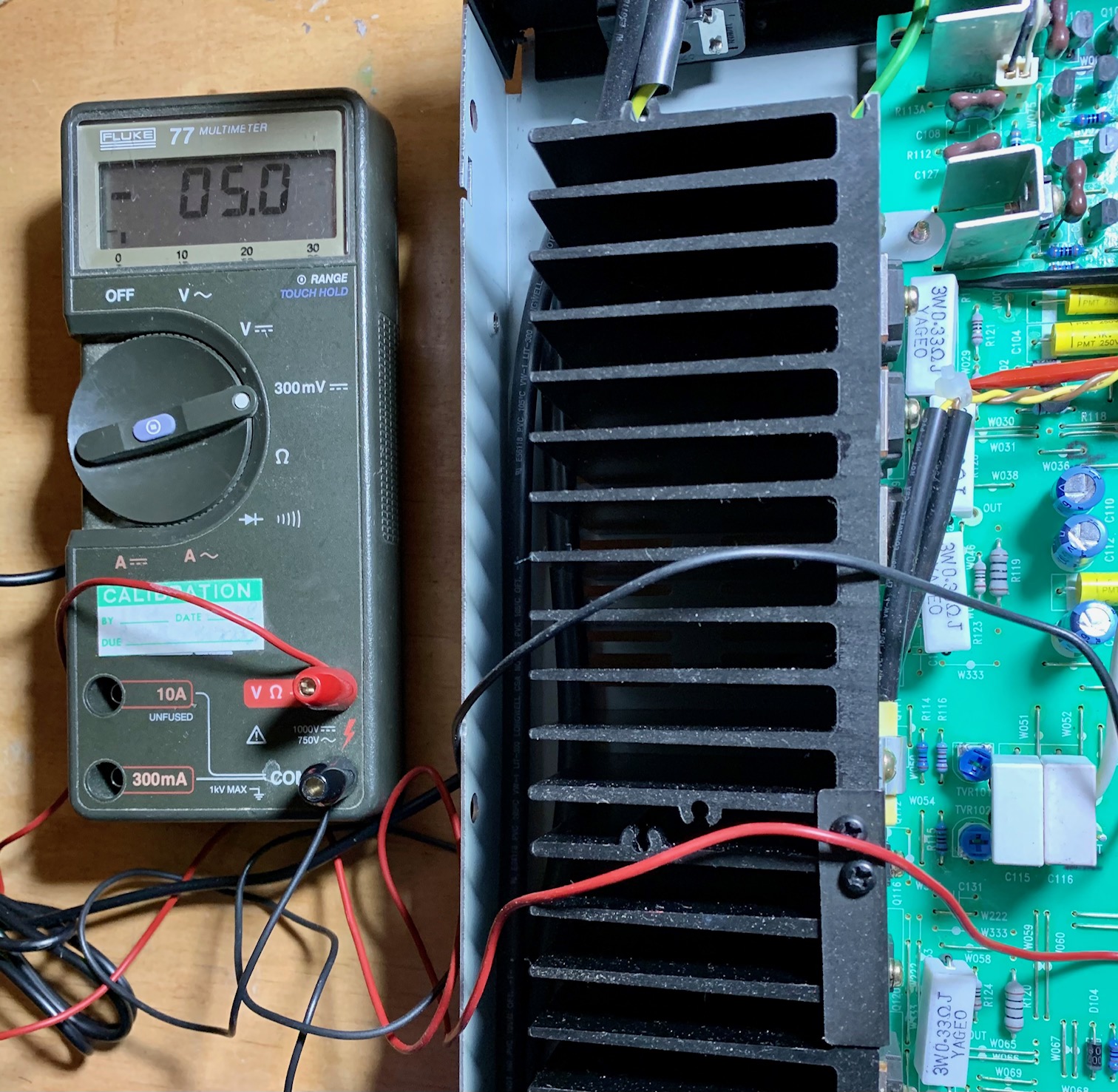

However when I change the DMM to “300mV” setting and move the input to the V/ohm/diode input the reading is around -05.0. Not sure what that means however:

I have several older Parasound amps. The ones like yours with the internal heatsinks run very hot. I would set the bias at 7 mV, which is optimal based on my own distortion measurments. You need to let the amp settle in every time you make an adjustment for a stable reading. Always keep an eye on heat sink temp and output offset voltage (shouldn't be more than a few millivolts if the DC servo is working correctly). If you have more offset, you must check all output devices first, otherwise the amp won't work properly and may fail shortly.
It looks like some repaired that amp based on the off brand .33 ohm emitter resistor I see. If the amp suffered from shorted output transistors, you will want to replace the whole channel's worth as a beta matched set along with all the emitter resistors.
The bias adjustment is very touchy on these amps. Very small nudges of the bias pot make big differences. Also be aware that pots in both channels don't rotate in the same direction to increase or decrease bias.

When you place the DMM in the diode setting and measure voltage drop across the emitter resistor, you're forcing the amp to absorbe the test voltage applied by the DMM. Thats not a good idea. Only measure im the 300mV DC voltage range.

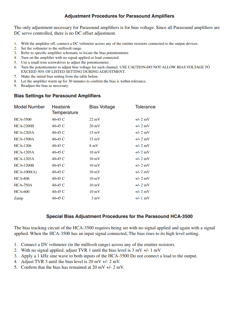

I'll be the first to admit that I am a bit of a noob here, however I found some resources and find myself more comfortable. I contacted Parasound and they were quick to help with the last few questions I had.
Looking back I think the 5.0mV measurement had be a bit confused as the factory setting is 10mV with a +/-2mV tolerance which meant the 5.0mV reading was much more out of spec then I'd expected.
The pots are super touchy, good advice and I've been careful to make small adjustments. I've read that John Curl has recommended an optimal setting of 17-20mV for this amp. I've added a couple of quiet small fans as that seems pretty high to me. With the amp running for 6 hours at 17mV the heatsinks are sitting around 40C. I think for now I'll leave it at 17mV and temper that if things seem to get too toasty!
