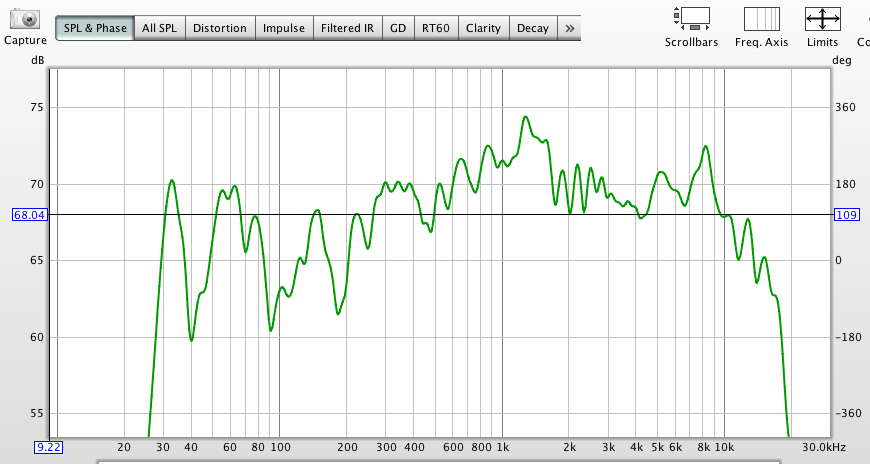

I have been having some issues designing a work-around for a diffraction peak in a 2-way loudspeaker (Jordon JX92S, Vifa XT19).
The modelled response of the Jordan in-box is using Jeff Bagby's diffraction simulator.
The measured responses on-axis, 15-degrees, 30-degrees and 45-degrees off-axis at 1m are as follows:

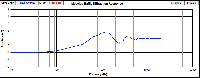

![W_DIFF.png W_DIFF.png](https://www.diyaudio.com/community/data/attachments/793/793426-abead0adfeba6fe79cbda8fcd6a0b2de.jpg)

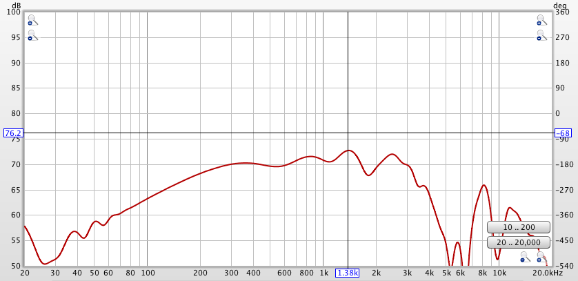

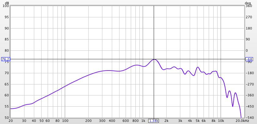

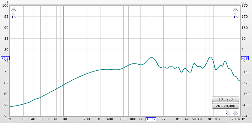

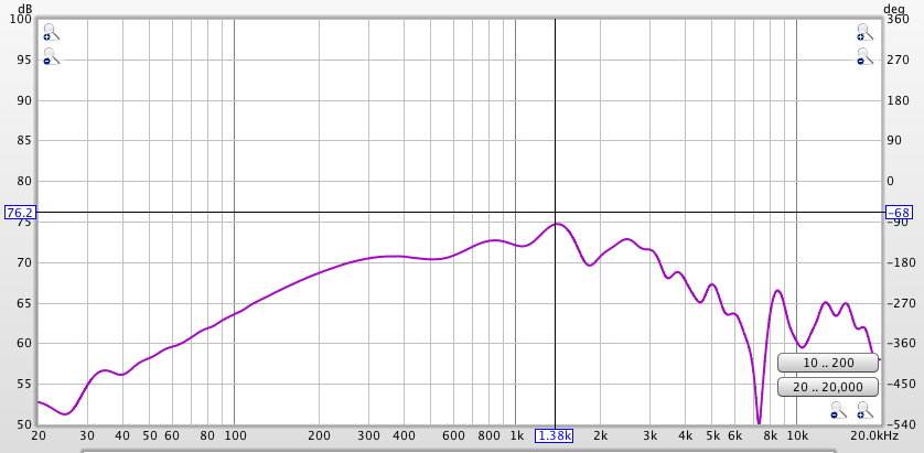

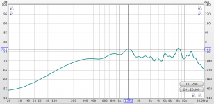

![on-axis.png on-axis.png](https://www.diyaudio.com/community/data/attachments/793/793443-502c87051c4a898e0f8c66110e472353.jpg)
![15deg.png 15deg.png](https://www.diyaudio.com/community/data/attachments/793/793458-7a3ded16583c980b0d9c5b71f1ae8b43.jpg)
![30deg.png 30deg.png](https://www.diyaudio.com/community/data/attachments/793/793467-7f3eedec4df3807d83dd4a4468a7cde6.jpg)
![45deg.png 45deg.png](https://www.diyaudio.com/community/data/attachments/793/793477-f699a383dc574228ca6efcc727415e01.jpg)
These are measured using the UMIK-1 measurement microphone and analysed usine REW, using a Tukey 0.25 time-window of 2.2ms, which eliminates the floor-bounce and longer reflections.
I'm not concerned about the low frequency rolloff which is a combination of the baffle-step and the time-window and can be easily compensated with a low-frequeny shelf.
However, as you can see there is peak around 1.4kHz of about 3.5dB, corresponding more or less to the model. As the peak is in the model as well as the on- and off-axis responses, I think the peak is real, rather than a measurement artefact.

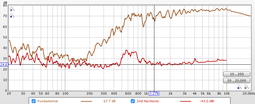

I'm planning on crossing over at around 2kHz. I can't go too much lower due to 2nd-harmonic distortion from the tweeter at around 650Hz.
![TW_THD.png TW_THD.png](https://www.diyaudio.com/community/data/attachments/793/793496-11f808cfc2218213ef0fe0fc23a63357.jpg)

Thanks, Chris, for the response!
So you would ignore the diffraction peak in the crossover design, then EQ it out in the wideband response (input section) using the parametric EQ?
With the MiniDSP, this is well within the realms of EQ. The only way to get rid of it acoustically would be to mount the speakers in the walls.
Chris
If you're crossing active, at least for your first attempt, I would follow the tried and true method of:
1. EQ both drivers flat to 1 octave below/above XO point - you're on the right track with a notch for the diffraction peak. Use your judgement how big and wide the notch should be, taking into consideration both on and off axis magnitude of the peak.
2. Ensure drivers are level-matched as closely as possible
3. accurately measure acoustic offset/delay and and compensate for it in your XO
4. Apply textbook 4th order LR
5. Measure drivers in-phase/out of phase to confirm offset has been calculated correctly
6. Apply global EQ for BSC, and possibly room EQ below shcroeder frequency
7. experiment with different slopes and eq to fine tune
There's likely better methods of doing this but this will can you something very serviceable in a few hours work.

I always find eqing drivers bang flat with my minidsp and performing the polar measurements again. That way you know exactly how the cabinet will effect the FR.
Any eq applied to reduce diffraction peaks will show as boosts in off axis measurements so sometime a gentle touch can help.

@TS How do you explain that this is a diffraction peak? These normally don't show up in on-axis and off-axis measurements. Or this artefact is due to the vertical dimensions of the baffle, but you didn't include the vertical polar measurements. You should explore this somewhat further, I think.

AntM this doesn't look like a diffraction peak, it looks like a resonance. I would try equalising it.

Dug up some old measurements courtesy Martin King. It seems to me the Jordan itself is guilty of the rather rough ride around 1-3kHz.
I suggest making some burst decay plots. Measure at close range, say 2" max. See if there are resonances. If so, get the speaker out and repeat measurement in a baffle. If the resonances persist, you just have to accept them. If not, improve cabinet damping. Either way, you probably want to EQ the result.

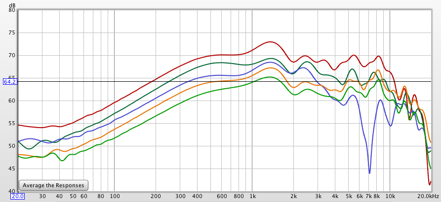

Hi all, thanks for your comments!
MarkBakk, Grahamgraham, here are a few more details:
1m on-axis, 45 degrees below and 45 degrees above (approx)
all with 1.3ms time windowing
The last two plots are on-axis, with the speaker in a different room position
Also below, on-axis without any time-windowing.
![1.png 1.png](https://www.diyaudio.com/community/data/attachments/777/777455-b95a7cda5538692d4897127c37a6f776.jpg)
![4.png 4.png](https://www.diyaudio.com/community/data/attachments/777/777511-8acee072158549abedc5a5f7cd055a4c.jpg)
