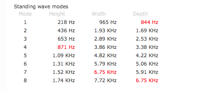

The dimensions and corresponding fundamental standing wave frequencies are:
7" - 960Hz
8" - 846Hz
31" - 218Hz
(the box dimension corresponds to half a wavelength)
This site has a handy calculator: standing waves
This not only highlights the 1.3kHz resonance, but also the resonance observed from the port around 1kHz.

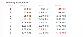

7" - 960Hz
8" - 846Hz
31" - 218Hz

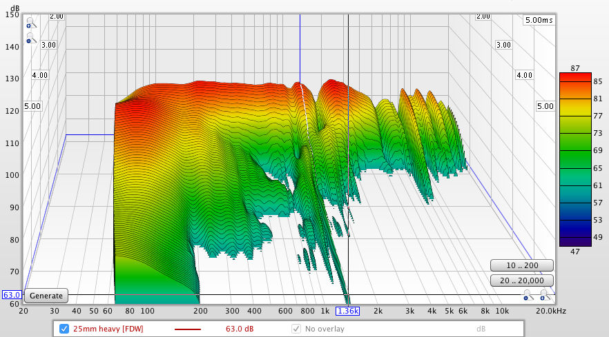

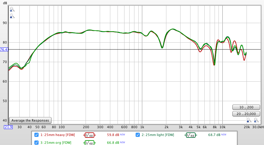

- with heavy stuffing in the top two compartments
I haven't weighed the damping material, but to give you an idea, the "light stuffing" required the wool to be teased out to fill the volume, and the "heavy stuffing" has twice the material and fills the volume without it being compressed nor teased-out.
all measured around 25mm from the cone centre.
Slightly surprising to find that the curves are almost identical. This seems to cast doubt standing waves being the issue, or at least insufficient damping being the issue.
Another curiosity is the dip at 1.8kHz of around 10dB which gradually disappears as the microphone is moved away from the centre of the cone.
I am wondering whether to try and download the Martin King Mathcad models and see if there is anything else at play. It seems too much of a coincidence that the resonant frequency hits a standing-wave frequency.
Another option might be to temporarily close-off the lower section and see if the resonance disappears.
Any thoughts very much welcome!

Oh, this is going quite another way I'm afraid. Can the driver itself be suspect here? Some bell-mode resonance or other issue?
I suggested earlier getting it out and measure on a wide baffle made from some scrap panel lying around. Just to eliminate things. Do check driver mounting for leaks and resonances.
Looking back at your measurements in post 32 it is surprising that the response gets almost flat at 150mm measuring distance. So the phenomenon disappears magically. Have you measured the system at more than 1m, preferably with adequate gating > 5ms? And have you saved the last measurements so that you can reproduce the CSD or BD plot?

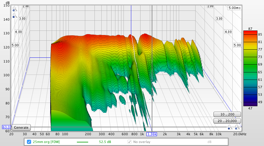

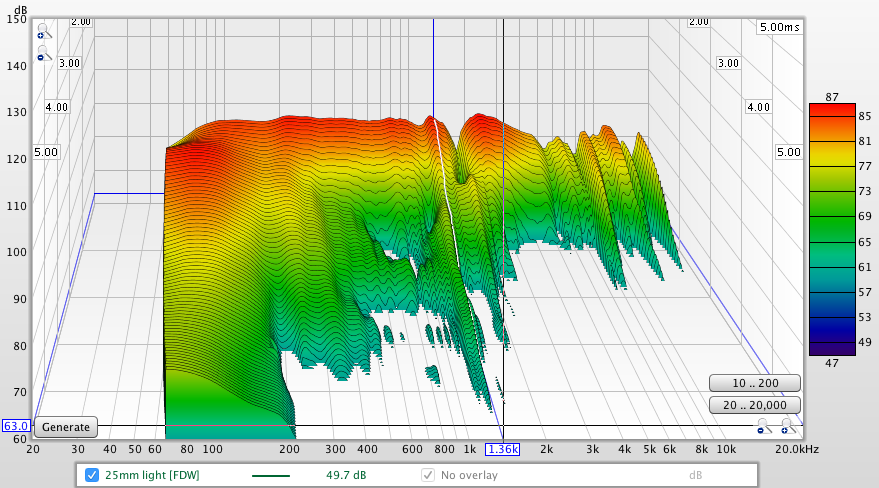

Here are the CSD plots - some subtle differences in resonances (actually the heavy damping seems to take longer to decay)
No stuffing (original)
Light stuffing

I think the resonance is still there at larger distances (see post 1).
What is interesting is the dip at 1.8kHz, which disappears away from the cone. This suggests a node at the cone centre at this frequency. Can a standing wave occur across the cone?
The cone diameter is about 95mm, which is half a wavelength at 1.8kHz. Another coincidence?

You are on the right track I think. Breaking up is defined as any transducer plane that is not moving like a piston. It happens with any driver and with paper and other 'soft' cone materials it is intended to within the passband. This applies to the Jordans too, as you found yourself. Other metal cones (and domes) are designed to break up outside the passband (given good filtering).
Your CSD plots indicate breakup modes from just above 1kHz. Once a cone starts doing this, it will continue doing so with raising frequency. And so you arrive at a fundamental question: do you like the sound of the Jordan? Then don't bother too much and equalize the sound pressure response by filtering (but stuff the enclosure enough!). If you think it should get better, revert to another driver or (the hard way) try to dampen the cone with the right coating.
