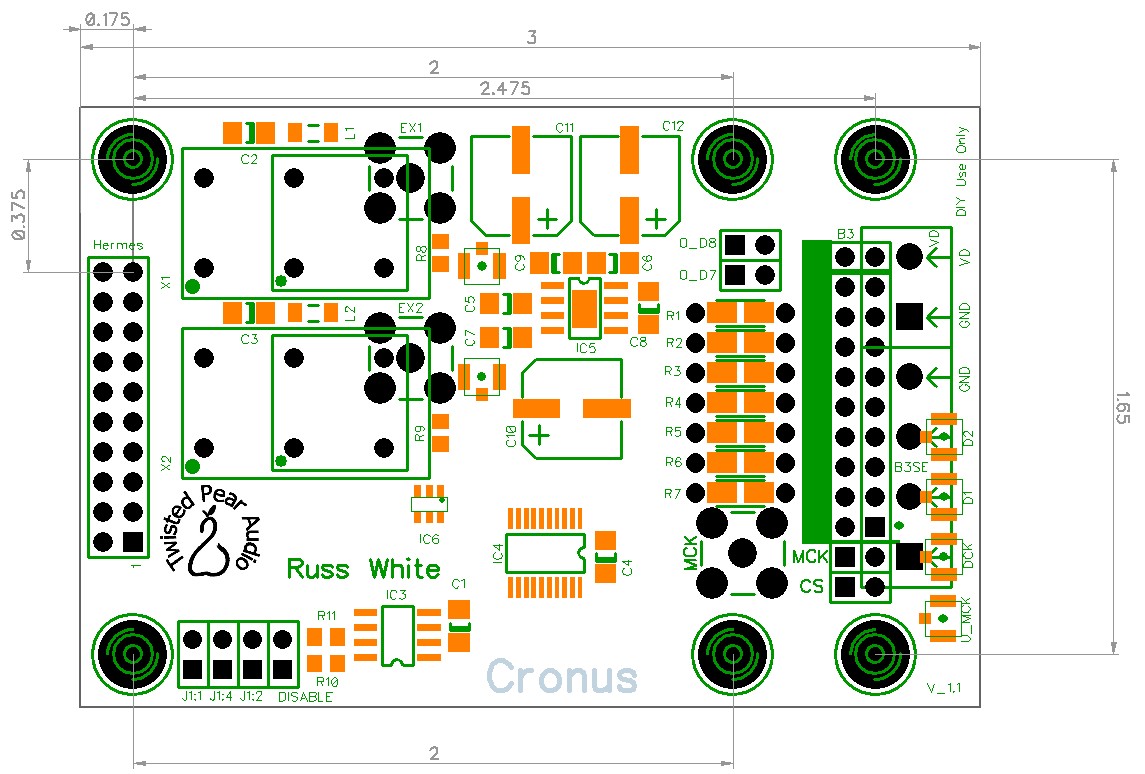

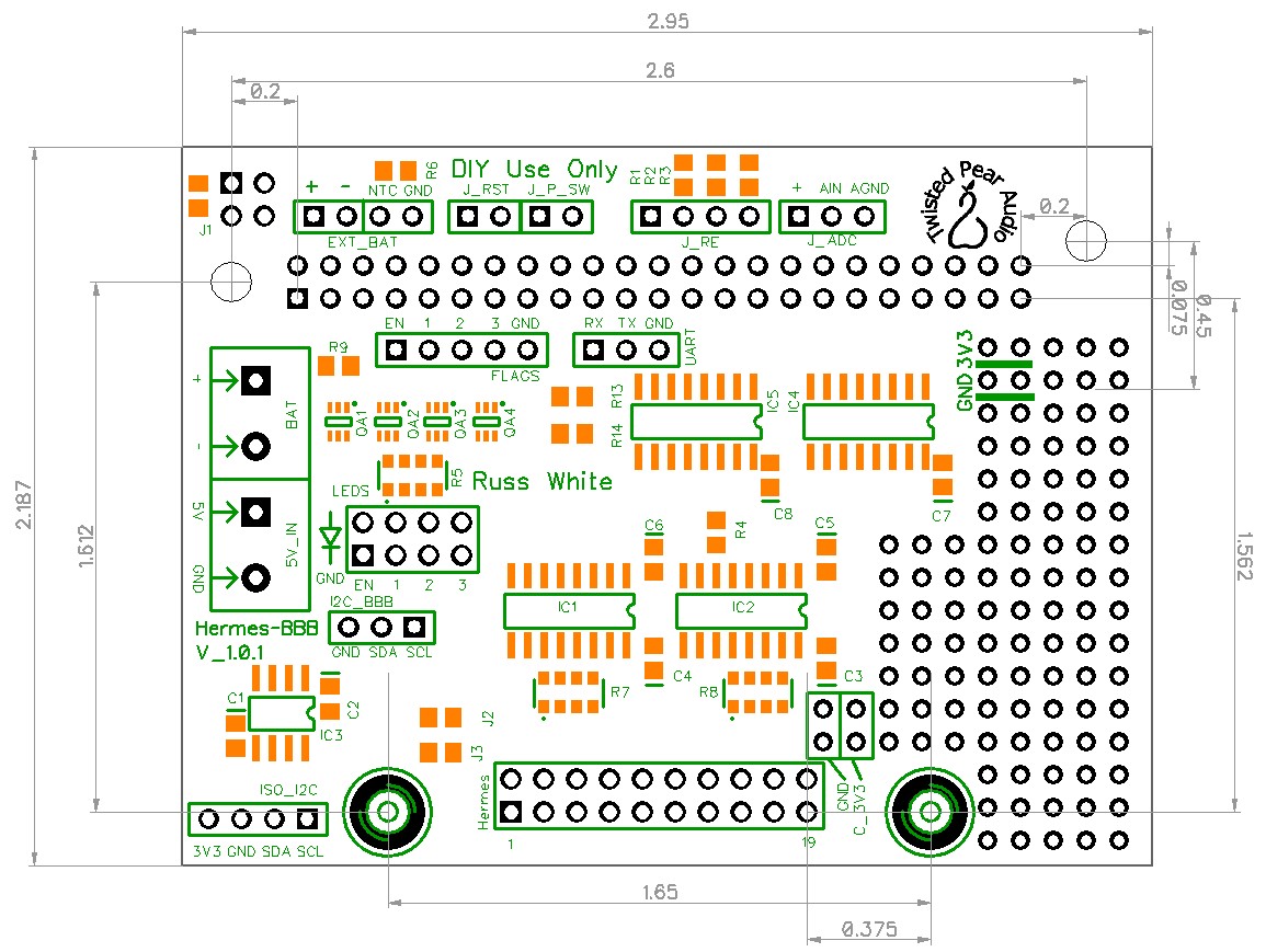

Does anybody have the exact measurements of the modules involved in a BeagleBorad-Black + BII or BIII + Cronus + Hermes-BBB build? It would suffice to know the outline dimensions of a ready build. Background is, I am designing a case, respectively trying to find one, that can also fit an amp-module.
I did not find any documents on the TwistedPear website regarding this.
Thanks a lot!
Thanks a lot!
Perfect! Greatly appreciated. Thanks a lot.Can help you with Hermes and Cronus, perhaps others can provide the rest?
I found layout to be challenging if one wants to directly port any of the BBB connectors outside the chassis. Teleporters solved the problem for me (photo here). Others have shown it is best to keep wifi dongles outside the BBB chassis. If the amp modules generate heat, remember that *good heat management* is desirable around the tridents, around any other shunt regulated supplies, and (in my experience, at least) for best performance of the Legato I/V boards.Background is, I am designing a case, respectively trying to find one, that can also fit an amp-module.

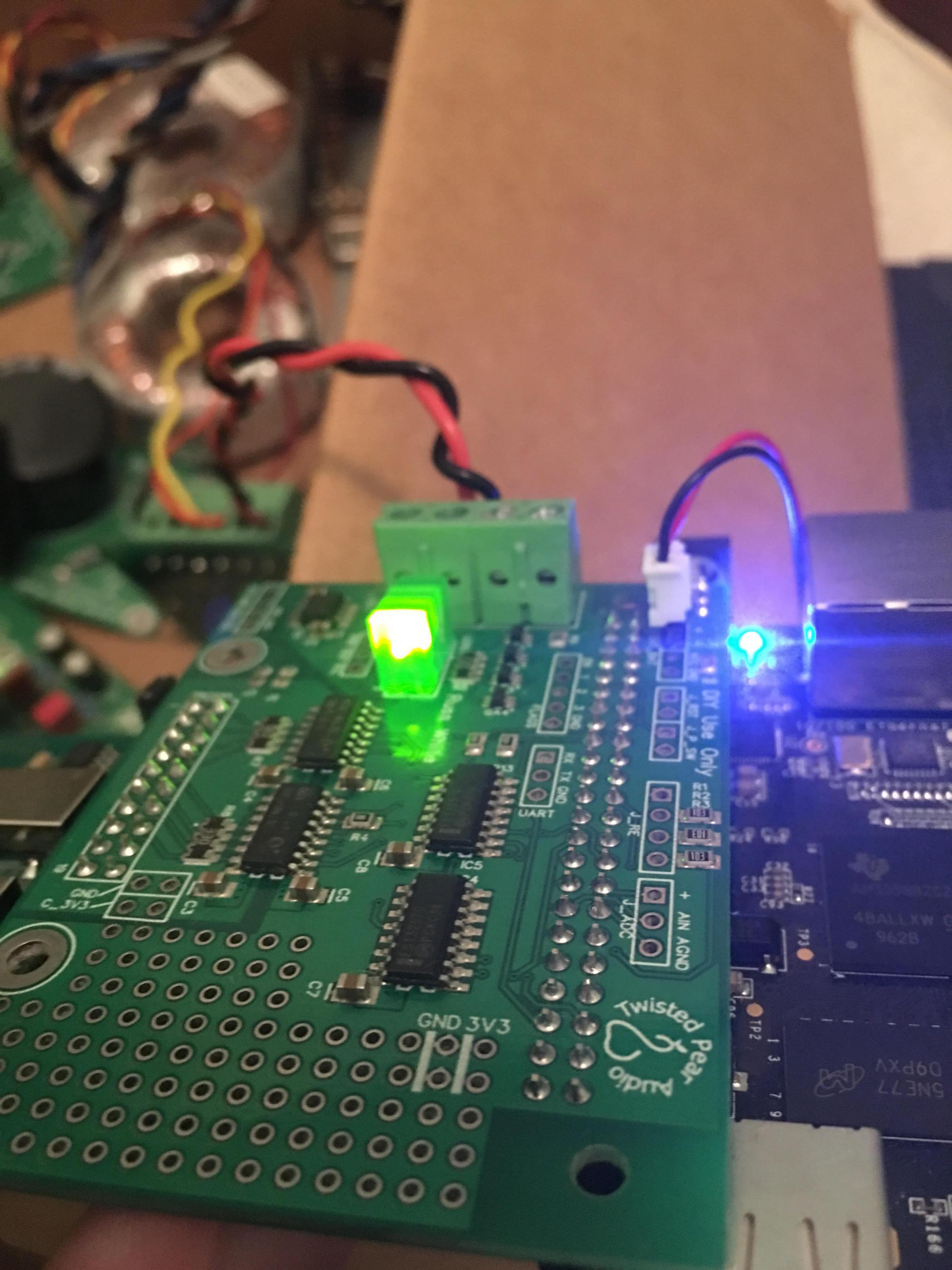

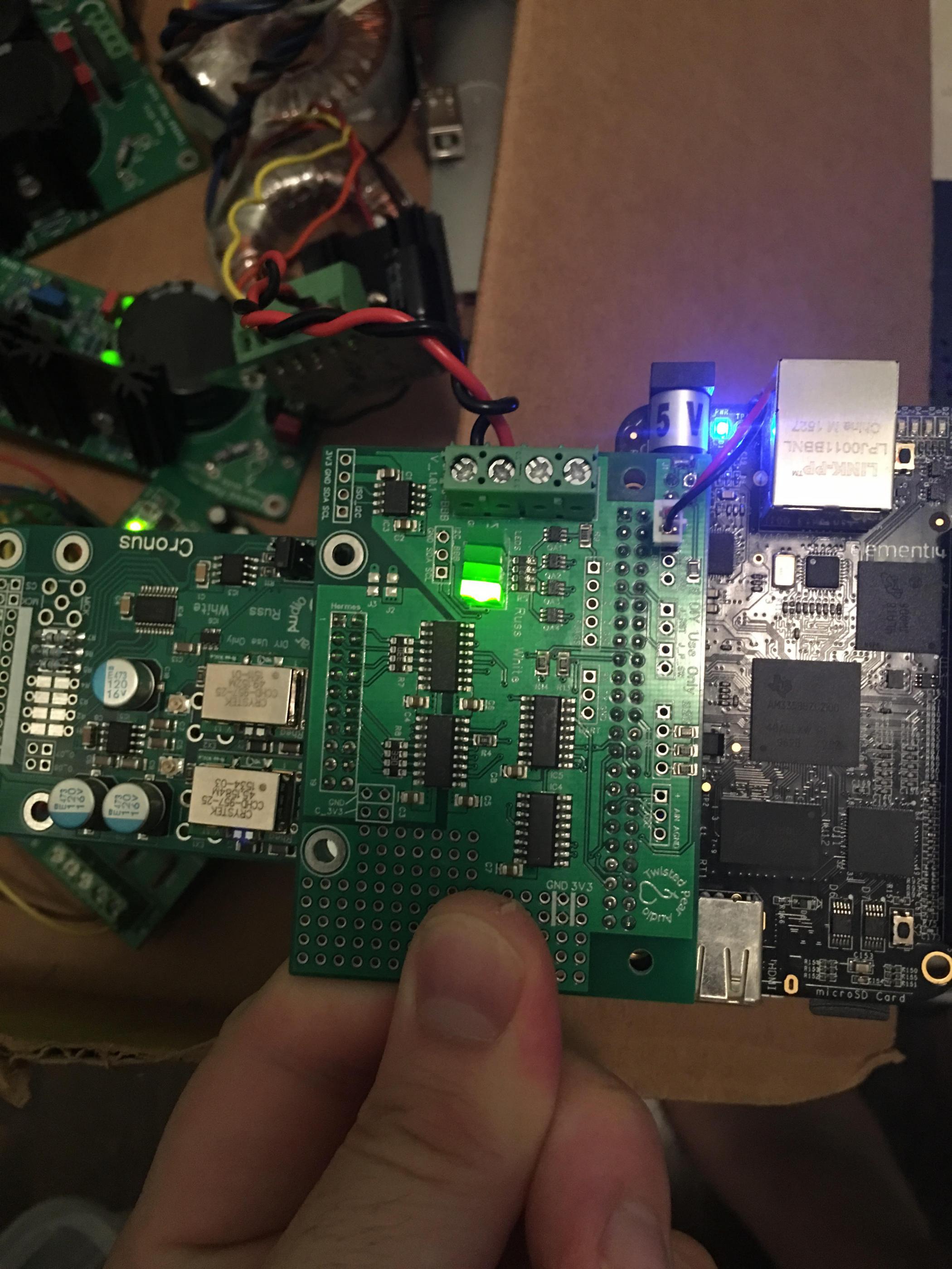

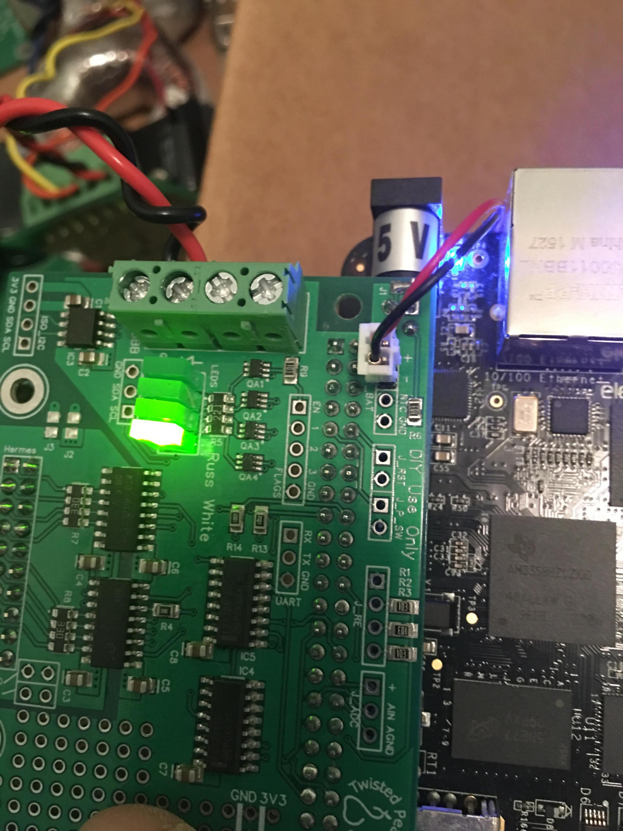

What do each of the four LEDs on the Hermes represent? Only the first LED is lighting up for me. NB: I've got a B3SE running controlled by an Arduino running modified Hifiduino code.
Anybody have any advice on how to debug? Reading through this thread again, it seems like the ENABLE light should be turning on if things are configured correctly - but the only thing lighting up for me is the LED labeled "3". I've got miero's botic4 image loaded and can ssh into the BBB. Happy to post some photos, if that would help.
Hi chryses, it appears that your problem may be related to soldering. You might want to check again your soldering work with the LED pins and those header pins to P9 of BBB soldered to the Hermes board. Careful retouching of soldered joints may correct hidden incomplete soldering.Anybody have any advice on how to debug? Reading through this thread again, it seems like the ENABLE light should be turning on if things are configured correctly - but the only thing lighting up for me is the LED labeled "3". I've got miero's botic4 image loaded and can ssh into the BBB. Happy to post some photos, if that would help.
Thanks twluke. I went back and retouched everything, scrubbed it all down with alcohol, but I'm still having the same issue. Some photos of the board below - anything look wrong to anyone? Any other troubleshooting ideas?
Do you get the same result when booting from usual 5V power supply via the terminal block of Hermes?
Sorry, I'm not sure I understand. In the pictures, I'm powering the Hermes via the terminal block (red and black wires). If I disconnect those and power the BBB up using its barrel connector (attached to a wall wart), I have the same issue. But I don't think that was what you were asking ...
Oh, I mistook the cables connected to the 5V supply as a part of extension from the battery power. Your connection is exactly set to what I asked. I'm sorry for making this confusion. So, I'm afraid to say that I can not offer further idea to help you for now.Sorry, I'm not sure I understand. In the pictures, I'm powering the Hermes via the terminal block (red and black wires). If I disconnect those and power the BBB up using its barrel connector (attached to a wall wart), I have the same issue. But I don't think that was what you were asking ...
