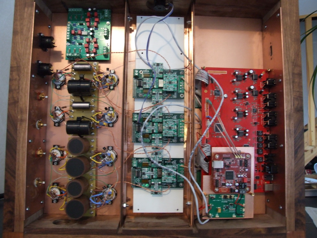

My dsp, you could probably tell from the picure what the dac's are (I'm keeping them by the way)

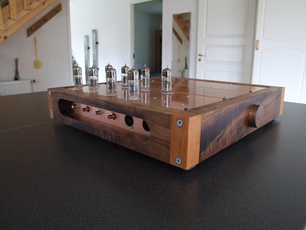

Nice work
Is that a solid copper or copper plated chassis ?

It's solid
