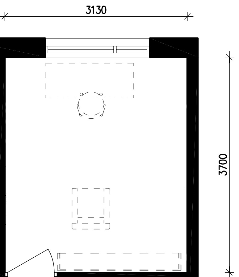

The picture attached shows room dimensions.

I've been going through the "Bookshelf Multi-Way Point-Source Horn" thread for the last hours and it seems quite feasible option. This horn is very interesting, I could also get a similar XT1464 horn and modify it OR I could make one out of BB ply on custom measures.
Here are the practical limitations of the project:
1) Speakers will sit in corners and will have a window and a table between them.
2) Room is only 3130x3700.
2) Good SQ should be obtained both in near-field (1m at very wide stereo) and far-field (2,5m at 30 degrees stereo).
3) It is possible to biamp speakers. It is possible to put PLLXO before amps and speaker level filters after them.
4) FIR correction is available, but it's just for the total system from a 2-channel output.
Single full-range without any assist isn't for me. I've tried it, but the distortion on bass level or poor response on quick bass really inhibits it's use as a all-around speaker.

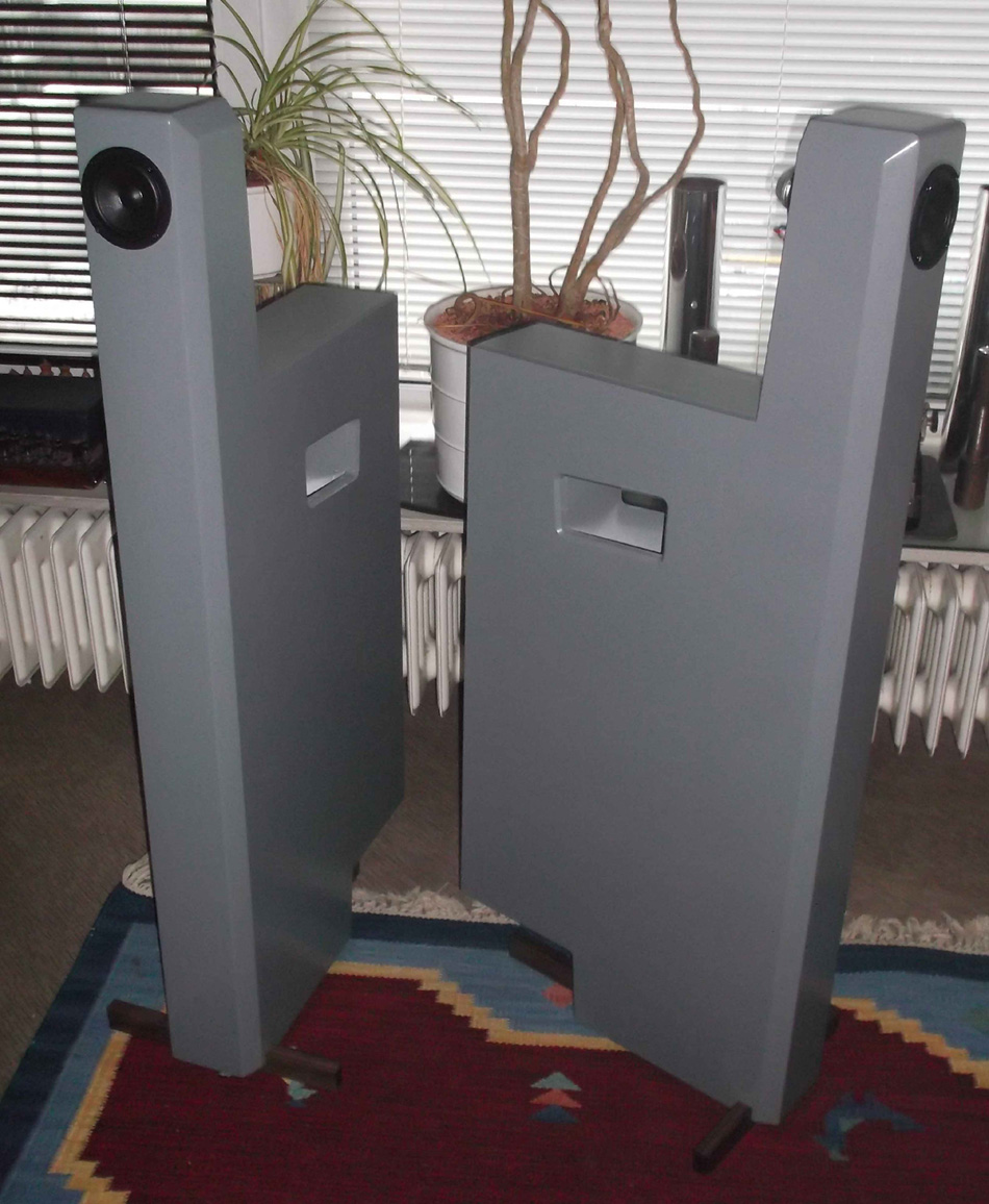

You can certainly go a long ways with a FAST. These are particularily good:
Alpair 12pWeN in a Woden ML-TL with A7.3eN as midTweeter. We started with A7PeN, but prefer the metal cone. You could use any number of midTweeters.
