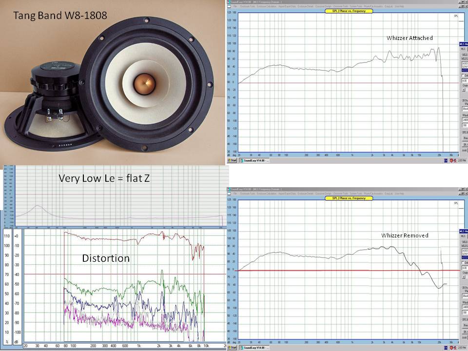

Great Vocals from 8" in our home: Sealed box Tang Band W8-1808 with whizzer cone removed + SB26STCN tweet @1.8Khz, plus equalized sealed woofer.

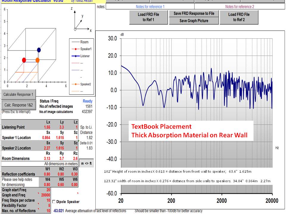

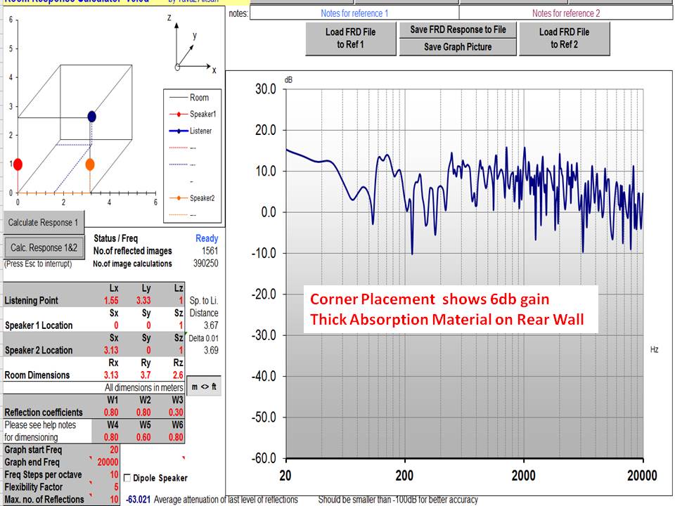

A quick computer model of speaker placements in your room would suggest that "space saving" corner placement is a good option for normal listening. Pulling the speakers into the room for critical listening does increase high frequency SPLs at the listener from additional wall reflections(ambience), and mainly requires bass equalization below 40Hz.
1) Thick absorption material on the rear wall is very important.
2) Carpet on the floor is important.
3) Some absorption material on the side walls is helpful. Few Key locations.
4) Corner placement shows ~6db gain.
5) Textbook placement increases high frequency SPL at listener from additional wall reflections.

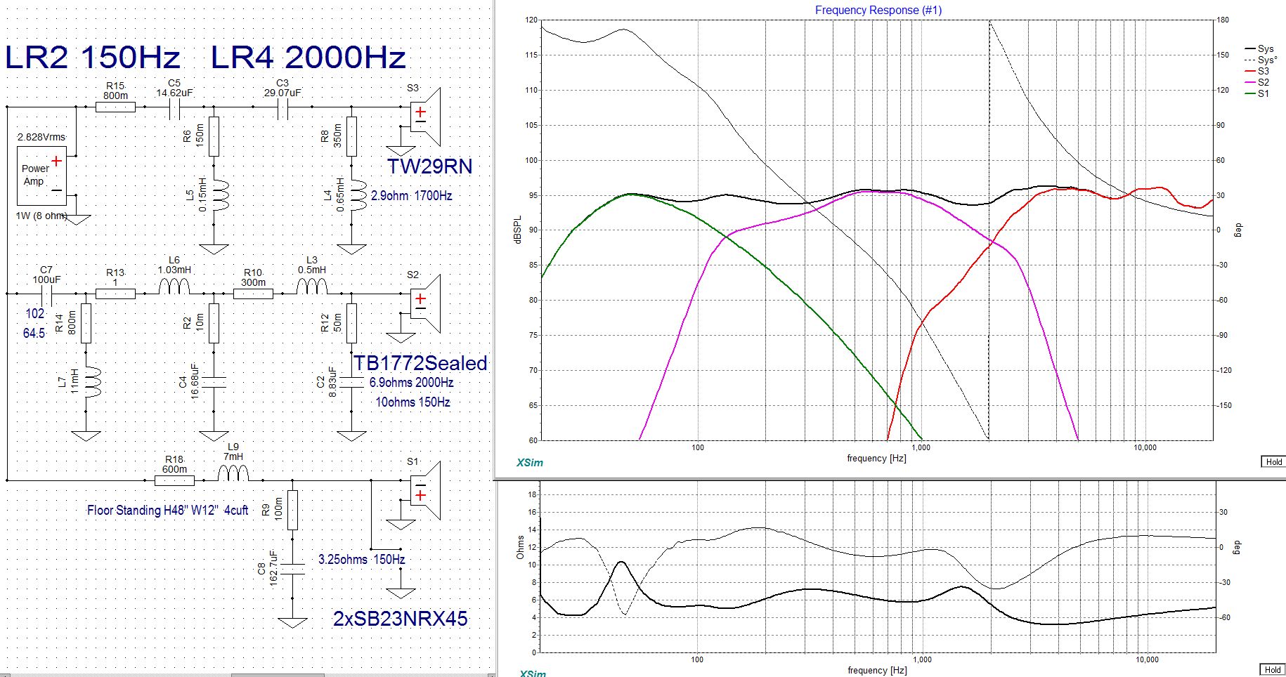

--smooth controlled directivity function--
An LR2 or LR4 crossover ~2kHz between no-whizzer Tang Band W8-1772 and the high'ish efficiency Satori TW29RN should have a smooth controlled directivity function - where the beaming of the W8-1772 is modest such that the 180-degree baffle dispersion still dominates. For a narrow baffle cabinet, two 8" woofers can be combined ~150Hz. With a Fat-Bottom cabinet, a 12" woofer could match the 95db/w W8-1772 efficiency.
--mixing-in high frequencies at the listeners--

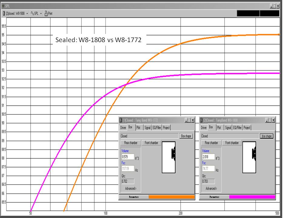

Running the no-whizzer Tang Band W8-1772 up to ~5kHz would create a narrowing polar pattern at the listener. If the cabinets are carefully angled to the listener, a horn tweeter like the Fostex FT96 EX-2 will deliver the >5kHz high frequencies to the listener with modest room wall reflections. Tweeter delay, gain and phase controls seem necessary.
Real works measured efficiency is closer to 92 dB, and typically you want a woofer 3-6 dB more sensitive. Or biamp.

Just a quick Xsim to offer some confidence that the Satori TW29RN tweeter has the efficiency to match the Tang Band W8-1772. Sim'ed with two SB23NRX45-8 woofers.
Cabinet sim'ed: H48" W12" D18" 3" radius on front baffle edges.
