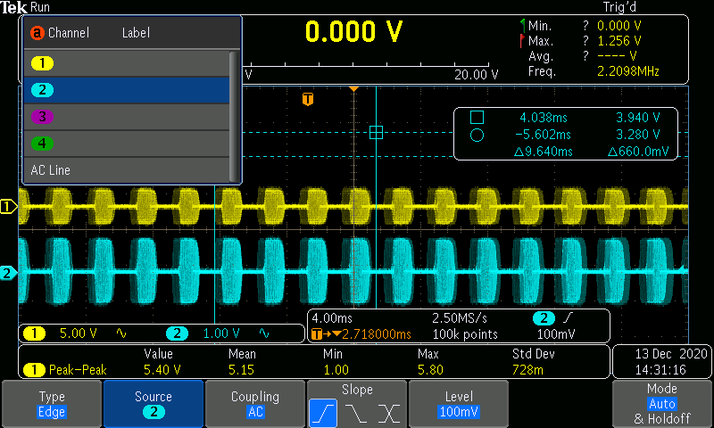

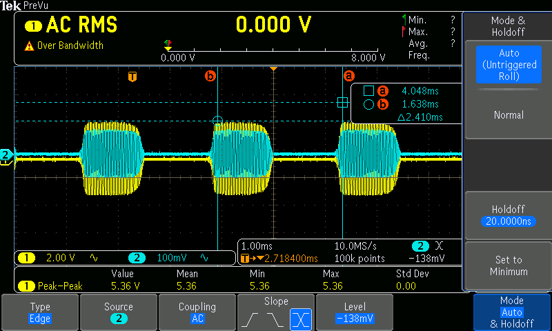

I've had some success this afternoon and gotten the amp to oscillate.
Here is a picture of it. The oscillation is coming in bursts about 2.5 milli-seconds apart (so not related to mains in any way) and the HF part is between 4 and 5 MHz.
Is this what you were seeing Tony/Bob?

Nope, no 'wave packets' as your pics seem to indicate.
Mine was a pure sine wave at between 16 and 20 MHz seems to be identical to Bob's problem.
I'll "poke around" with a compensation network today (as per Rally's suggestions) if I have time and see what I get.
