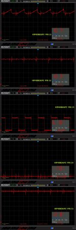

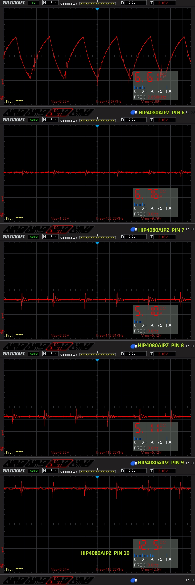

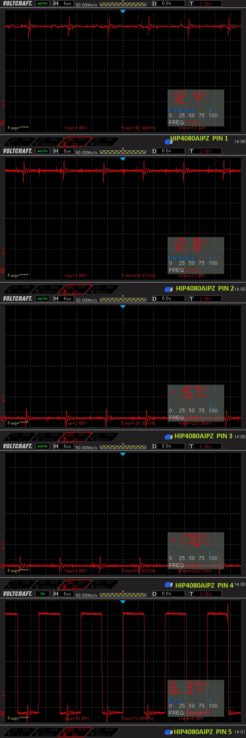

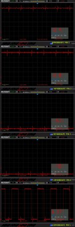

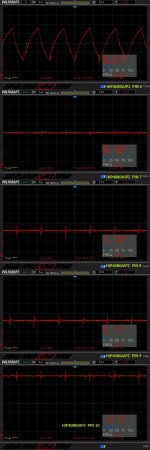

I have a problem with the amplifier. It broke a second time and the worst part is I don't know why. The amplifier came to me with damaged transistors of the power section (IRF1010N) and the output section (IRF1310N).
When checking the power transistors (IRF1010N), I thought that the control transistors (A1015) were also damaged. I exchanged a total of 28 pieces. 12 (IRF1310N) 12 (IRF1010N) 4 (A1015)
After the whole operation the amplifier sounded and everything was ok. Large electrolytes in the filtering ones look swollen 2200uF 80V and I decided to replace them with all the others.
Unfortunately, I couldn't find the big ones, so I listed all the small ones and that's when it started ... Sorry for the long introduction, but I wanted to describe everything in detail, because it can make a difference. The amplifier stopped playing. The relay is on, the green LED is on, but the output is silent. The TIP41C transistor cannot be touched after about 15 seconds from turning on the power. The tensions on its outputs are: 1 base - 13.4V DC 2 coll - 20.3 V DC 3 emi - 12.8V DC I did some measurements and they are all described and available in the attachments.

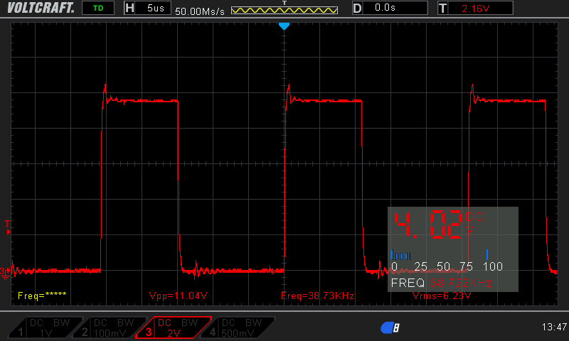

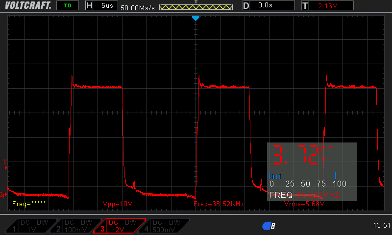

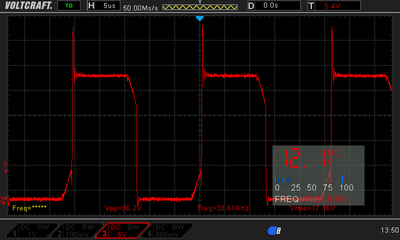

After the first repair on the GATE and DRAIN pins of the power section transistors (IRF1010N), I had an even square wave, and now it is not. Gate resistors are ok (47ohm). Voltage on 75V rails on both bridges. The supply voltage is 12.3v and limited to 2A. When TIP41C is removed, the current consumption is 1A, but when it is installed 1.4A.
I don't know why the square wave is so distorted on the IRF1010 and why this TIP14C gets so hot. I bent the output of the emitter, then it heats up slightly, but when all the outputs ... Without mounting the heat sink on it, I would not be able to make measurements with the oscillosc
I read various threads under "hifonics tip41c" but found nothing to help me fix the problem.
I am asking for help, because I have run out of ideas and I don't know what to do. 🙁

Do you see modulation of the square wave on pin 5 of the 4080 when you drive audio into it?
If not, check all pots and switches. One may be intermittent.

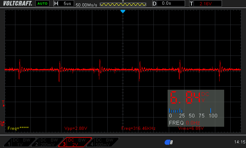

After applying the 1kHz signal to the input of the amplifier, I got a signal like this on pin 5 of the HIP4080AIPZ chip (attachment) I have already placed TIP41C on the heat sink, but I wonder if it is normal that it heats up so quickly and strongly.

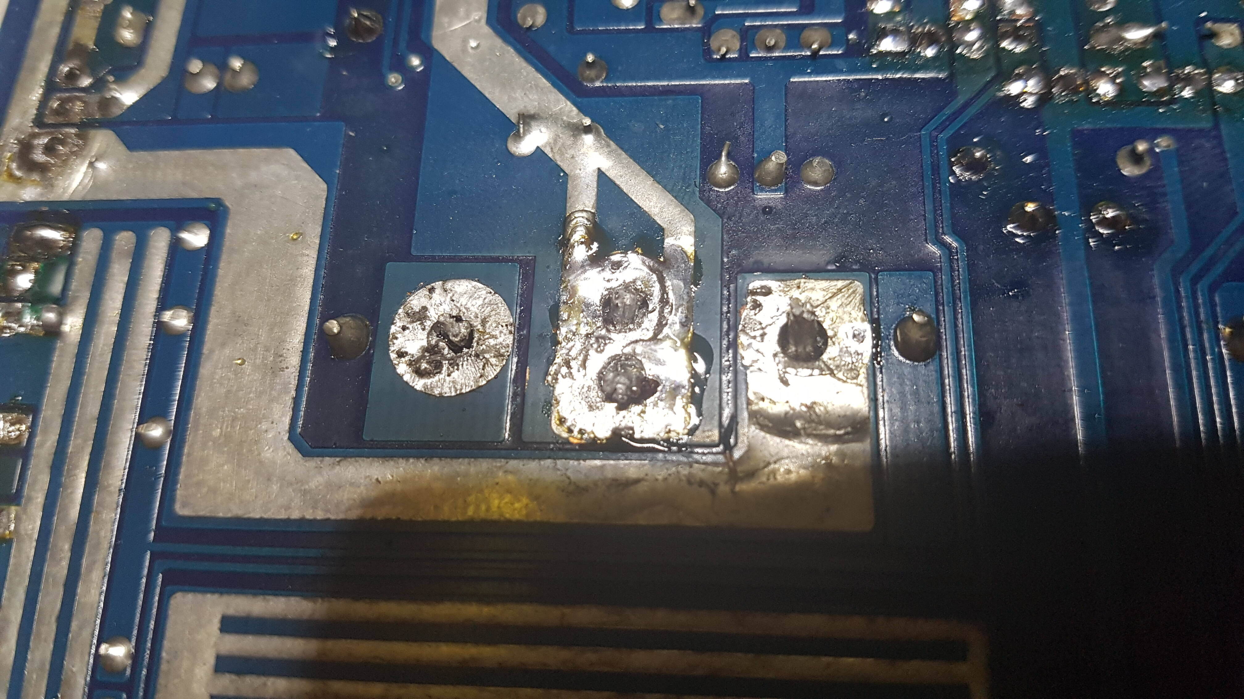

I have a short circuit on the secondary winding of one of the main power transformers. See them on the bridges. When I unsoldered the secondary windings, the short circuit on the bridges disappeared.

That signal on pin 5 should be present with or without the input.

Probably yes, but you asked "Do you see modulation of the square wave on pin 5 of the 4080 when you drive audio into it?" That's why I connected the signal to the input of the amplifier.

That image doesn't show modulation. Is there modulation with the input?
1k is likely too high for a sub amp. Use a 50-100hZ signal.

The output transistors are currently desoldered, but modulation appears on their pads. Tomorrow I will solder them and check them and see what will come of it. I am more wondering what about this transformer and rectifying diodes D1 and D2. I guess I can't just leave it there, can I?

Yes, there is a problem with the transformer. As soon as I detected this short circuit, I immediately desoldered D1 and D2 to check them, they are ok. I don't remember exactly and I can be wrong, but it seemed to me that the voltages on these four diodes are equal. The same on the two rectifier diodes for one transformer and for the other too, is it normal when the transformer's secondary windings are short-circuited?
I don't think it's a transformer problem unless when desoldering the windings, you broke a short.
In almost all instances when you suspect a transformer or inductor is shorted, it's best to troubleshoot, initially, without desoldering.
When transformers short, it's generally one of two ways. The first is a primary to secondary short. This will typically drive 12v to the secondary ground.
The second way they commonly short is primary to primary or secondary to secondary. This type of short will virtually always cause excessive current draw.

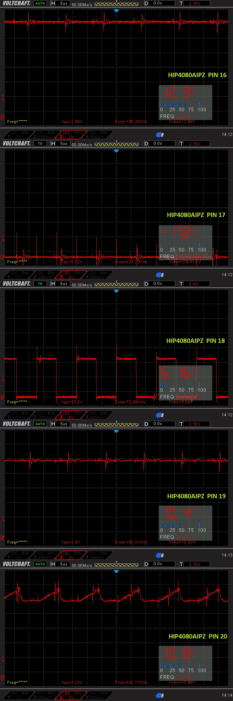

Is the 4080 IC getting hot?
What is the DC voltage on pin 15/16?
