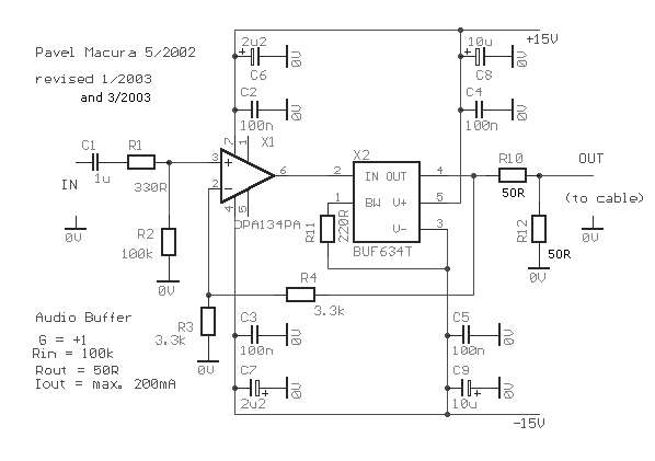

2) Regarding Pavel Makura's "diamond buffer" design http://web.telecom.cz/macura/dispre_en.html:
The buffer is integrated in a "unity gain, zero feedback pre-amplifier". I believe that an LM3886 chip amp with a gain of about 20, or a Nelson Pass Aleph or Aleph-X amplifier with a similar gain, will need more than "unity gain".
a. Please correct me if I am wrong on this matter.

George, I will let somebody more expert answer your question about driving longer interconnects, except to say that I used a version of the Les Sage circuit in my active crossovers and it drove 2.4 metre interconnects to the power amps with no trouble at all.
Re: Buffers:
Let me see if I can answer this at once. 😎
Well, it's not only a question of current output.
Both buffer stages on Nuuk's page will be fine for relatively long interconnects (and ok for those distances), because they both have low output impedance.
The difference here is that the op-amp+BUF634 will drive better a low impedance input stage. Also with lower distortion.
If that means it really sounds better, that's another story.
Those discrete stages should not be used with lower than 10k input impedance on the amp, distortion will rise.
You are correct.

Basically that means you have the same output impedance on the sender device as on the receiving device (as used in video and also S/PDIF transmissions).
But on a line preamp, 50R to ground on the end of the cable will attenuate the signal, so the preamp must have more gain.
Although Pavel reported good results doing that, I have never tried it.
Not that I think it wouldn't work well, but it's against my principles to attenuate, amplify, attenuate amplify the signal again.
Also, I have later built a preamp that trances this one on this thread by a not small margin (AD815), and I dropped this.
PS: TV antenna cable is 75 ohm coax.
