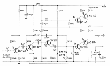

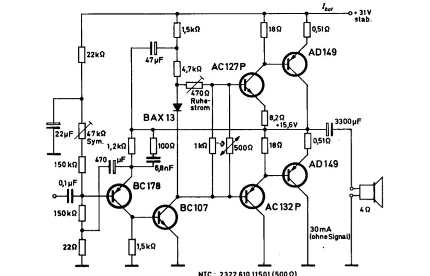

This is my first amplifier built. It figured in a booklet by Valvo transistors . The outputs AD149, were the most powerful ones available then in Beirut. It delivers 20w with 4 ohms.
