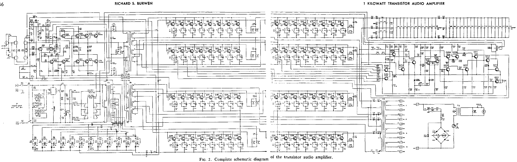

When I started, Ge was the only kind we could afford.
The early 1960s General Electric Transistor Manual has good examples.
Simply Googling your thread Topic brings up some stuff. more if you flip into "Images".
High power Germanium power amplifier - Google Search
I disagree. Google did not really help me in this regard. Pay closer attention to the schematics you realise 70% of them arent even GE transistor ones, and the few actual germanium ones are low power amplifiers.

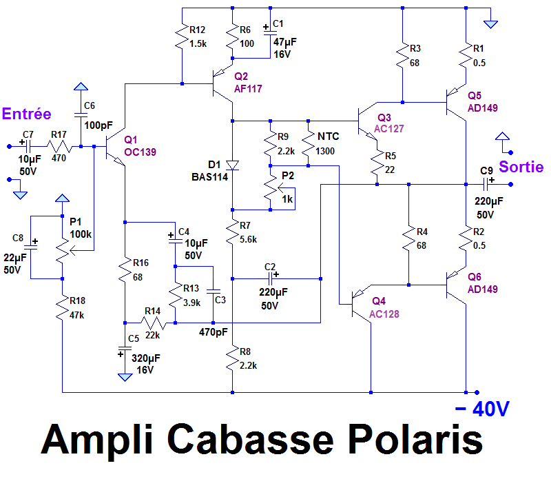

I agree why reinvent the wheel when you only need one...well the parts to make the wheel are basically dieing out. I just want to know if using silicon transistors (PNP and NPN) to drive the output finals germanium transistors would be reallistic. I am not looking specifficaly for extreme retro accuracy. Just want to hear the thing work.
My worry now is the biasing of the finals. With using germanium finals and silicon drivers I have no idea how it would behave at all..

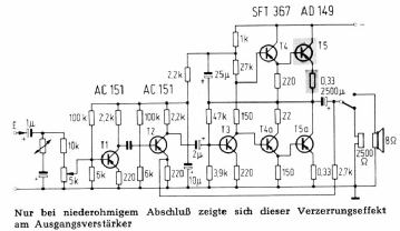

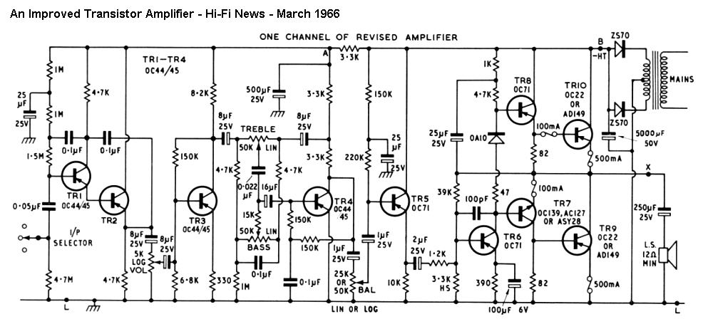

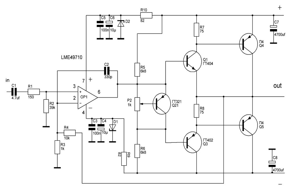

That´s a weird amplifier, so I don´t consider it an example....circuits mixing both.-The upper (first) diagram of #20)))
It´s a Class A only topology, no way to make a similar Class AB one, both power transistors are on completely separate circuits, top one is driven like on 99.9% of amplifiers and is DC coupled, also allows for DC feedback to stabilize output idle voltage, while bottom one behaves like a "modulated current source" for lack of a better definition, is AC coupled , has its own gain, only by chance supplies a signal roughly matching the one from upper half so is unsymmetrical by definition and NFB is needed to more or less match contribution from both output transistors.
It´s not biased in the conventional sense , only its idle current is set sort of hit and miss, having Silicon drivers is the least of its problems, a kludge if I ever saw one, so I can´t honestly recommend it.
A REAL design is the *second* amplifier posted by kokorianz in the same answer, and of course uses Germanium drivers and Thermistor biasing.
THAT is an example of a good "way back then" design and a model for many popular ones back in the day.
The first one .... ugh! ...
Asymmetric scheme: phase splitter (as JLH1969), loaded on Shiklai (Si npn and Ge pnp). The lower arm has an isolation capacitor at the input, which allows it to work in the AB class. Current offset from stabilized circuit. You can set the quiescent current for class A)))
