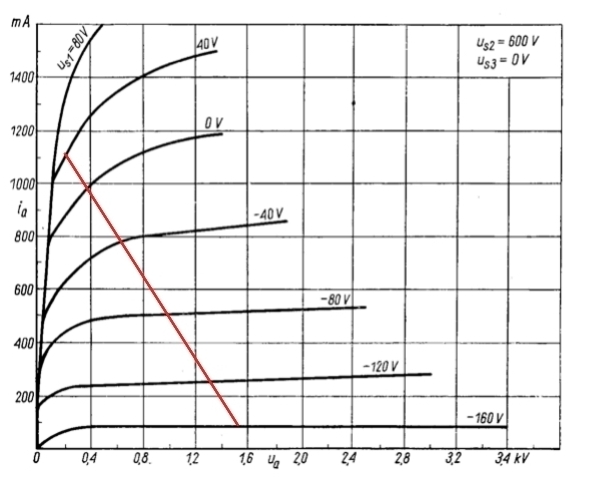

One tradeoff with transmitting tubes is often due to the relatively high plate circuit impedance, requiring high voltage and a high impedance OPT to reach the highest output power levels. The GU81 is not too bad, able to sink over 1 amp and swing down close to 100V, so your OPT can be of reasonable primary impedance and you can operate at lower voltages efficiently.
The OPT will likely present some conflicting design optimizations but maybe something in the 5K or less plate-plate (1250 ohms plate load in class B) can be done at the >500W power level. I have a pair of 300W OPTs that are 8K plate-plate...
With local feedback only, you're limited to effective plate resistance of >= 1/gm or about 200 ohms in your case plus the OPT DC winding resistance. That makes the 5K plate-plate sort of a minimum Zpri to have a decent output damping factor.
Do you have a load line? A pair of these could produce up to about 1300 watts output in class B or AB2 at 2KV or greater anode supply. There is however a really nice load line at 1500V and 1250 ohms (5K plate-plate) that would yield 600-750W output power. Drive voltage would need to be about 200V peak each tube (400V p-p per side)
If you do use local feedback, you could use a pentode like the 6V6 for the driver, feedback to the driver plate before the MOSFET follower. The MOSFET follower needs to be biased with enough current to reliably pull down the grid of the GU-81.

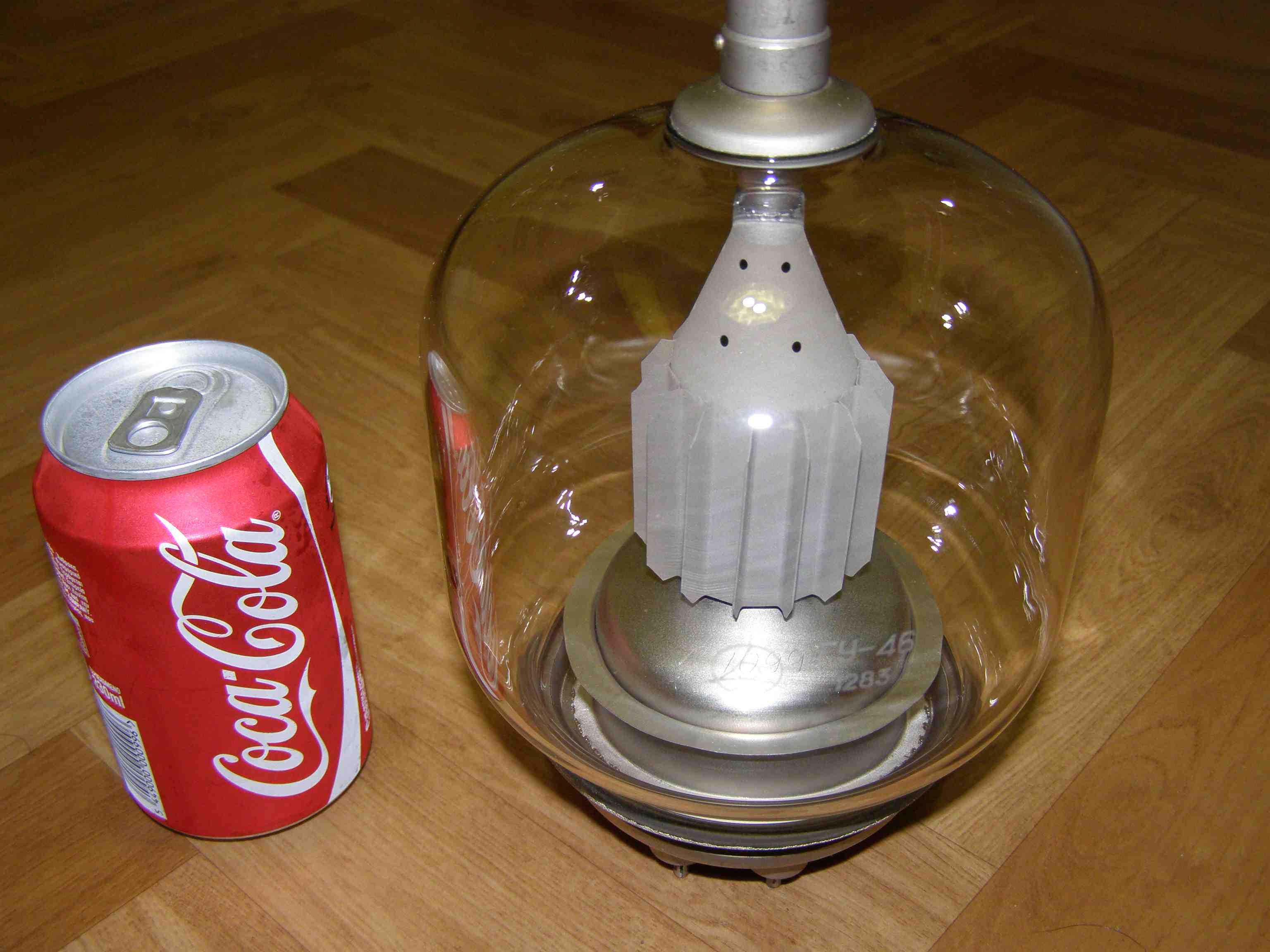

Scary project! 🙂
You could also warm up with a slightly more modest tube, the GU-46. Needs only 8.3V/15A per tube to heat up. You can run it in A1 with 600V on plate and screen at 500mA.
More modest? Surely you're joking...that is a 500W Tantalum plate. It does look like a 3-grid pentode, and I'd have to put it in the same class as the GU81m.
cheers,
Douglas
Yes, I was only joking. The two pentodes are quite similar, but gu81m's filament is a bit easier to deal with, 12V filament with center tap, so maybe AC is just fine; then grid 3 is on top, whereas grid 3 on the gu46 is part of its base, so it's more difficult to connect to it.
But both of them have low plate resistance: Rp of gu81m at 2kV Rp is similar to Rp of gu46 at 1kV, if I'm not mistaken.

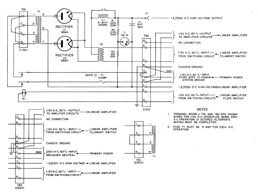

HI all, just a question.
As part of the learning experience I am trying to use my gas rectifiers (either for b+ or less likely for screen voltage).
I was thinking of a full wave setup CLC with small enough input capacitor so as to not cause the rectifiers to arc. DUncan's PSUDII is currently the software I use.
The basic schematic which shows my idea for a power supply is attached to this post.
I just have a couple of questions.
1) to reduce hum I wanted to use the filament transformer CT as my source of B+. Often one cathode terminal is used but some research and reading almost conclusively showed that better regulation and noise rejection is achieved by using the CT.
2) The transformer needs to be customed made since the rectifiers are huge. The current demand for basic functioning is close to 45A for both tubes @5v CT.
Since this xformerneeds to be customed made I would like to ask some questions:
a. given voltage in the filament xformer's windings it will have to have the same 3kv isolation as the main High voltage transformer. Are other considerations necessary?
b. B+ will ikely be 1600v +/- ripple and current will (in the worst of circumstances) not exceed 1.5A. Is adequate voltage isolation and current headroom all that is necessary to build the transformer?
Sorry for the dumb questions but these rectifiers and the B+ envolved are somewhat unusual!
Alex

I must be a noob because I really did not get the reference to "your mileage may vary" 😀
Mercury rectifiers are not practical but I do have large rectifiers which are just sitting in a large frame in my cellar/basement. Large units, plenty of headroom for current and voltage should provide a reasonably decent B+ supply.
From my research I found out that B+ is less important than a good screen voltage b+.
I have spare high voltage caps, decent chokes can be found and these mercury rectifiers are undoubtedly nice to look at.
The problem til now was getting my hands on a decent filament trasformer which could provide the current and isolation ratings needed for the high B+. I should have solved this problem so why not use them?
I promise to go SS for screen voltage
According to lem8r the filament transformer is just a conduit for unfiltered B+ and should only be constructed to sustain the additional current and voltage. I have found nothing on the net or in books to actually disprove this belief. Also large transformers originally built for tube rectifiers do not show significant variations from what would appear to be a normal, high current, low voltage transformer. I guess there are no requirements for, say, larger core o anything of the sort.
