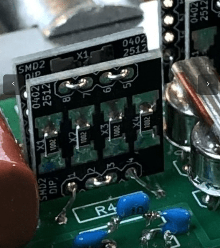

Here another example of making up TaN resistors from SMDs to replace 0.5W leaded :
https://www.diyaudio.com/community/threads/the-holy-grail-follower-output-stage.406850/post-7697283

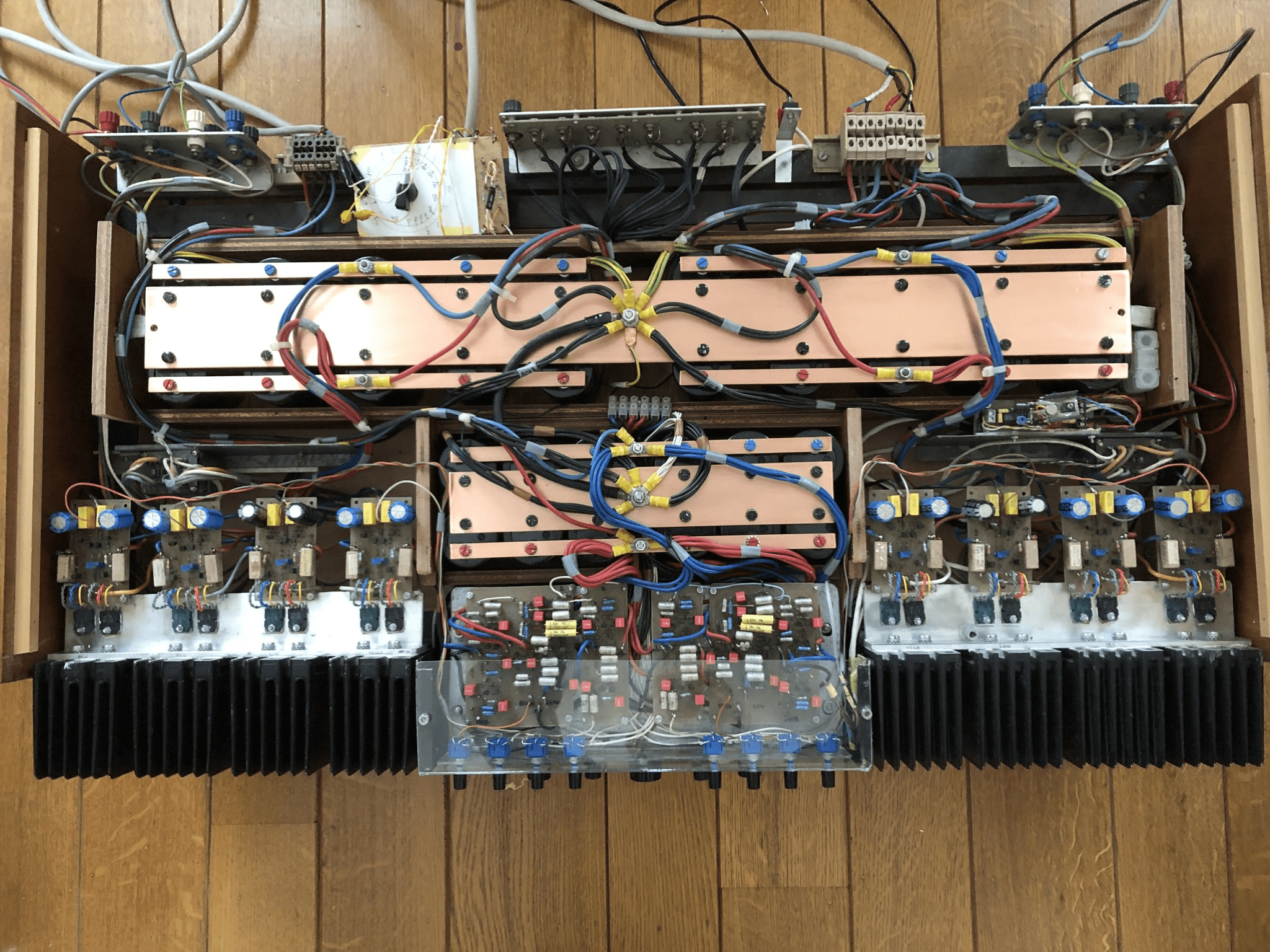

Hey Patrick
I built mine monster (Hiraga ... c.f.r. AKIBA) in 1983, in full DIY.
2x4 units (mine octopus), PSU with caps 2F, 2SK170/2SJ74/2SC1775/2SA87/2SB716/2SD756/2SD844/2SB754/ ....
In complement with 4 way actif X-over Kaneda filter.
Sublim .... it was music in heaven (with 2x4 (full) Horn concept)
Welkom in the Monster club.
Alles, Salukis.
Karel
Alles, Salukis.
Karel

I remember a test & home:
* With a full Horn concept (4 way) & 2x4 monsters (Octopus) I measure 105dB @ 4watt before clipping ....
Music in heaven ....
Alles, salukes.
Karel
@ patrick
* Thanks for your golden thumb.
FYI
- PCB are identique (in home made ...copy/paste ... hand made design ) ....
- Tantalium, (I présume in the actief X-over) ... I hate it .. After a long time power off it's a real danger (explosion-fire). I change it with 2,2micro/63V ...
- Trimmers .... no TOCOS .... simply, the very good BOURNS multi turn ....
FYI
Alles, salukes.
Karel
In case anyone cares.. Those are from the "PFC" series, purchased at Mouser. The 1206 case code is rated 330mW. What you see there is my series feedback "resistor", 40k (4x 10k in series) with a 1.3W rating. A little B. Hofer influence there, feedback shunt resistor is another identical 10k. (The gain is set low in my FE because I have a tube preamp that is not allowed to loaf..)Here another example of making up TaN resistors from SMDs to replace 0.5W leaded :
Patrick
SMD adapters from fleabay..

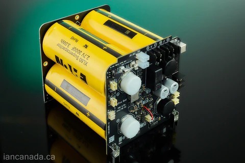

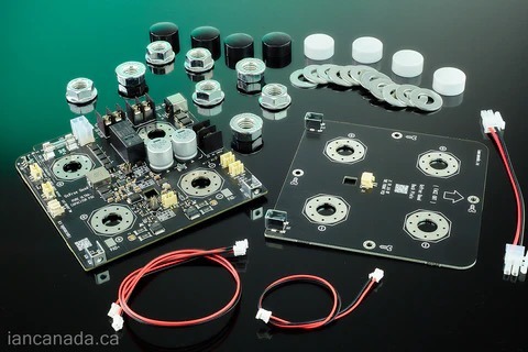

@cumbb I'm building a PSU with threaded super-capacitors and it always bugged me to use metal nuts and washer. I was looking to use copper nuts instead of the stainless steel provided with Ians kit. Thank you for this tips, nylon/plastic makes way more sense. 🙏🏼For capacitors with screw terminals use plastic screws. This reduces the conductive contact area, which benefits the definition of current.

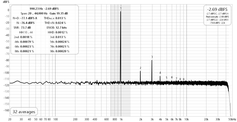

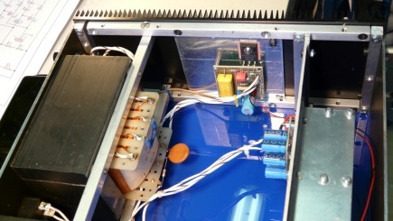

It has taken us some extra time, but we finally got round to measure the Le Monstre Deluxe as well.
This has original transistors, all TaN resistors, including Shinkoh for the 220R in the feedback network, RA12P trimmer, Riedon 1R 35W thin film, etc.
As described in the article.
The surprising thing is, that H2 & H4 are ~20dB lower than the previous prototype using same active devices.
So what has changed ? 20dB less even harmonics cannot be just due to the passives.
Well, the JFETs used in this were matched at Id with 50R source resistors, instead of at Idss.
They also happened to have quite close Yfs at that current.
On top of that, we used the current source bypass to keep the 1k drain resistors and 0.7A bias.
So the trimmer was almost at its mid-point when DC offset is trimmed.
And now you get near perfect even harmonics cancellation from top and bottom halves.
And maybe the higher bias with the original output devices also contribute to some extra distortion.
Just tells you that no two Le Monstre's can be exactly the same, unless you measured every active component upfront.
Patrick
