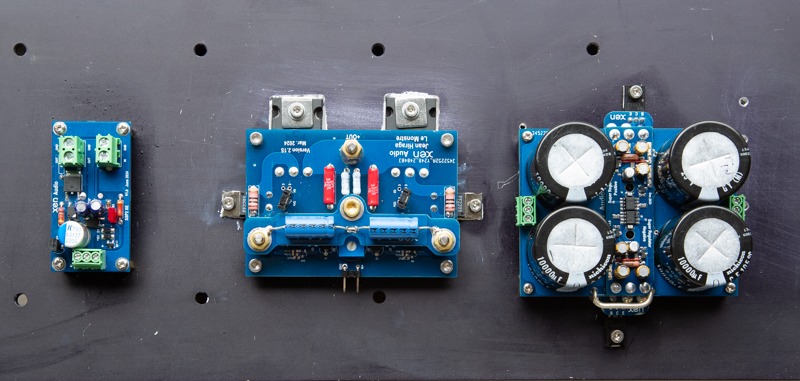

If anyone wants to build 99% close to what Hiraga has published, we have already published the Gerber files of his PCB design.
You can get most of the original transistors on the internet.
We got all ours from a DIY shop in Hong Kong, apart from the 2SK170/2SJ74GR which we have our own stock.
You can also get leaded tantalum resistors (including Shinkoh’s) relatively easily, at a premium.
And you can follow the published schematics of his power supply without much problem.
We appreciate good analogue designs, and these cannot always be judged by measurable parameters.
When we rebuild a classic design, like the Le Monstre, we also respect the original, and only want to change if it is necessary.
Otherwise we might as well design our own, and we have done that before.
If we were to build the Le Monstre again, we shall certainly only build the LM Modern, using active components as detailed in our article in post #1.
We shall use the CCS bypass as described for JFETs with Idss >4mA.
And we shall use good passive components – meaning those known to be low noise, low tempco, good reliability but of current production.
Incidentally, the RA12P is wire-wound and is a good trimmer which we shall use again, also elsewhere.
But of course, we shall use our own PCB, as we believe modern SMD components give us more freedom for a better layout.

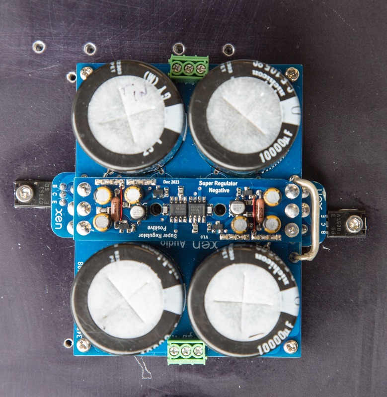

As to power supply, it is true that the Le Monstre circuit is not outstanding for PSRR.
And we are not dealing with very large signal amplitudes.
So it makes sense to have a low noise power supply.
But the voltage does not have to exact and constant over time.
This is also reflected in the original design, with the huge bank of capacitors.
They form a very low frequency low pass filter with the CRC resistor, as well as low output impedance at high frequencies.
The Le Monstre is a fast amplifier, with -3dB bandwidth up to MHz.
IMHO, the power supply needs to be able to match that, i.e. with low Zout at high frequencies.
Feedback type voltage regulators, including so-called Super Regulators, are inductive at HF, and only rely on the output capacitor to give low(er) Zout.
So if we were to do this again, we shall most likely use a Cap Multiplier instead, maybe optionally with a simple 317/337 prereg.
It is more important to use separate supplies for each channel.
If we have to be restricted to regulators, we shall probably use 4x LT3045/3094 in parallel, with film caps at the output and not MLCC.
But we have not tried. So purely speculation, if you like.
Our own plan now is to put the LM Modern in a suitable case, with toroidal transformers and most probably cap multipliers.
And then find good homes for the LM Original and the LM Deluxe for someone who appreciate them.
If there is still sufficient interest in our PCBs and in the input JFETs (GR grade, matched, no Idss cherry picking), we shall make them available in Group Buys.

What would be the difference compared to DIY audio store Super regulator pcb? Using GLED431 or extra transistors?As to power supply, our version of the Didden Super Power is too difficult for average DIY.
For me the most important is the sound, the feeling I get from it.
Can the super regulator from DIY Store deliver 1.5A current ?
Or you mean why it is difficult ?
Patrick
Patrick
Yes DIY store regulator can deliver up to 1 A current.Can the super regulator from DIY Store deliver 1.5A current ?
What changes you made in this regulator that it can deliver 1,5 A or more current? Yes I mean why it is difficult and you think that diy users can not make it so easily?
Do you share the schematic?
We use a discrete Darlington with the same power devices as the Le Monstre Modern.
It can easily deliver up to 10A with sufficient heat sinking.
The previous GB experience with the Dao headphone amp told me I should not do this again.
You can get something similar from Belleson.
About 70€ per regulator, without power device.

On the same subject, you can try to use TIP122/127 for the pass devices.
That will give you more current, but not more power dissipation.
And of course you will need larger caps.
I have not tried.
You should ask Jan at the support thread.
https://www.diyaudio.com/community/threads/super-regulator.247281/
Patrick
I have not tried.
Patrick
Our two deluxe modules, as in Version 1 in post #146, have already found a good new home.
https://www.diyaudio.com/community/threads/hiraga-le-monstre-2024.413301/post-7757582
Patrick
Patrick

It is possible without the darlington transistor, it is only necessary to ensure sufficient current through the CCS to drive the pass transistor. Normally, it is necessary to dimension the CCS components for that current and that is all that needs to be done. In the new version I drive KSC5242/KSA1962 with ZTX450/550 and there is no current limit, everything depends on the pass transistor. This is also a disadvantage because the classic version has a current limitation by itself.
In our version, the CCS is less than 3mA, and not 40mA+ as in post #177.
It works with both Darlington and with Sziklai.
Using TIP122/127, you can actually use the DIY Store boards with sufficiently larger heatsinks.
See post #178.
Of course none of these were used by Jean Hiraga.
His was just CRC with a huge amount of capacitance.
Anything else is individual interpretation.
As was our Didden regulator.
But of course everyone is free to choose what he likes best.
Patrick
