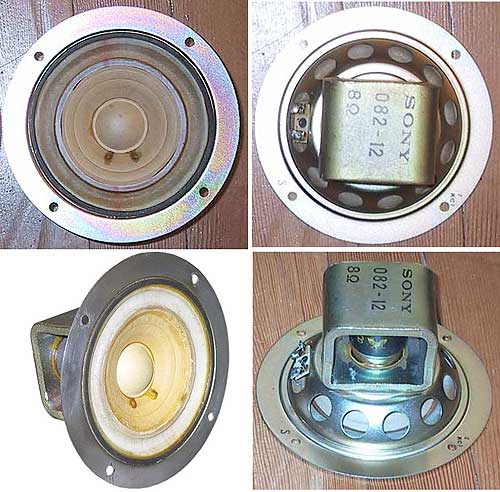

Reviving a VERY old thread here I know, but just wanted to say that these little Coral "holey basket" drivers are superb. I've run them against a lot of bigger, and far more expensive drivers (lowther, supravox, altec 755, visaton, etc.) in an antique open baffle cabinet, and these are the drivers that live there for good now. Several years now in our living room system and NO ONE who hears them can believe the magic coming out of these little things. Its unreal. I own 3 pairs now...just in case. For what it worth...

Thoseare closely related to the Coral Holey Basket, but that is not the right basket. It is called the Coral Holey Basket because the basket has holes in it.

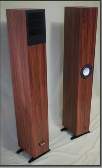

After a closer look at the Frugel-Horn Mk3 , the image here is pretty similar inside with a single turn at the base then venting at the rear on top , was originally designed for the Fostex FE108EZ and altered for the FE103En , suits the Corel Holey Basket .
Very effective and easier to construct than a complex multi turn rear loaded horn design .
In effect if you were to unfold the bottom turn and construct it in a linear line you would have a conical horn .
For a second system am going to try using the Corel Holey Basket in a Solo 103 cabinet .
