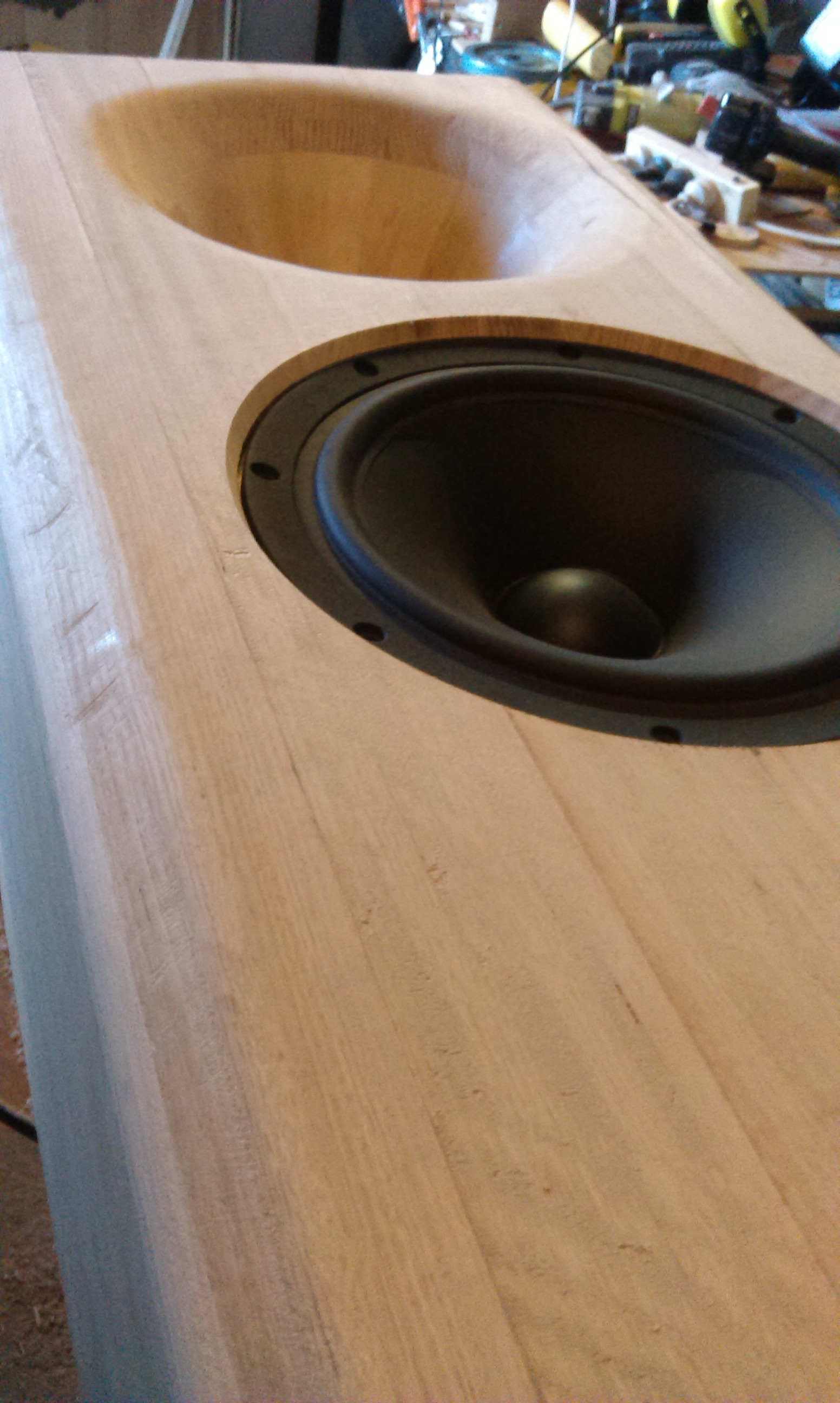

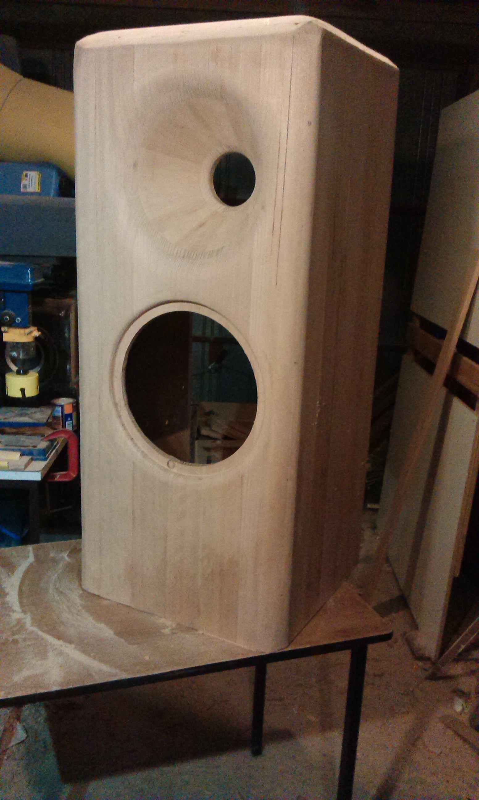

After some false starts, I have finally settled on a design and am getting towards something that looks like a speaker.
There are about a million hours of work still to go on this, mainly sanding - the more I sand any curve, the better it looks.
Drivers:
12-SB34NRX75-6 (to be delayed / crossed via mini DSP)
SN4-60F (unless I find something better*)
Ideas that didn't make it:
Taller version with 2 bass drivers**
Similar horn, but asymmetric (oval mouth)
Similar horn, but longer throat section
Inspirations:
Azura / Oris type horns
This thread - http://www.diyaudio.com/forums/full-range/259293-prv-5mr450-ndy-fast-applications.html
hearing some >$20,000 speakers, and being impressed by many aspects - but not by how vocals sounded.
* the Tang Band W5-2143 seems pretty tempting.
** just too heavy and unwieldy. I can console myself with the knowledge that putting the spare drivers in their own enclosures (distributed bass) is a technically better idea.

Horn FAST in Timber
Very nice looking job. I think the design is great and it should work well too. I would love to see step-by-step construction pictures or at least a description of how you made the horn/waveguide integrated with the front baffle. How do you intend to finish the timber? I am about to embark on a similar project and your design takes care of aligning acoustic centres of the two drivers while providing some extra loading to the fullrange driver. Is the horn/waveguide a simple conical or some other curve?
Are you leaving the back of the FR open as an OB or is it a closed-back driver?
I would be tempted to make the horn part on a lathe, then attach it to the front baffle and then use a roundover bit on a router to match it to the front baffle surface, but then I don't enjoy sanding as much as you ;-)

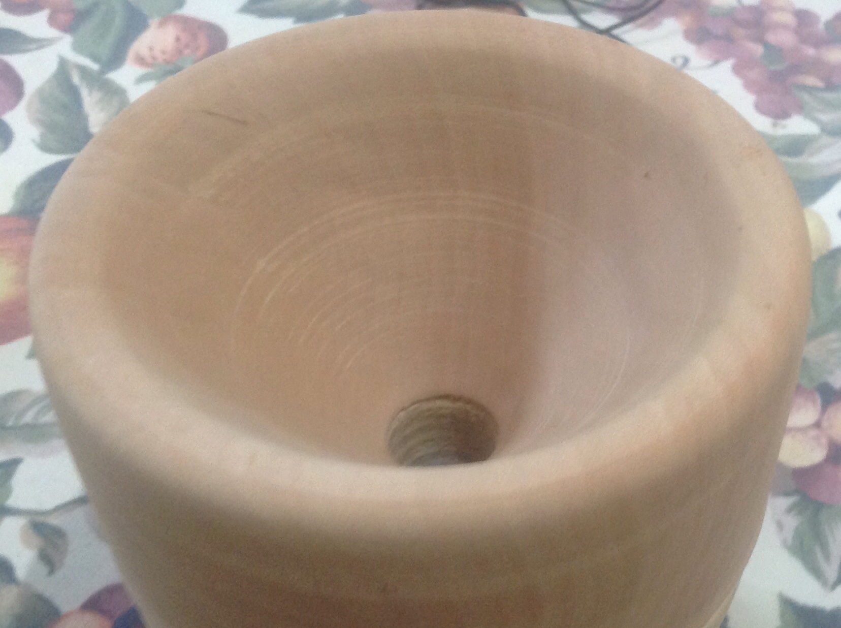

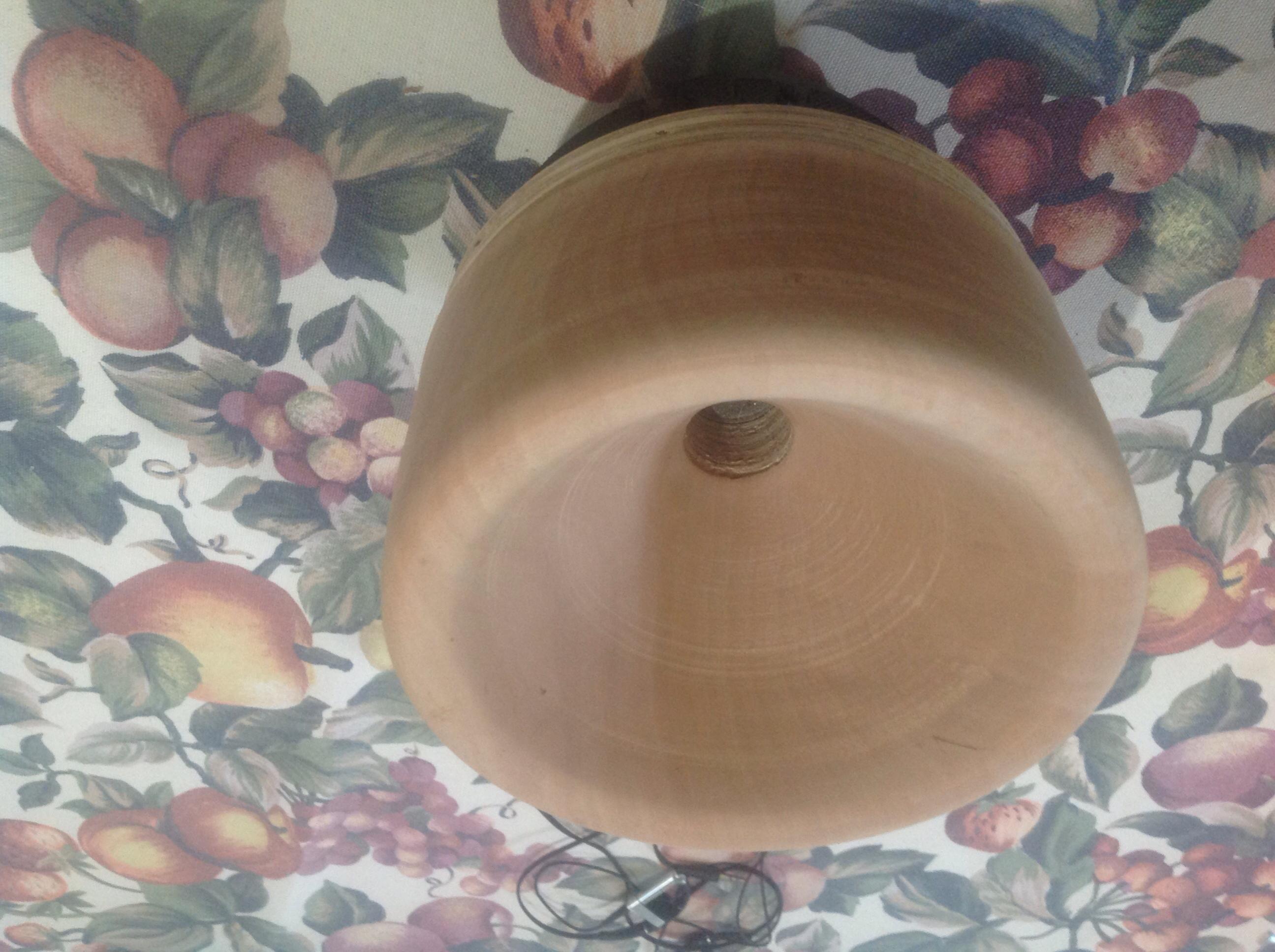

I made a wooden bowl once. I remember using a rounded scraper made of thin sheet steel - and you slowly scrape away the wood. Use a template to compare the shape every now and then. Very labor intensive and similar to how someone in the stone age would have made a wooden bowl but it works.
XRK, if you use sharp lathe tools there is very little need for sanding. I turned a horn for a 60W compression driver that is intended for a 2- or 3-way design. compression driver crosses over around 3kHz., sorry pic is upside down, bl@@dy iPad file management. BTW my horn is approx 6" or 150mm diameter at the mouth. I still need to do some work with filling and sanding of the throat as 19mm plywood tends to pull out grain when turned. I needed plywood to attach driver as it is bolt-on type. Re FAST design, I think up to 12" (30cm) horn mouth is doable on most home lathes, but I am interested in how Hollowboy actually made his horn.
ozziozzi: look up "SEKIN Serving bowl, birch" and the rest explains itself, I think. Note that Hornresp allows you to calculate the dimensions of petal horns, so you can build something aesthetically similar in any size / angle. The Sekin happened to be almost perfect for a 4" driver, which saved me some time.

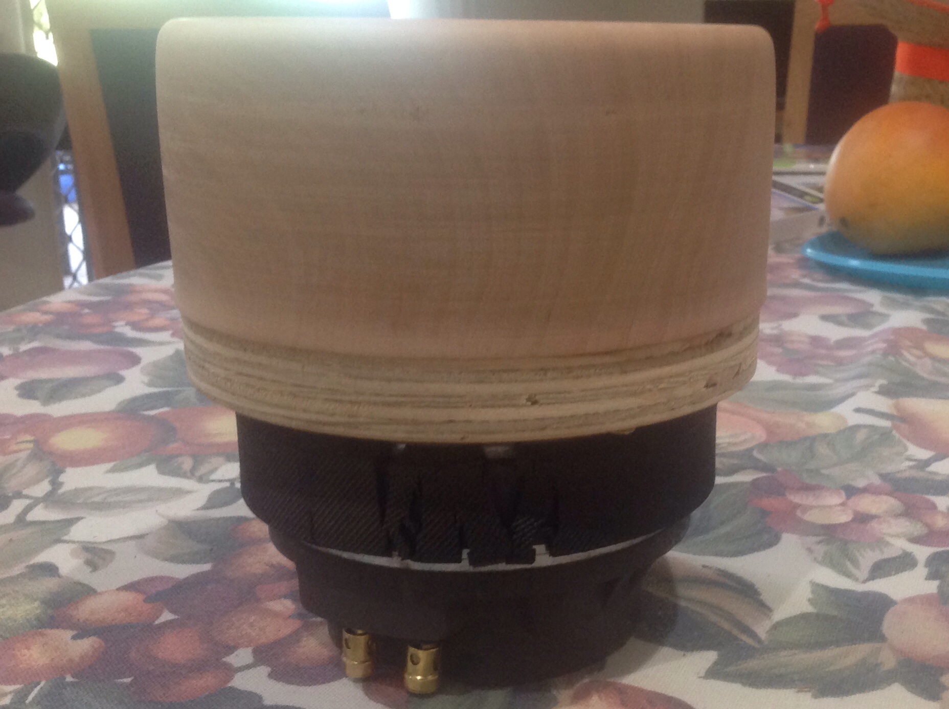

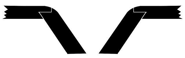

I have found Sevin serving bowl, but picture doesn't explain how you integrated it to the front baffle. I was thinking of doing something like the Econowave design as I have 2 nice 15" EV 15L and compression drivers, but FAST with OB or horn mid/tweet is a good FR alternative. I have a small collection of 4" fullrange drivers that would work well in your design. BTW have you read reviews of Yamamoto speakers. They have an open back, so essentially U frame sub, but sides are as deep as the front baffle. I read a review which criticised this design because of strange resonances. I have read MJKs H and U frame designs wher he stresses that sides should not be too deep to avoid cavity resonances. That could explain the "odd quality" that you mention. I guess that you plan to put back on boxes, will they be sealed or vented?
I have attached pic of what I had in mind for my horns. It is not too hard to flatten the front of horn and roundover connection to front baffle, but I really liked the way yours seamlessly flowed from horn to baffle. PS Did you attempt to time align the two drivers physically or are you doing that in the miniDSP?

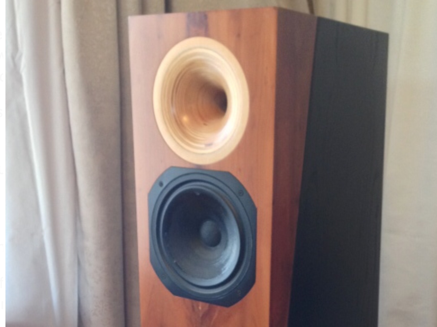

How to get a similar baffle / mouth
- make a sandboard by gluing strips to a tabletop or similar
- use that to grind the top of the SEKIN flat
- cut a (slightly smaller) hole in the speaker baffle
- chamfer that hole with a router
- glue the Sekin to the back of the baffle (use lots of glue and weights)
- laminate a 2nd layer of timber to the baffle (offset the joins; use lots of glue / weight / clamps)
- re-do the cutout in this 2nd layer
- finish with file and sandpaper and swearing
This last step is the biggest time-eater for me, because of failures to plan & measure properly, and because I cannot chamfer the entire 19mm thickness of the timber I'm using, with my current equipment.
I'm glad you like how it "seamlessly flowed from horn to baffle". It is not really seamless, as there is a sharp transition in grain orientation between horn and baffle.
With patience, a lathe and other good equipment, you could do better than I have, by making make a petal horn from thick timber, lathing that smooth, then cutting / mounting it as pictured.

"thanks for pointing me at IKEA SEVIN bowls and your techniques for modifying them. One way not to worry about blending in horn is to use a contrasting colour wood, but that's a style choice rather than technical issue."
Spelling (for anyone doing a web search) - the bowl is Sekin with a k
My GF went to IKEA yesterday & I asked her to pick up some more of these. Therefore, if you'd rather pay for postage than do the >2 hour drive to your "local" IKEA, I could mail a pair of them to Brisvegas ($26 for the bowls + whatever postage comes to).

Re: Sekin bowls thanks for you kind offer, but you are talking to a wood turner;-) I can turn up to 300mm diameter wooden bowl / waveguide including hole for driver throat. BTW how do throat and slope of walls of your bowl/waveguide match to the cone of the driver ie: diameter of cone vs diameter of throat? I guess they are basically conical waveguides. The bottom of the IKEA bowl looks flat-bottomed. Are you worried about that? I can achieve a taper to the exact throat diameter needed. Not sure how important that is for a waveguide, but examples I have seen try to make the transition from driver to horn/waveguide as smooth as possible to avoid frequency anomalies or distortion. See example of waveguide for compression driver that I turned. Throat needs to be smoothed as 19mm ply tends to pull out grain from the different layers unless tool is very sharp. Keep up the excellent looking speakers you are building. Let me know how they sound when completed. I think you are heading in the right direction.
