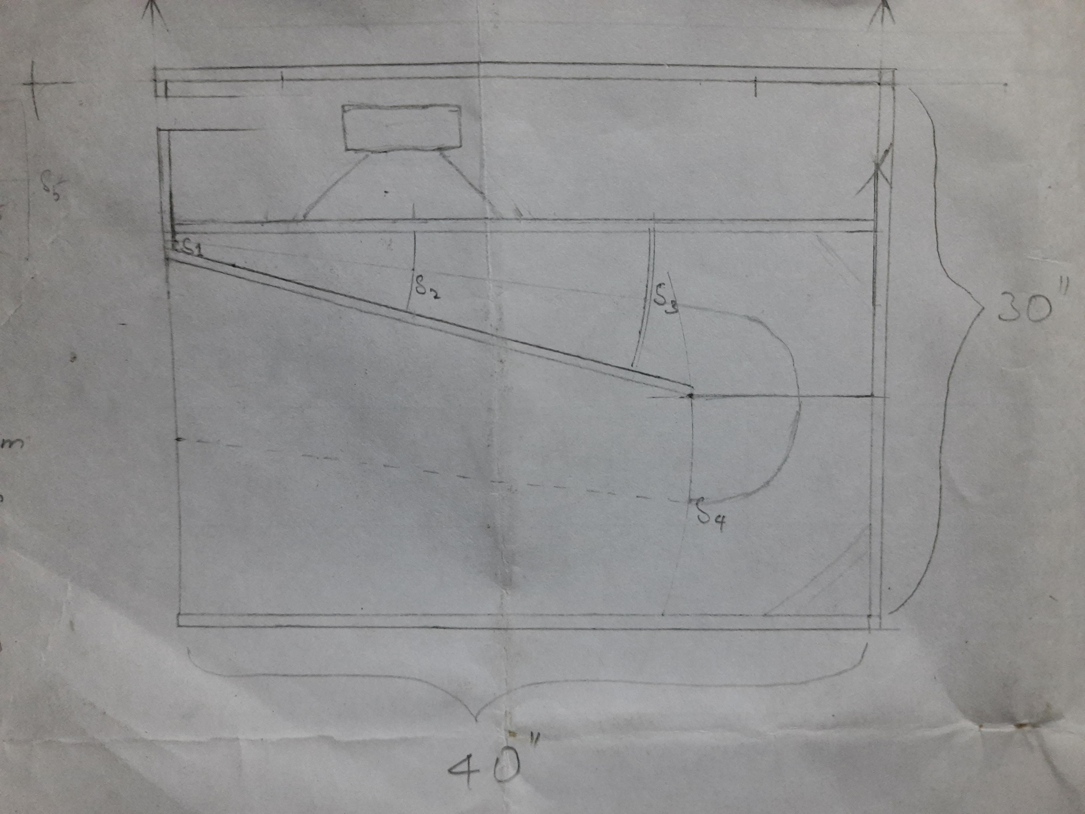

I am currently planning to build a FLH with vented chamber
From some knowledge on reading tons of treads on horns, I know that the straight round horn is the best case scenario 😀. But horn gets very long therefore, folding.
So in folding horns, 90 degree bend better than 180 dergree ?.
Does 180 degree bends mess up air flow ?.
Does it creates higher order modes ?.
Causes unwanted turbulence ?.
I have never seen a FLH with 180 degree bend. But a 'TON' of tapped horn with 180 degree bends....

My bass horn consists of only one 180 degree fold 🙂. Based of the reply I think its fine to fold 180.😀.

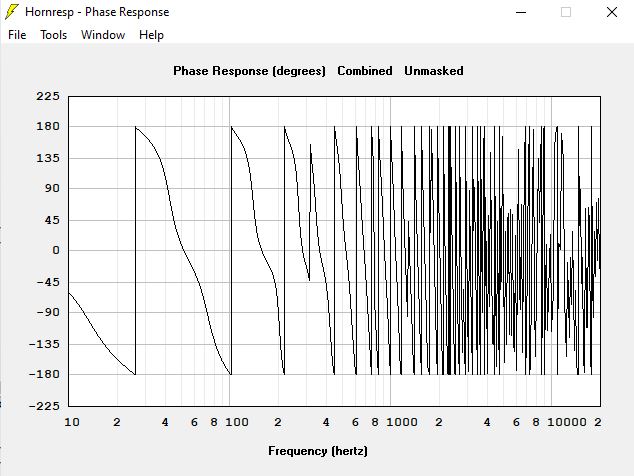

Vishnu phase matters which way is your driver facing? would you mind sharing your plan?
here is the phase response.
Auto Phase in Hornresp may pick the wrong delay settings. The delay time should be roughly a negative second for every foot (30.48 centimeters) of the horn path as sound travels 1130 feet per second.
Group delay and phase won't be representative until subtracting delay equivalent to the path length, see posts #12-16:

When you do a 90 degrees fold, the distance beteween the outer perimeter and the inner determines the frequency where you get cancellation. When the outer perimeter is half a wavelength you get cancellation. As an example, the largest bend in your design is 340 mm from side to corner. Total length is 680 mm. A full wave is 1360 mm, 1.36 m. Speed of sound is 340 m/s. Divided by 1.36 m you get 250 Hz.
180 degrees bend you will have to double the distance, or half you frequency. The same example will give cancellation at 125 Hz. So avoid 180 degree bends.

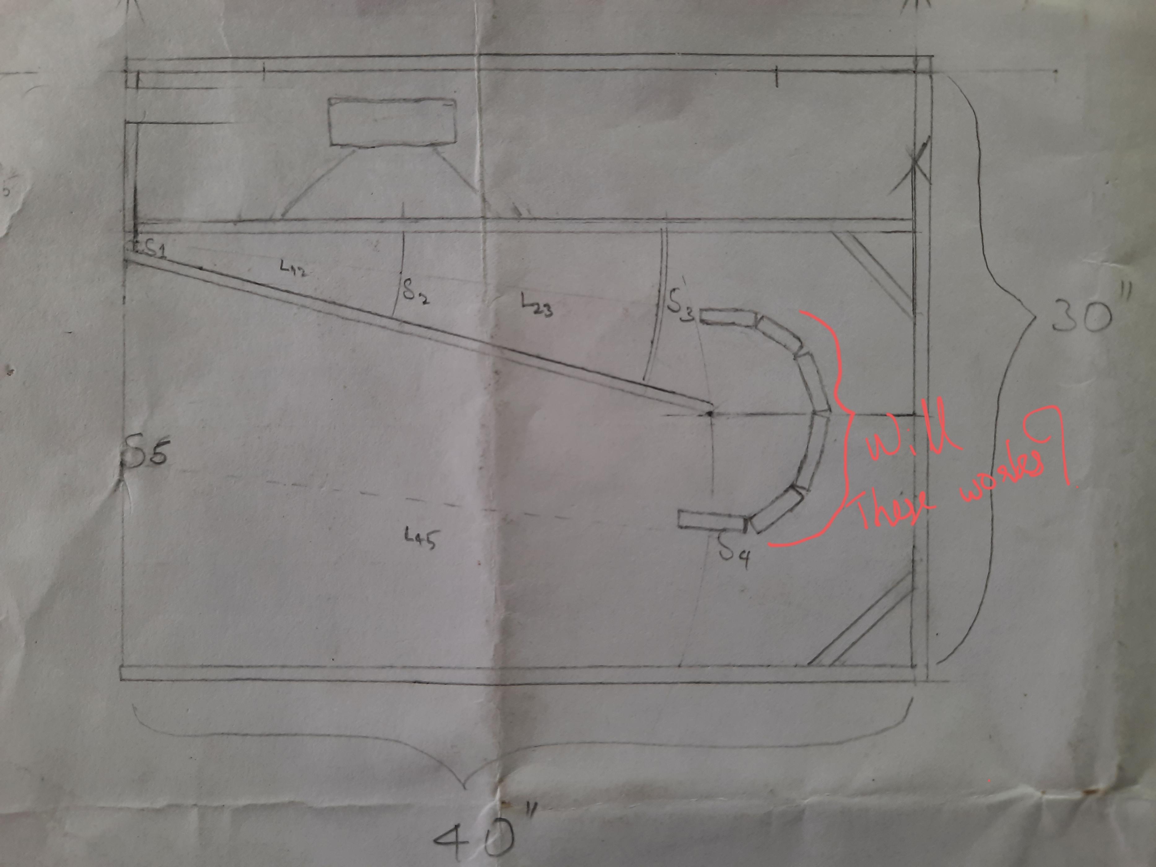

I dont know if it will work, does adding wood pieces like this for dividing the airflow decrease the internal turbulence and change the cancellation frequency to a higher one ?. Or is it a dumb design fail 😱. I need this horn to go about 150hz high. Please correct me 😕.

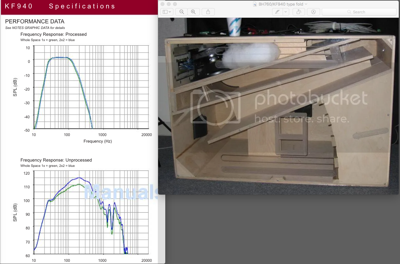

here's what the late Dr. Bruce Edgar said in an article for a horn he made for me
key words = "somewhat" and "diagonal reflectors" (I don't know how far that goes)
I thought that it could act like some sort of a phase plug, and hopefully reducing high frequency interference 😕.

Adding a second set of internal corners to your folded/bent horn path would not be useful, though longitudinal bracing is helpful to stiffen up the horn path.
The EAW BH760, KF940 and countless other horns have similar bends of near 180 degrees as in your design, yet show no cancellations due to the bends until above 1000Hz, well past your crossover range of 150Hz.
Art
Art
