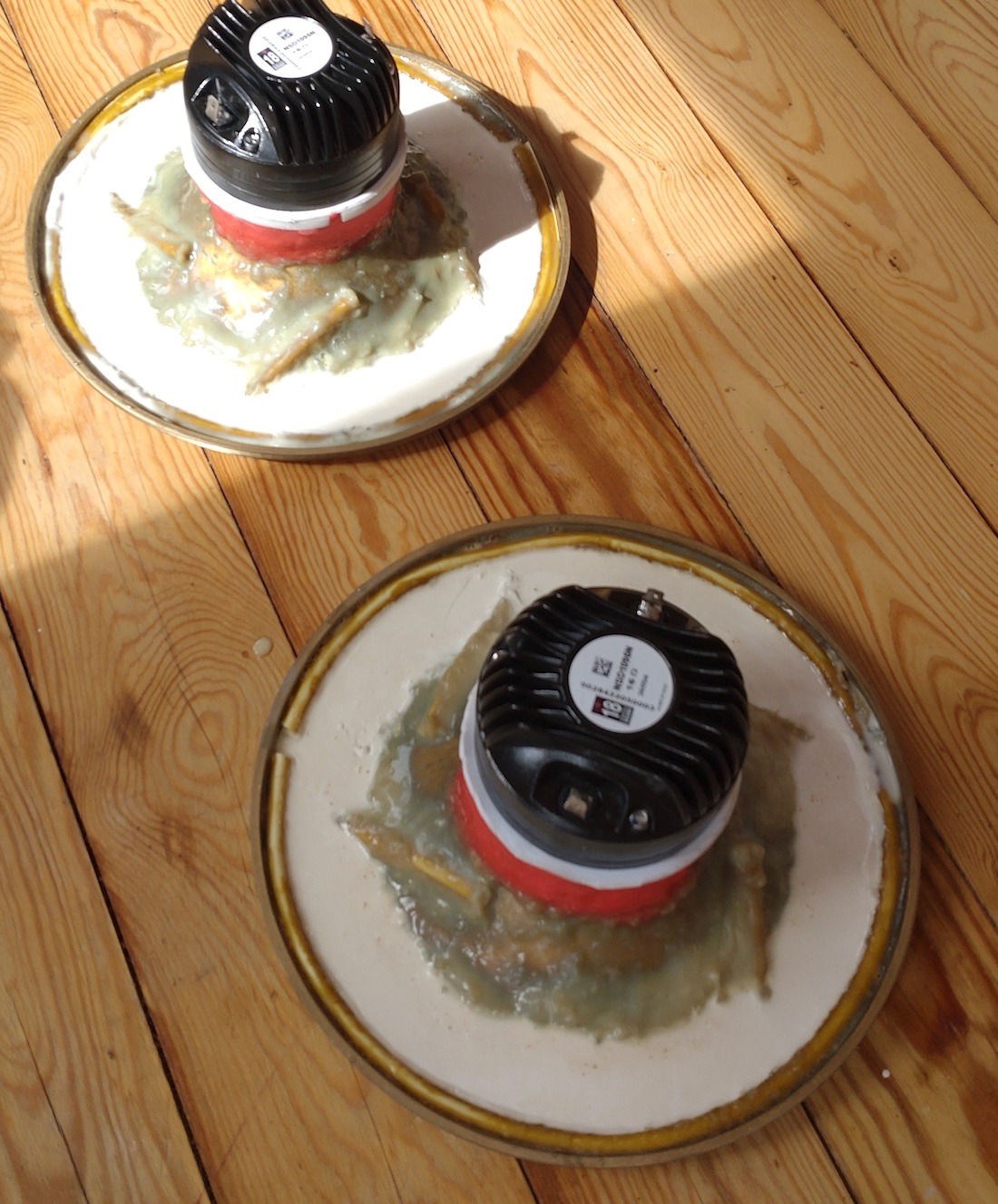

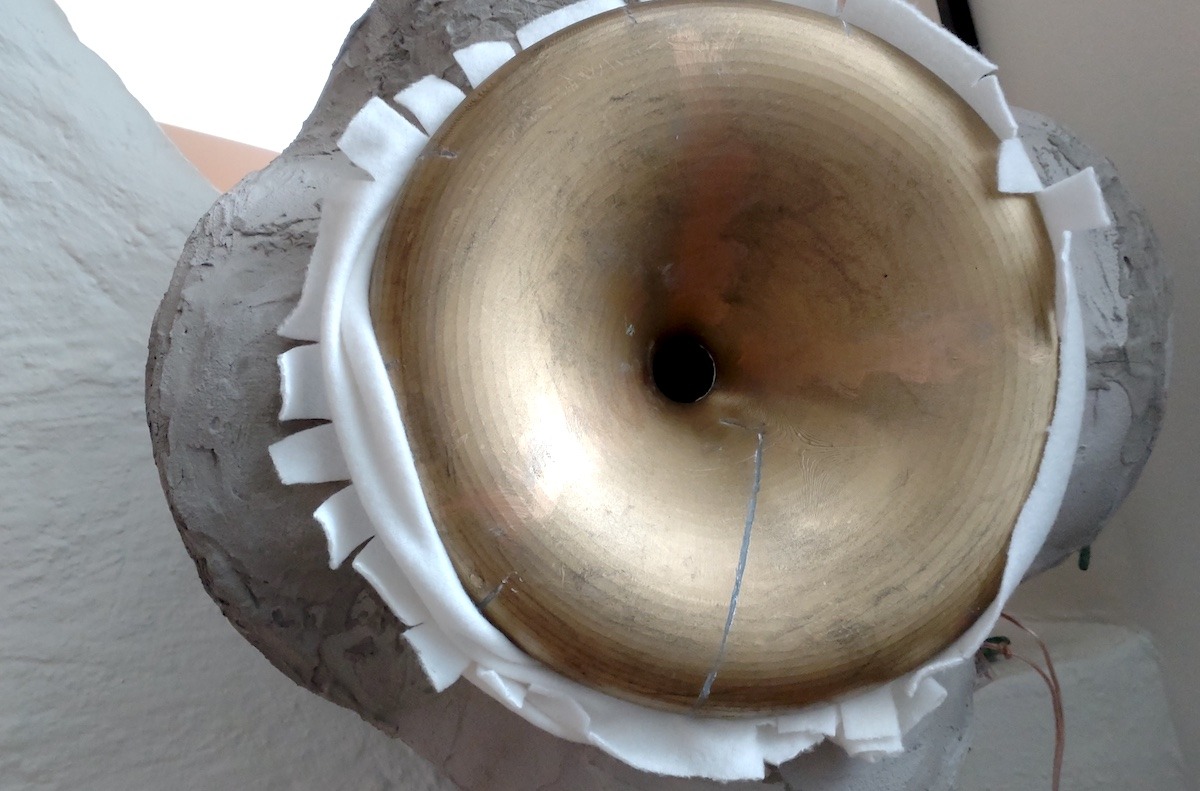

I have done a few things after listening a lot and thinking some. One thought that struck me was; what if the CD+WG works as an exciter on a bending wave plate - that would be really nasty with the energy being excited before the acoustical throat/horn contribution - like a pre-echo. But it will be a really poor one with a really nasty bell resonance due to the shape of the "bender".

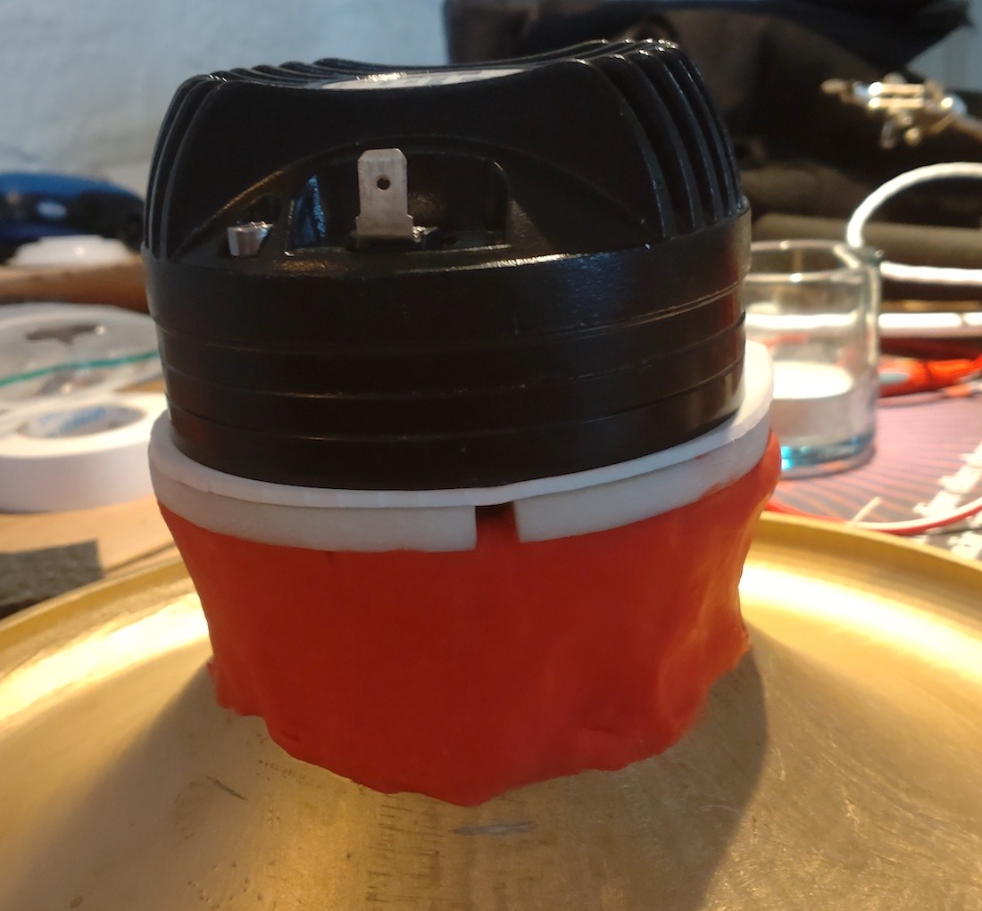

The bending action was adressed by decoupling the CD from the horn by a gasket for less mechanical energy transfer. As a general resonance precaution I engulfed the throat with Plastolina.
Also looking at the WG itself led to church towers and the powerful PA entity of the bell. I really don't want to listen to a bell so I had natural latex damp the backside of the WG.
These 3 actions I have not measured on yet but I experience a useful improvement in SQ wrt. the sometime little harness that pop up and bite you. After this I could also without problem go from 1,6k to 1,3k XO.
I will measure this state and then continue with the following pretty brutal mods, hopefully returning further improvements:

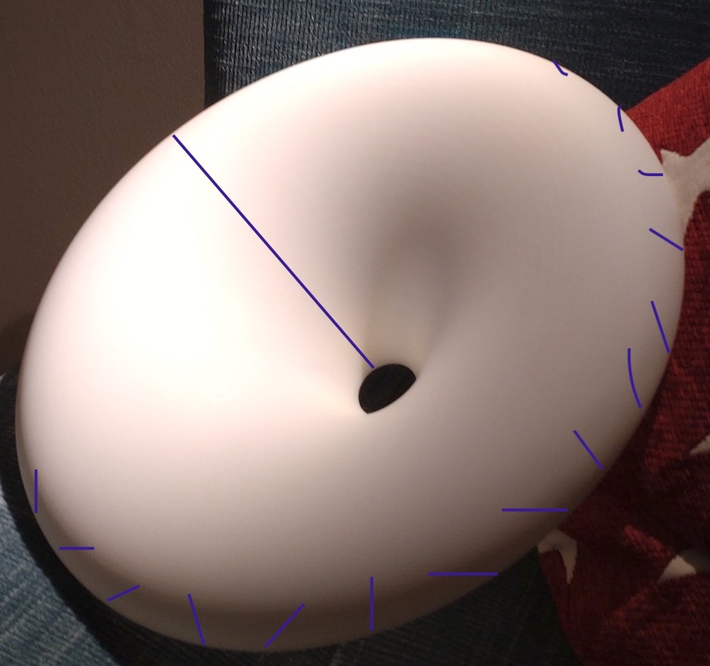

- Do the same edge treatment as on the Göbeln benders - I will saw 45 degres, maybe 2 cm cuts with a thin blade around the edge of the backroll and fill these with Sikaflex. This is to kill the reflection going form the mouth rollover edge back to the throat.
- I will make an other long cut with same thin blade all the way form the mouth to the throat to kill any energy travelling in a circular manner - this I believe is one of the primary effects of the bell shape. Cuts will be filled with Sikaflex.

I have now made more injury to the WGs. I did saw a long path towards the centre but could not reach all the way. Was to lazy to remove the red stuff. Did tape the CD exit to prevent saw dust into the driver. Also, I did incisions at the rollback edge - say 10 of them 3cm long. All these cuts where filled with transparent silicone. The difference it made kan be heard in the knock test. Both the treated (but no silicone!) and the untreated are sitting on the CD and facing upwards - knock is on rollbak part. Hear attachment.... its should be obvious which one is which 😉
The above actions made the last hints of aggression go away. Again I could lower the Fo of the x-over a couple of 100 Hz. But also has made the sound leave the speakers to an even greater extent and sometimes I get spooked of some tones coming out of them - like a high pitched organ note in the beginning of https://tidal.com/browse/track/68961758 - this CD sounds extremely clean on the Hornflowers and is a joy to consume. As are many others. Bass from this recording is also very good. Surprisingly good coming form 4" drivers and a pretty small speaker.

On lesson learned is that the "funnel" (WG) may not make any sound by them selfs whatsoever. None. Nada. Silch. If you manage this, award is plenty. The WG needs to be softly connected to the CD so not to mechanically transfer any energy into the WG.
If I do another DC/WG based speaker I will model these cuts so that it will made by the print. I see a couple of wave patterns coming from the centre going to the edge as cuts, say 1-2 mm wide. Also at the mouth, no reflections must go back to the throat - slanted incisions should be made 2-4cm long - 15 of them is probably good. All these to be filled with silicone.

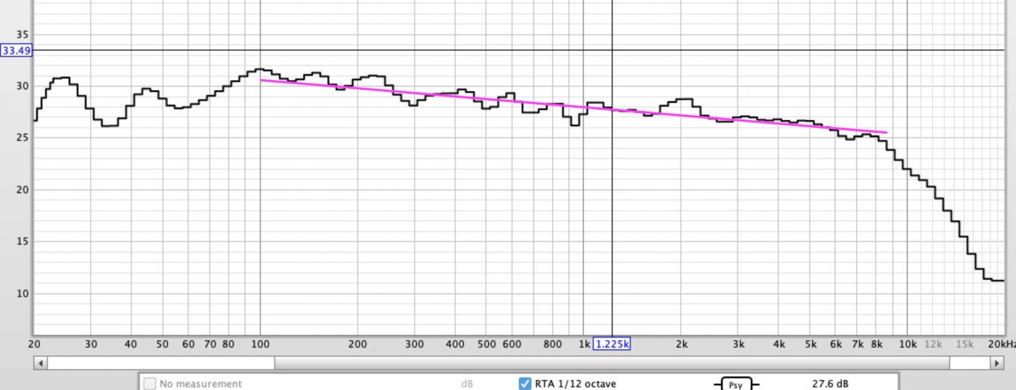

Now I'm here in my sofa and it just get better and better... 1dB/oct. A tad more and a bit of "sanding" 🙂

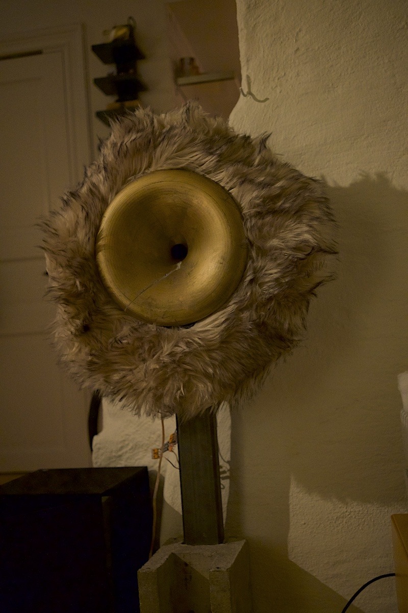

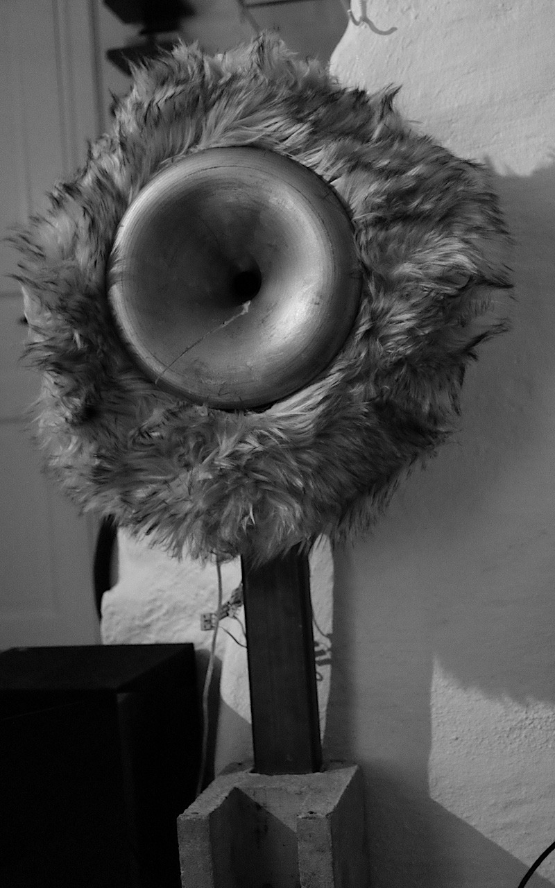

Inspired by the diffraction and backroll discussion in the ATH thread, I'll give You "Horncoyote"... or, when Chewbecca moved in ... 🙂
Either I'm crazy or this is the most important tweak I have done to the speakers. Transformation is the only word I can think of.
They became so much calmer and fuller - its spokey - is diffraction such an evil force... really.... had a hunch but I'm surprised by this.
Looks just got even more interesting I think... haute couture.... a furry mat for 25€.
Its like The Trouble with Tribbles mated with your speaker. I applaud you for ingenuity.
Yeah, looks great! 😀 there is more things changing than just edge diffraction so audible difference is probably combination of multiple things. For example output of the woofers is affected as well. Anyway, if the sound got better then why not, leave them on for the winter🙂 Are you planning to measure it?
