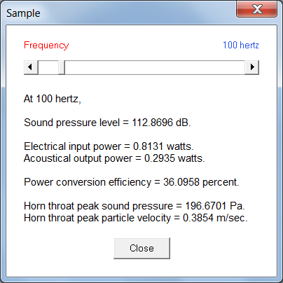

Change P = Eg ^ 2 / Ze ^ 2 * Re to P = Eg ^ 2 / Ze ^ 2 * Ret, where Ret is the real or resistive part of the complex impedance Ze.
Test example:
For the default record with resonances masked, at 100 Hz:
Eg = 2.83 volts
Ze = 9.7845 ohms
Ze phase = 6.6068 degrees
Ret = Ze * Cos(Ze phase) = 9.7195 ohms
P = Eg ^ 2 / Ze ^ 2 * Ret = 2.83 ^ 2 / 9.7845 ^ 2 * 9.7195 = 0.8131 watts

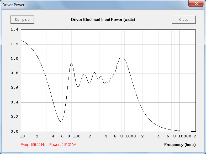

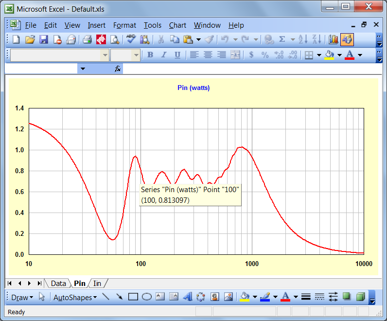

Hi LORDSANSUI,
If you are interested in investigating these issues further, loudspeaker input power and current (Pin and Iin) values are included in the "All Chart Data" export file. Assuming zero-loss speaker cables, these values will also equal the amplifier output power and current.
Attached are Pin and Iin charts for the default record with resonances masked.
From the formula quoted earlier:
We would expect P to have the same value as Pin, and Eg ^ 2 / Ze ^ 2 or (Eg / Ze) ^ 2 to have the same value as Iin ^ 2. As can be seen from the results below, this is indeed the case.
At 100 Hz:
P (formula) = 0.8131 watts
Pin (chart) = 0.8131 watts (rounded to 4 decimal places)
Eg / Ze (formula) = 2.83 / 9.7845 = 0.2892 amps
Iin (chart) = 0.2892 amps (rounded to 4 decimal places)
Note that the "Driver Electrical Input Power" chart also shows the amplifier output power, provided that the loudspeaker does not have multiple drivers, and zero-loss speaker leads are assumed.
Kind regards,
David

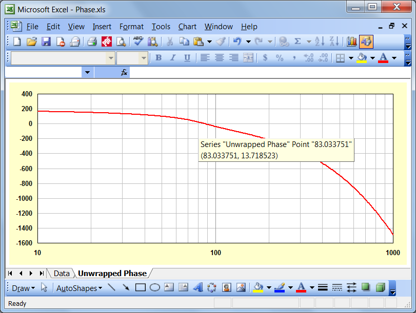

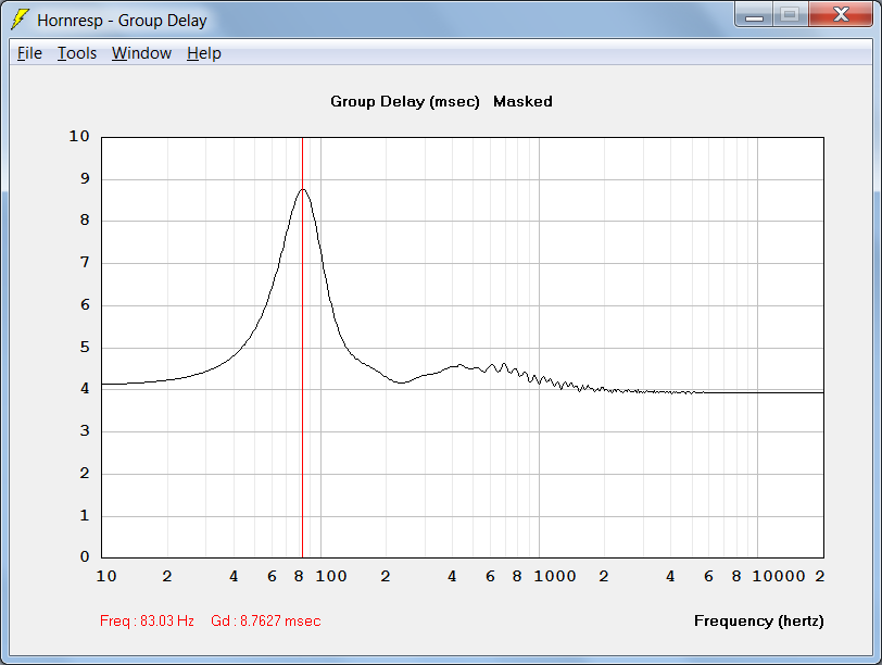

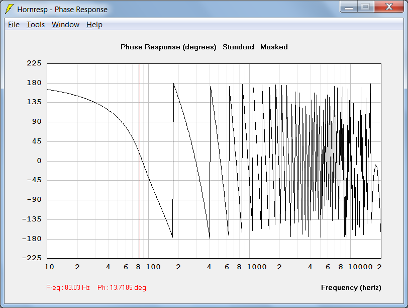

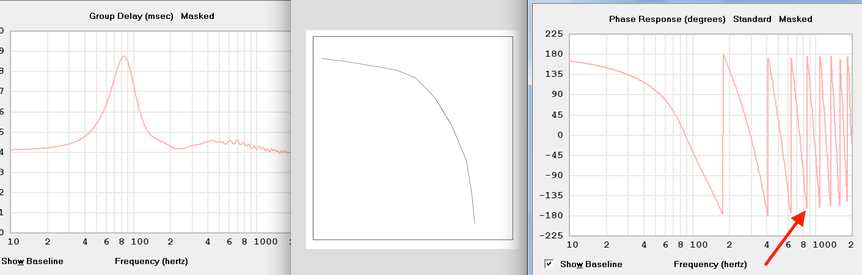

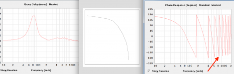

The GD is supposed to be the derivate of phase - right? In the picture, in the middle I drew and un-rolled version of the example case from above. Now, the GD is displayed as having a peak at 80 Hz but I cant see that there is something special happening with the phase around 80 Hz...
An other question about the phase chart - is it correct that the phase do not roll around but do take an extreme turn "back" before just reaching the -180 deg (at e.g. the red arrow)?
Most probably I'm incorrect in some or most of my assumptions...help me understand, please!

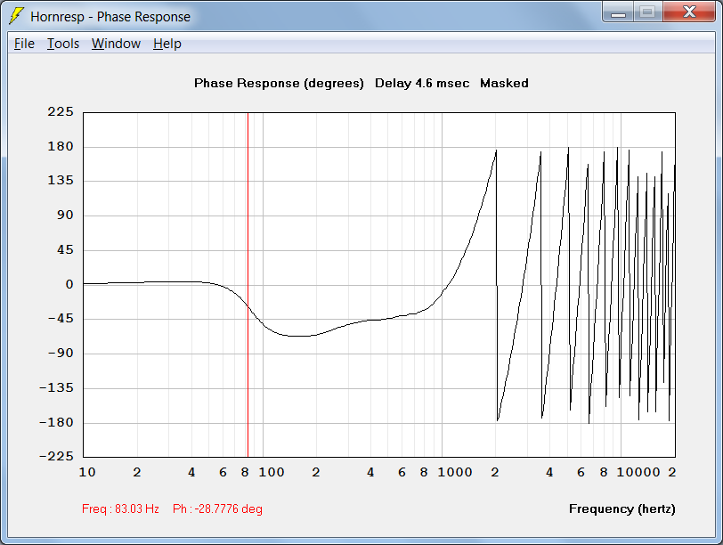

Hi TNT,
Group delay is the negative derivative of phase. It is a measure of the rate of change of phase with respect to frequency, and is positive when the phase slope is negative. The unit of group delay is time, usually expressed in milliseconds.
Notice how in Attachment 1 the phase curve goes from "curved" to "straight" at 83 hertz. The rate of change has increased at this frequency, resulting in a higher group delay. The increase in the rate of change is more apparent in Attachment 2, where a linear phase offset has been added. The inflection point in the phase curve at 83 hertz can be readily seen.
Hornresp calculates the group delay at f = 83.03 hertz as follows:
Phase at f - 0.1 hertz = Ph1 = 14.033976 degrees
Phase at f + 0.1 hertz = Ph2 = 13.403063 degrees
The frequency difference between the two phase points is (f + 0.1) - (f - 0.1) = 0.2 hertz
Group delay = -(Ph2 - Ph1) / 0.2
The units are degrees / hertz
1 hertz = 360 degrees / second
Therefore at 83.03 hertz:
Group delay = -(Ph2 - Ph1) / (0.2 * 360) * 1000 milliseconds
Group delay = -(13.403063 - 14.033976) / (0.2 * 360) * 1000 = 8.7627 milliseconds, as shown in Attachment 3.
Phase is normally shown wrapped at +/- 180 degrees, as in Attachment 1. The actual (unwrapped) phase up to 1000 hertz is shown in Attachment 4.
Kind regards,
David

Thanks!!
Information in Attachment 2 and 3 (counting from left, starting on 1) makes perfect (eeh at least some ) sense to me.
A1 and A2 is not related, i.e. they don't come from the same system - right?
If A1 and A2 is indeed describing one and the same system, what is the difference between A1 and A2?
About my last question - is it a question about drawing precision?... I don't see the wrapping phase actually touching the 180 deg. horizontal line... the 3:rd "wrap" (from left) in A2 seem to wrap at approx 150 deg?
