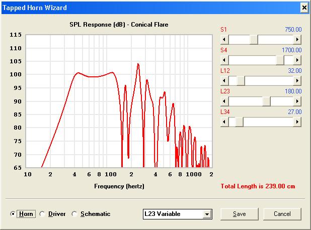

HORNRESP VERSION 19.30
Hi Everyone,
Hornresp Version 19.30 has just been released. Two changes have been made as outlined below:
1. After giving the matter serious consideration I decided not to include the voltage chart as requested by ‘MikeHunt79’. The relevant voltage value has however been added to the Maximum SPL chart Sample results. Hopefully this will be sufficient for most purposes. If required, the voltage can be sampled at several frequency points and the results hand-plotted on a graph to give an indication of how the voltage changes with frequency.
2. The Tapped Horn Wizard now has three modes of operation:
Mode 1 - ‘Horn’
Lengths L12, L23 & L34 for a three segment horn and L12, L23, L34 & L45 for a four segment horn can now all be adjusted from within the tool. The tapped horn total length is also given.
(Adjust L23 for a three segment horn and L23 & L34 for a four segment horn to change the overall horn length).
Note that the operation of the mouth-end slider (L34 or L45) has reverted back to its original direction, with values increasing from left to right. All sliders are auto-ranging.
Mode 2 - ‘Driver’
Driver parameter values can be adjusted from within the tool. This comes in handy when trying to identify an optimum driver for a given tapped horn design. The equivalent Thiele-Small parameter values are also given (highlight any T-S parameter name in the combo box then use the up and down arrow keys to change the displayed result).
Operating in the ‘Driver’ mode makes it obvious just how sensitive tapped horns can be to even quite small changes in driver parameter values.
Mode 3 - ‘Schematic’
Changes to the horn dimensions and driver position can be immediately seen in the ‘real-time’ axisymmetric diagram. The overall system volume as requested by ‘iand’ is now also given. The schematic diagram makes it easier to understand how the three ‘length interaction’ modes work.
To summarise:
Ang, Eg, Rg, Nd, Vtc, Atc and the flare type/s are now the only input values that need to be fixed prior to selecting the Tapped Horn Wizard. All other parameter values including those for the driver, can be adjusted from within the tool, and changes to the SPL response and schematic diagram observed in real-time.
I hope that you have as much fun using the new Tapped Horn Wizard as I have had in getting it to work properly 🙂. The internal operation of the tool is now rather complex and even though it has been extensively tested there are probably a few things that I have missed. Please let me know if you do find any bugs - thanks.

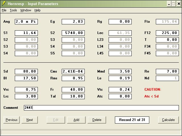

2" driver
Did a model of JBL2441 based on JBLs data and my measurements of Le, Re and Fs with the backcover removed. Also calculated Vas to be 2,2 dm2.
These are the graphs for a horn with parameters choosen to get the flare of the 2441s throat to correspond with the flare of the horn.
Could this model be accurate enough for use up to 2kHz?
