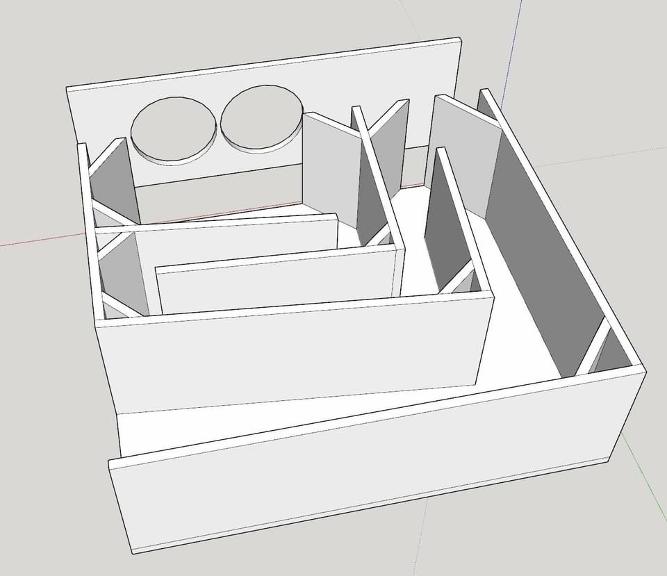

Mark, do you use corner ‘deflector’s’??
Reactions: 1 user
That depends. If I am doing a back loaded horn where I want as little midrange as I can engineer out the answer is no corners. No corners seems to help cancel out a lot more midrange. If I am hoping for a wideband system yes, do the corners. Devilish they can be. The first horn I built was the Mau horn, for a fullrange 6.5 driver. That was 1994. All reflectors all over the place. If I was to do something similar now I would not use one corner! And I would properly size a coupling chamber and probably line it with rockwool to act as an absorber. Last trick I use is exit out the rear of the enclosure. If you are against a wall you have a lot better loading and a lot less ripple. So design it in 2Pi in Hornresp, and then in the real world you place it is 1 Pi perhaps 0.5 Pi over a limited frequency bandwidth when you consider North American timber construction and you get a rather nice response.
