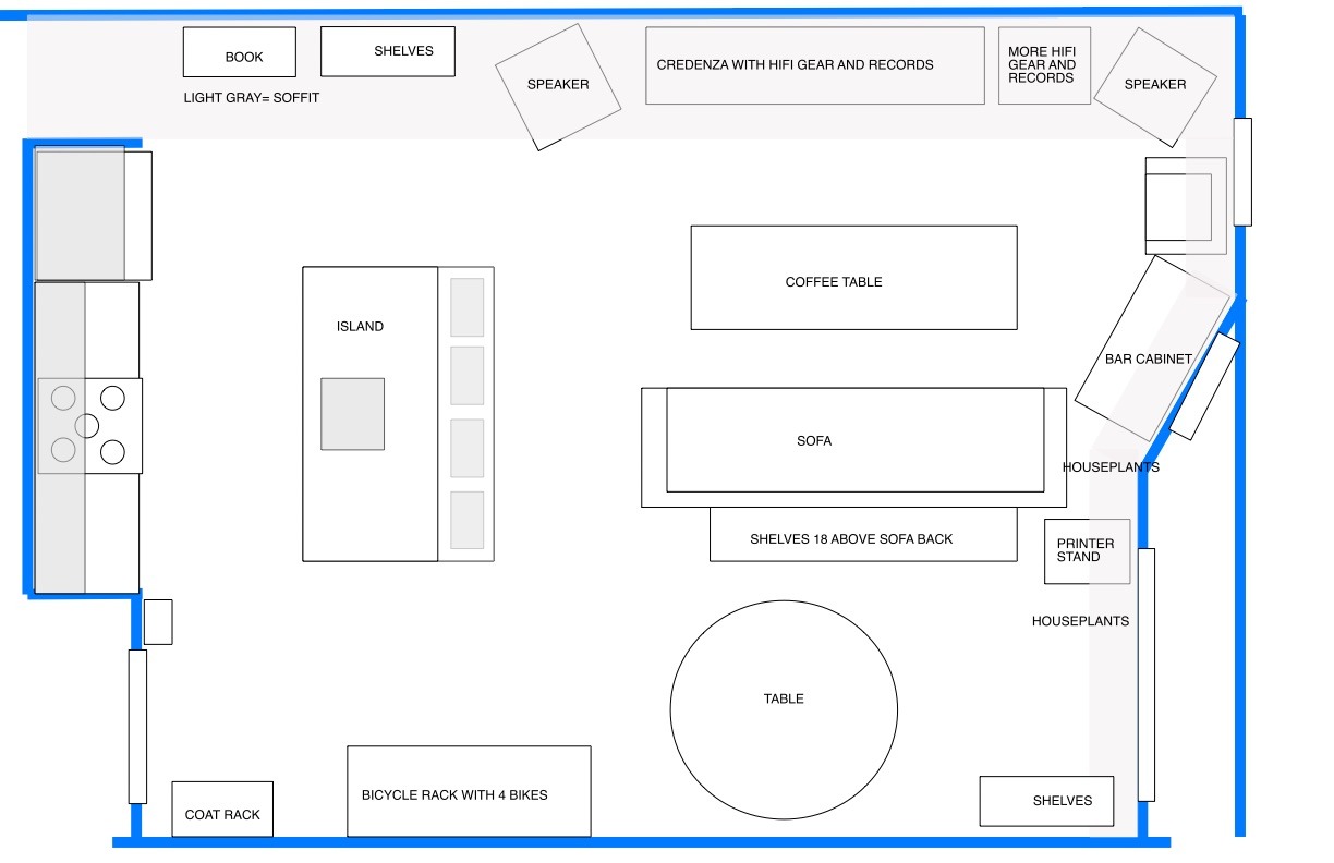

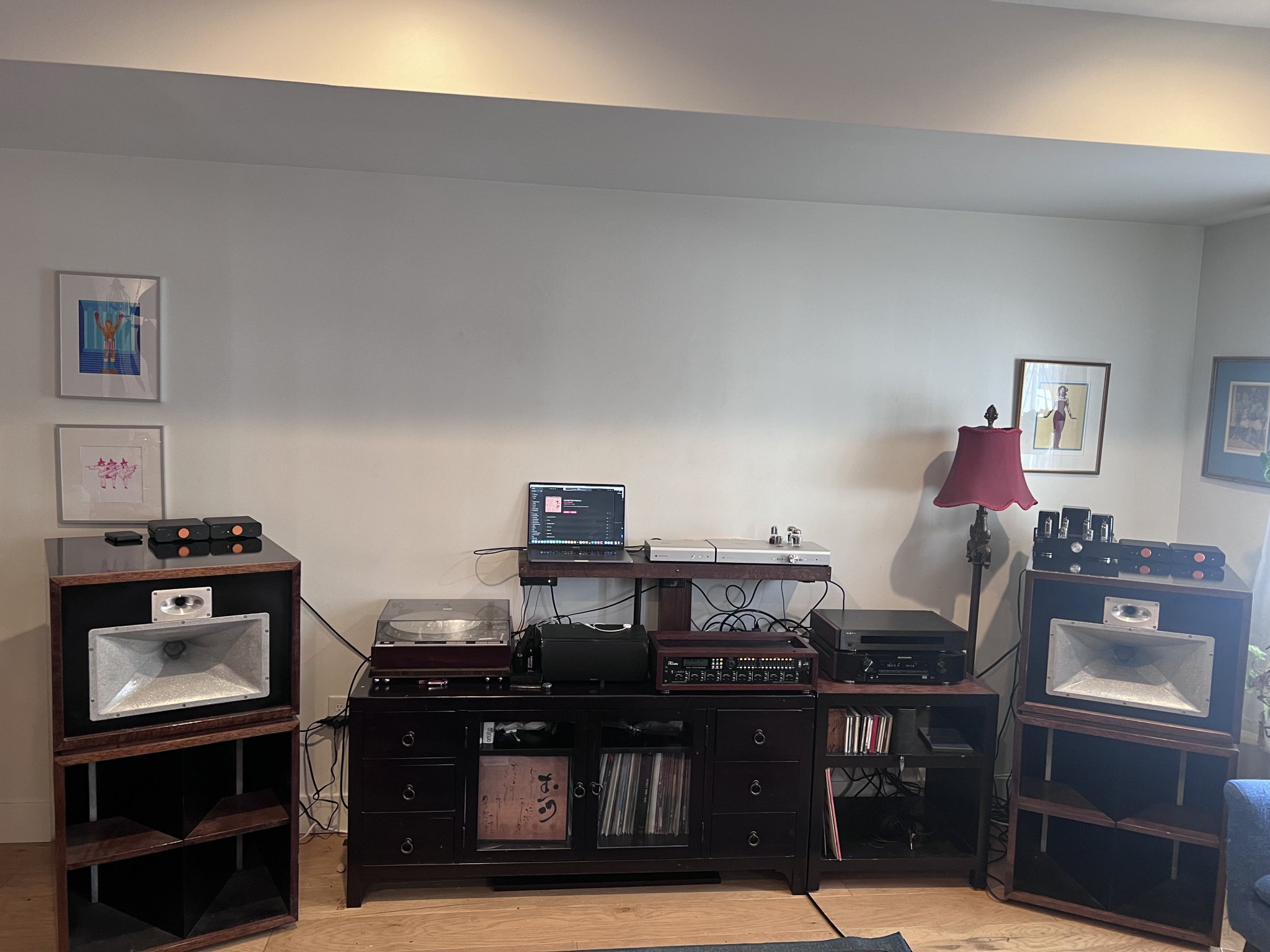

I'm getting close to having my system dialed in, which brings me to the final frontier: tuning my room.
my listening room is in a smallish, 1500 sf condo and comprises my kitchen, living room and dining area. The room itself is about 16" x 24", the seating area where my system and sofa are is about 12w x 10" deep, with the dining area directly behind it and the kitchen to the left, as well as the main entry. I don't hear any prominent echoes when I clap my hands or snap my fingers, but the spectrogram tells a different story.
further complicating matters, the blank space above the credenza is a projector screen, so it can't be easily treated and the wall to the right is irregular and approximately 60-70% windows, with sheer curtains and blackout shades. how may I best treat my room to reduce reflections? my speakers, which resemble Klipsch LaScala, have passive radiators mounted on the back of the upper horn enclosures, extending the bass to 23Hz- intuitively, I'm thinking bass traps and diffusers behind and above the speakers and heavy rugs in front of the speakers; am I on the right track?
would mounting diffusers in the RH corner and above the L speaker, such as the one below, help?
I could also install bass traps directly behind the speakers. Unfortunately, we rent, so treating the ceiling is not an option and WAF is also a consideration, as are budgetary constraints. That being said, what are the best bang for the buck options, assuming I have more than adequate woodworking skills (I'm a master carpenter and former cabinetmaker; I engineered and constructed my speakers and make my own furniture).

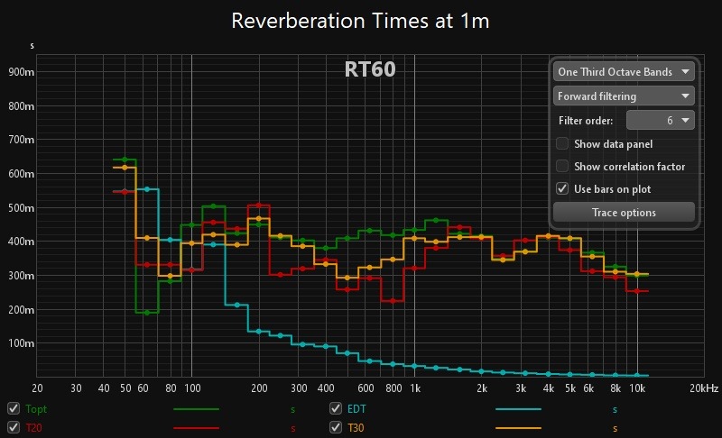

I'm a little surprised that no one has mentioned that your REW measurements will tell you a lot already (and I apologize for just finding this thread).I'm getting close to having my system dialed in, which brings me to the final frontier: tuning my room.
Some candidates are below:
The "RT60" plot will tell you about the relative amount of absorption in-room that's effective. The plot above is from my listening room with the microphone one metre in front of the right Jubilee and centered on the K-402 centerline. Notice the relatively flat Topt and RT30 curves (the green and yellow-orange traces). These tell you if the total amount of absorption in-room is about right, or, as is more likely the case, you need to add a bit more.
For your listening room of about 3000 cubic feet (assuming your ceiling is 8 feet), an average RT value in the 300-10000 Hz range will likely be ~0.3 s to 0.4 s. The flatter these RT curves are, the better.
If there is insufficient absorption in-room, usually there will be a significant rise in RT values around 1-2 kHz. Just buy some Roxul absorption (something made from laundry lint) to add to the nearfield wall areas just around the bass/midrange horn mouths. You can pin 2' x 2' squares of the 1" material to the walls using T-pins without leaving a significant mark on the walls. I just added a bunch of 2' x'2' squares to the front wall, then began subtracting them symmetrically from the farthest locations around the loudspeakers, until I began to see the RT curves and ETC curves begin to change.
The asymptotically decreasing EDT curve (light cyan trace) tells you that your loudspeakers are doing yeoman's duty keeping early acoustic reflections off the walls of the room. Perhaps more on that subject later.

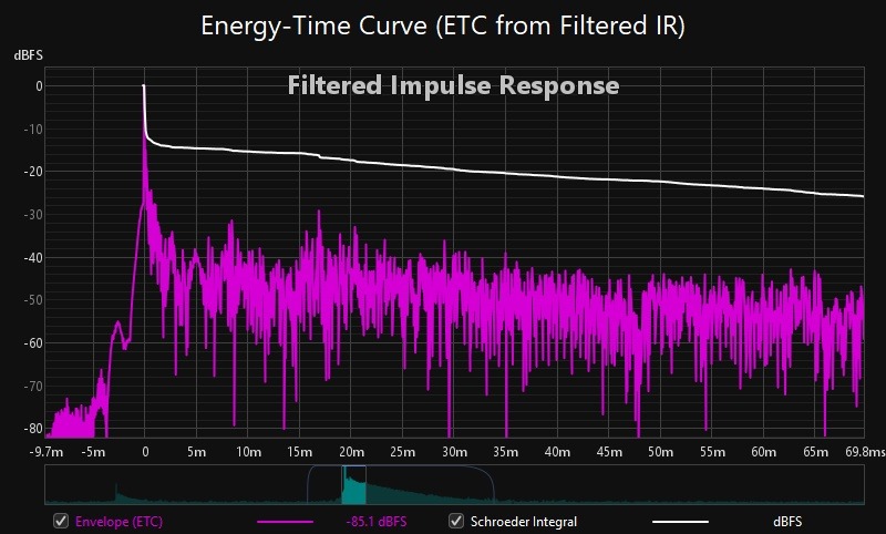

Another plot to look at is the energy-time curves (ETC) from the "Filtered IR" plots within your measurements:
This plot tells you if you've got any large reflections from just around the loudspeakers (i.e., the first 5-10 ms around the loudspeakers), and also tell you if you've got strong reflections arriving from the sides or back of the room (including ceiling and floor bounce). With fully horn-loaded loudspeakers, you will see this immediate drop in SPL within the first 2-3 ms of the initial impulse response (which is very good and is what you want), which is another way to see the fully horn-loaded loudspeakers keeping early reflections off the room's walls and ceiling. The measurement I used was accomplished using a thick absorption pad on the floor (about 2m wide between the loudspeaker and the microphone) to catch the floor bounce.
Remember that the total delay times include the total path length of sound from the loudspeaker, to the reflector(s), then back to the recording microphone. If you draw a plan view of your room's layout, you can see these primary reflections from the axial modes of the room and even the strongest tangential modes (i.e., multiple reflection modes) coming back to the microphone.

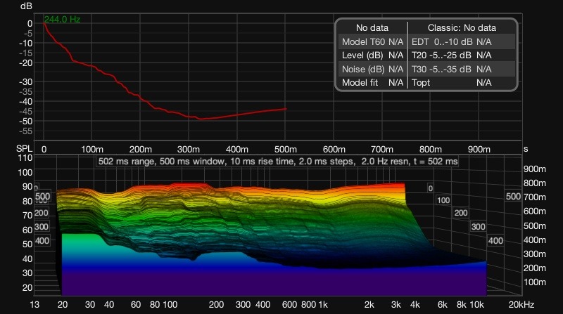

The last plot I'll show is a more recent addition to the REW library--the RT decay plot:
As you can see, this plot is a bit more involved in terms of what you can see. In general, what this plot tells you is finer grain room decay information--especially at lower frequencies.
I'll leave this graph to your imagination for now, but note that there is a great deal of information about your room's acoustics that's displayed here.

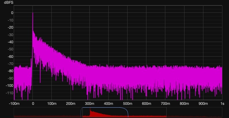

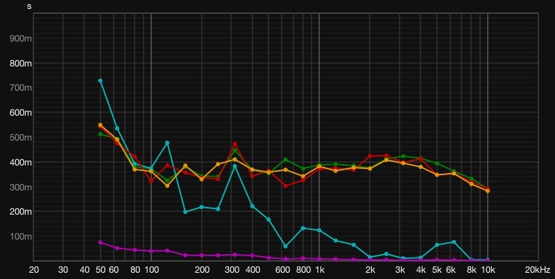

Here is my RT60 plot:
my Energy Time Curve:

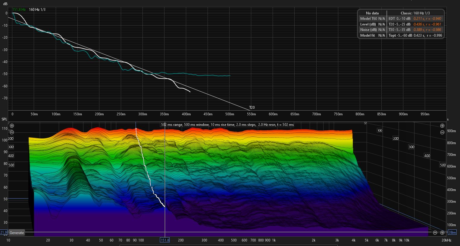

and finally, the RT Decay plot:

so here's what it looks like from the MLP (yes, I need to do some cable management):

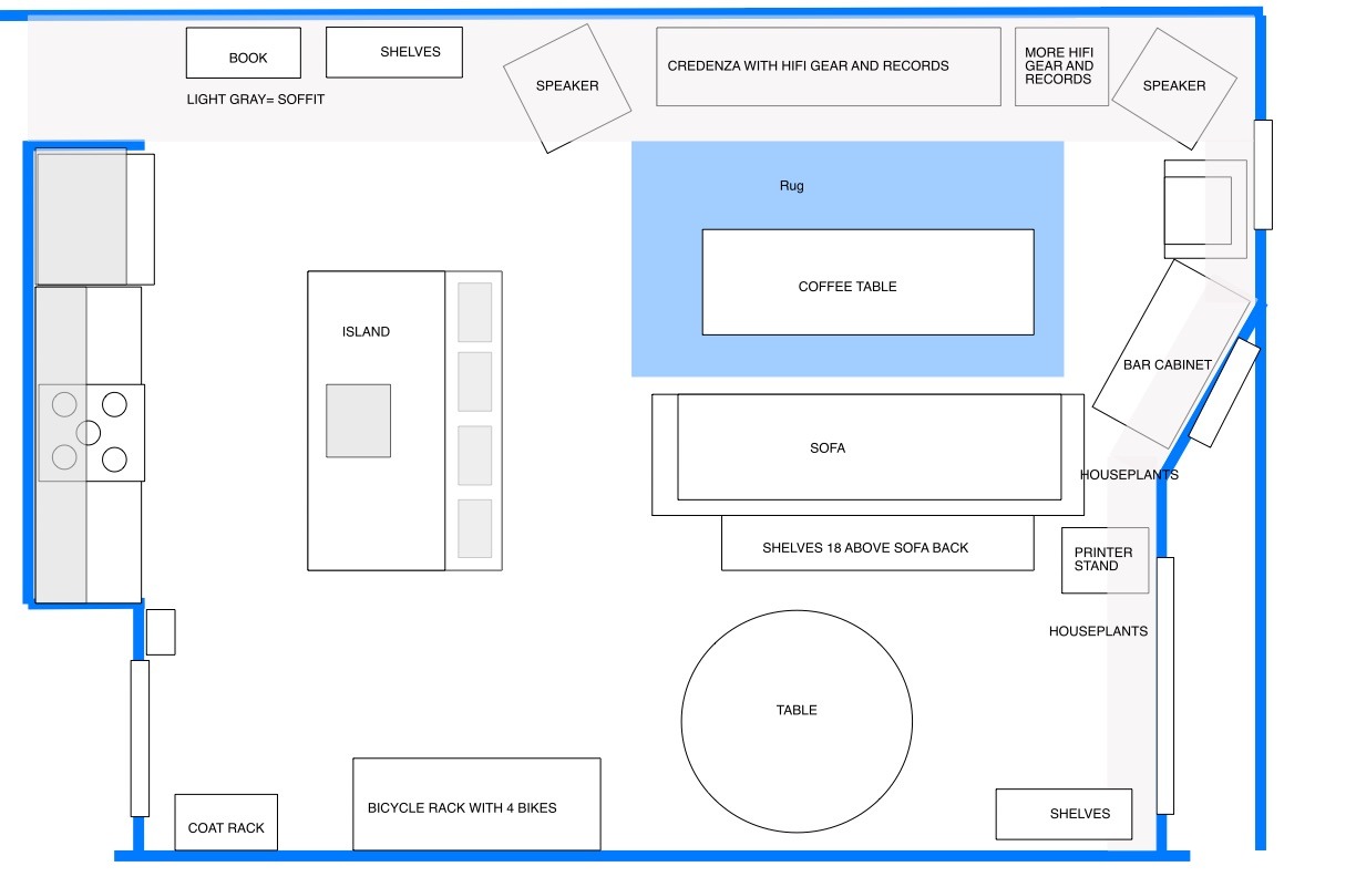

and here's my room layout, mostly to scale:
The RT60 curve looks pretty good already, so you seem to have a requisite amount of total absorption in-room. Adding more absorption to your room will likely only make it feel smaller. Also, it appears that you don't really need a lot more diffusion from looking at your hand-drawn floor plan view. You seem to have plenty of furnishings that provide that duty already.
I can say that the coffee table will affect your imaging, unless something that's quite absorptive is laid across the entire top of the table to eat those early reflections. I recommend trying listening to your setup, but with that coffee table moved out of the way entirely, then have a critical listen for imaging and soundstage size. The bar cabinet, to the extreme right, will also affect the soundstage and imaging if it is acoustically reflective. It looks to be too close to the right-side listening position on the sofa
Moving your loudspeakers out in front of the credenza a bit more might also strengthen the phantom center imaging (strongly).
The filtered IR (ETC) curve looks like both axes of the plot are zoomed too fare out (and once again, I'm asking for a much more zoomed-in plot). This may be a function of the print utility within REW. If you can't get the axes to stay at something like 70 ms full-scale horizontally and -80 dB full-scale vertically using the print screen function within REW, then I'd recommend first zooming in both axes manually, then taking a screen shot with a separate screen shot utility. I use "Snipping Tool" that comes with Windows--but I don't know what screen shot utility comes with a Mac (as I presently understand that you're using).
It appears like you have some irregularities in the ETC within the first 70 ms, but it's zoomed so far out that I can't really read it, especially the horizontal scale--by a factor of 14(!).
The RT60 Decay curve looks like you've got a lot of reverberation below ~40 Hz. This is quite difficult to do much about, since a wavelength of sound is ~28 feet at 40 Hz. You'll need a bass trap that's at least 7 feet long to do much about those frequencies (a 1/4 wavelength tube trap, that is). You could try to lay down a couple of flat Owens-Corning 703 or 705 panels end-to-end across the boundary of the back wall and the floor, with one end against a corner or blocked off by the end of a bookcase, and the other end open to air. This will be effective down to ~30-35 Hz.
The rest of the spectrum below that frequency will be pretty much undamped, however. This is probably a consequence of the smaller total room volume (i.e., room size) that you have. This is a problem that almost everyone with a nominally sized home listening room has. Most people tend to ignore this region of the audible spectrum, since it's represented by 5-string bass (electric) or a bass "E" string extension on a double bass, and the main impulse of a kick drum. Having a listening room with a long dimension approaching 30-40 feet is the most effective way to control RT60 times below 40 Hz, in my experience.

here's a better ETC:
I apologize, I'm still learning how to optimize REW and letting it show me the default charts, simply because I don't really understand what I should be reading or how to get that, but thanks to your cajoling and advice, I think I'm slightly getting a better hang of it.
I moved the speakers out so that they're about 8" in front of the credenza and pushed the coffee table up against the credenza, the best I can do in this tight space. It did improve the imaging and phantom center quite a bit, but ultimately, it's not a sustainable situation for WAF, but for listening sessions when I'm home alone, it's doable. the rest will be tricky, as the back boundary wall is bare to serve as a projector screen.
That ETC looks pretty good.
