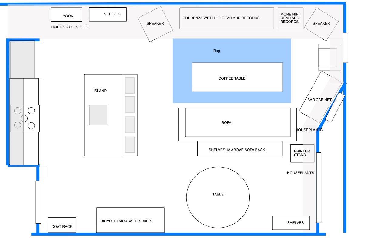

Your reverb curves are not bad. You have a problem around 300Hz and a rise in the 2-5kHz area - the most sensitive area of the ear. And of course the high frequency fall off. Low frequencies are pretty good - american light walls house?
So the first goal would be to lower the over all reverb - BROADBAND! So only use deeper absorption - don't use any if that's not possible.
There are so many places where you could add absorption! Corner wedges are efficient for what you need (lower reverb >80Hz) and you have a lot of possibilities around your ceiling to install something there! Use the area behind your speakers and esp the corner of your right speaker. Put something to the shelves behind your listening postion!

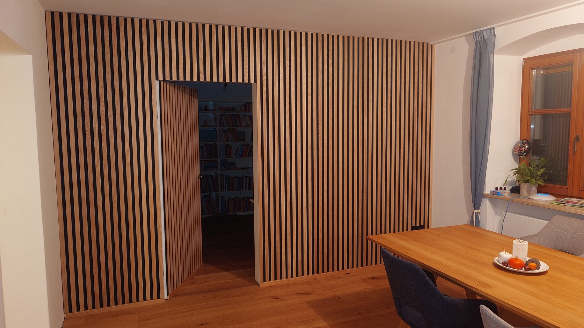

You can make complete walls out of these wood stripe panels in all kinds of colours. Even hide doors with them. Or just use white fabric to cover stuff. You can just enlarge the soffits, fill the corner with absorption and wrap white fabric around. Add some soft LED lights for some benefits for the room.
It takes some creativity but your whole space and life will benefit from better acoustics!

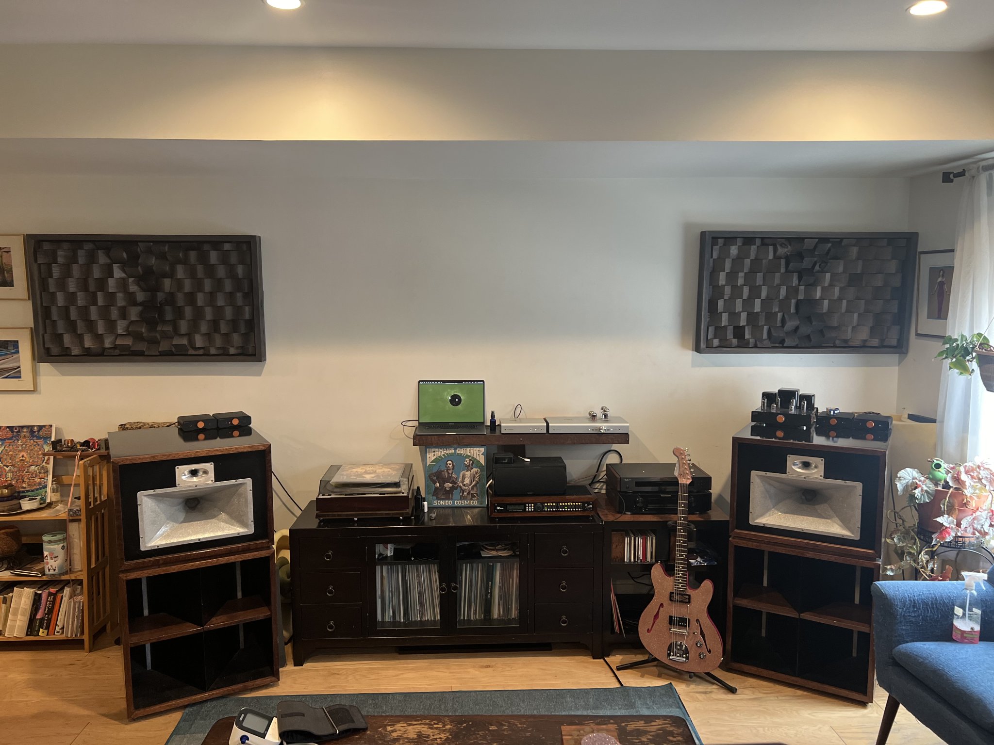

The main thing is that you have obviously done something, whether intentional or not to make your room better than most.
We see too many great systems posted here in rooms that look like echo chambers. Yours is better.
Chris has made some very good suggestion for small tweaks to what you now have.

The mid horn (PRV Audio 18”w x 10”h WG45-50) and driver (PRV D2200PH) drop precipitously at exactly 400 Hz, so I’m not sure what’s going on with the loss of directivity control, unless it’s something endemic to the LaScala bass bin, which in my case, is driven by a JBL D2225H.Sometimes these room-acoustics related plots tell you more than just information about room acoustics. In this case, it appears that the crossover transition band between the bass bin and the midrange horn could be a bit wide or even perhaps a bit too low in frequency for the midrange horn to continue to control its vertical polars.
Recall that I said that the loudspeakers were doing yeoman's duty keeping early reflections off the nearby walls, above. In this case, it looks like the midrange horn may be losing its polar control around 320 Hz and is putting a bit more nearfield energy into the ceiling/floor than might be desired.
If you get a chance, you might try moving the crossover point up perhaps 50 Hz by tweaking your PEQs--then looking again at the RT60 plot (particularly the peak in the EDT [early decay time] curve) to see if moving the crossover point up a bit starts to smooth out the peak in the EDT curve at 310-320 Hz. This will likely result in a pretty subtle shift in the overall sound quality, but you should be able to hear a bit more "damped" room response across this low midrange band, perhaps a bit smoother and more consistent in terms of vocal timbre or other low midrange instrumentation.

My next measurement session will be to focus on the left driver and tune that as needed. I’m curious how that reads with the lack of a corner. I’ll be sure to move the coffee table out of the way to rule it out as a source of reflection
Usually, the reason for a precipitous decline in SPL on-axis on the low end is because the horn completely loses directivity control. In straight-sided horns (like the one you've got), this occurs typically at the frequency where the longest dimension of the horn mouth corresponds to a half wavelength of sound. For your 17.71" x 9.84" mouth dimension horn, that occurs at about 400 Hz (if you subtract the mouth flange width).The mid horn (PRV Audio 18”w x 10”h WG45-50) and driver (PRV D2200PH) drop precipitously at exactly 400 Hz, so I’m not sure what’s going on with the loss of directivity control, unless it’s something endemic to the LaScala bass bin, which in my case, is driven by a JBL D2225H.
That doesn't mean that the horn is putting out nothing at 400 Hz...rather it means that the horn isn't putting out much on-axis, but instead the horn is putting out almost all its output into an almost 360 degree polar pattern--in both axes (vertically and horizontally...as long as the driver's diaphragm remains acoustically loaded). So if you raise the crossover point a little, you might be able to avoid that energy being deposited all over the room--nearfield.
The La Scala "W" section bass bin polars only get narrower, somewhat slowly, as the frequency rises above 400 Hz. Since that bass bin doesn't have a truncated mouth like the Belle, it actually behaves quite well at higher frequencies and doesn't collapse down its directivity pattern as much as the Belle, Khorn, and Jubilee bass bins experience. So the La Scala bass bin should handle a slightly higher crossover frequency quite well.
Chris

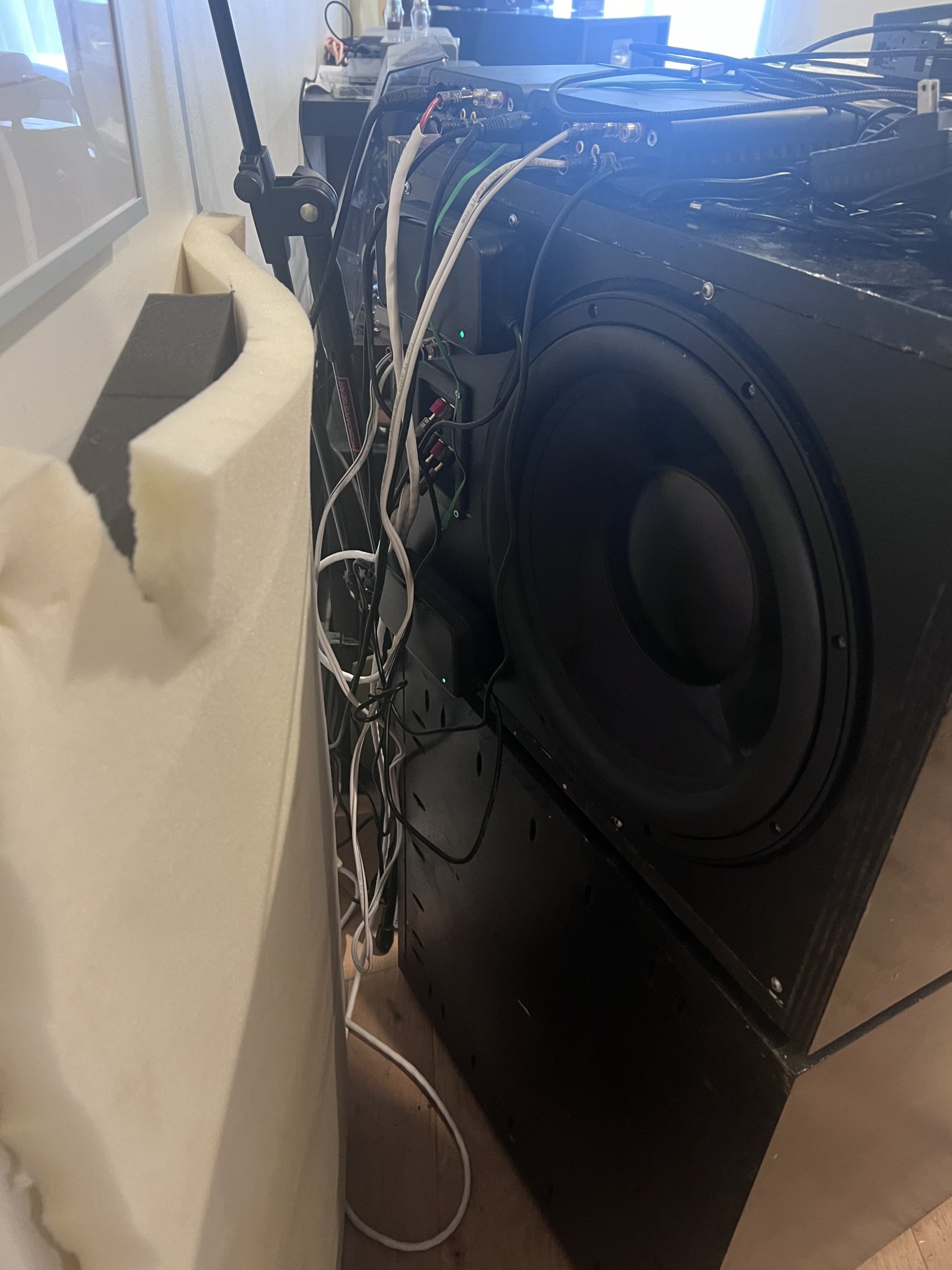

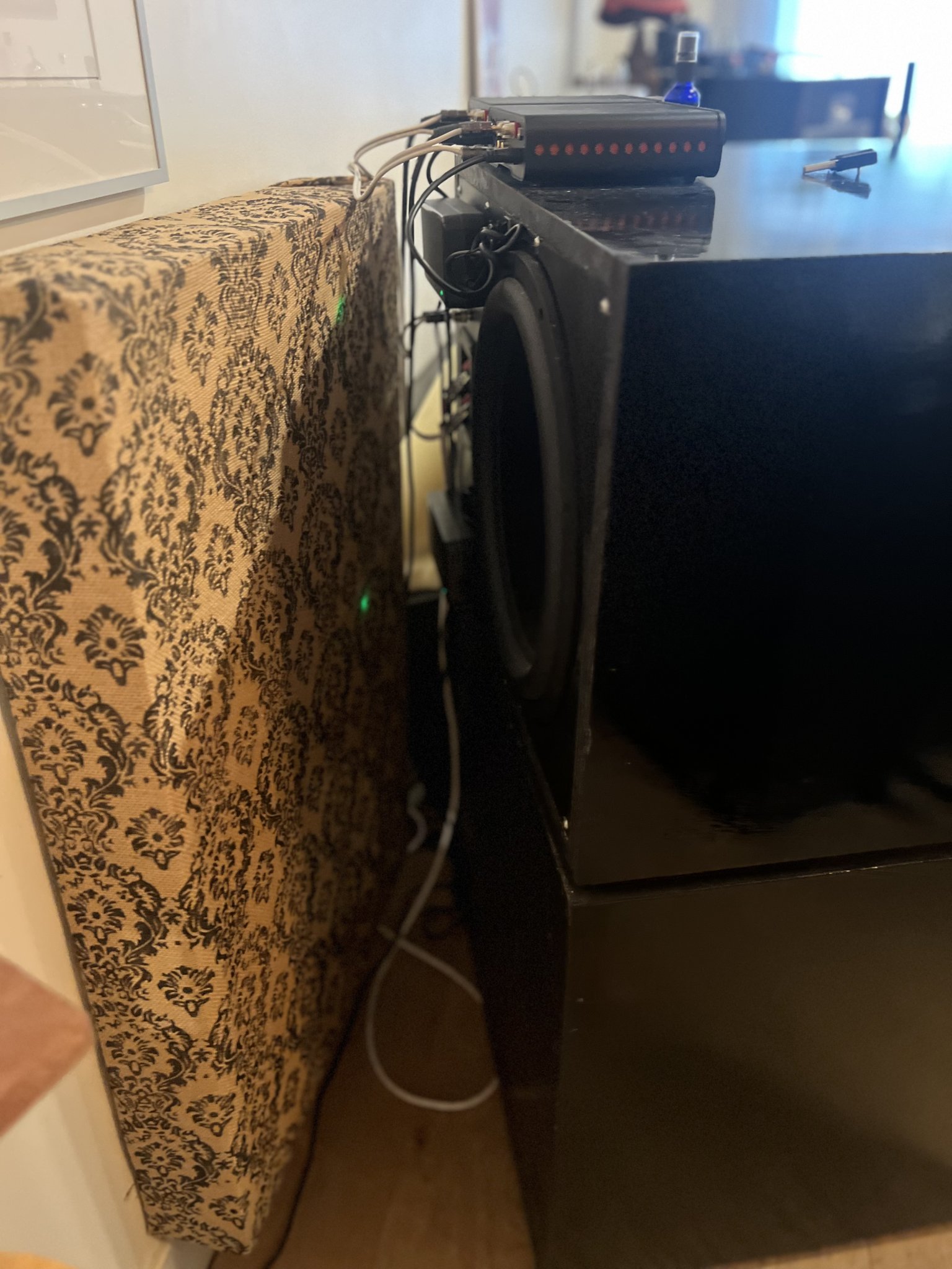

Rather than just buy stuff, I thought I’d do a test with stuff that I had on hand, before I threw money at a solution that may or may not work. I had a sheet of 1-1/4 memory foam and some 3” foam blocks that I tacked up in the right corner and behind the left speaker. I didn’t really expect it to make much of a difference, but much to my surprise, the bass seems tighter and there seems to be additional improvement in imaging. Measurements to follow.
It looks like I may be building some bass traps sooner than later.

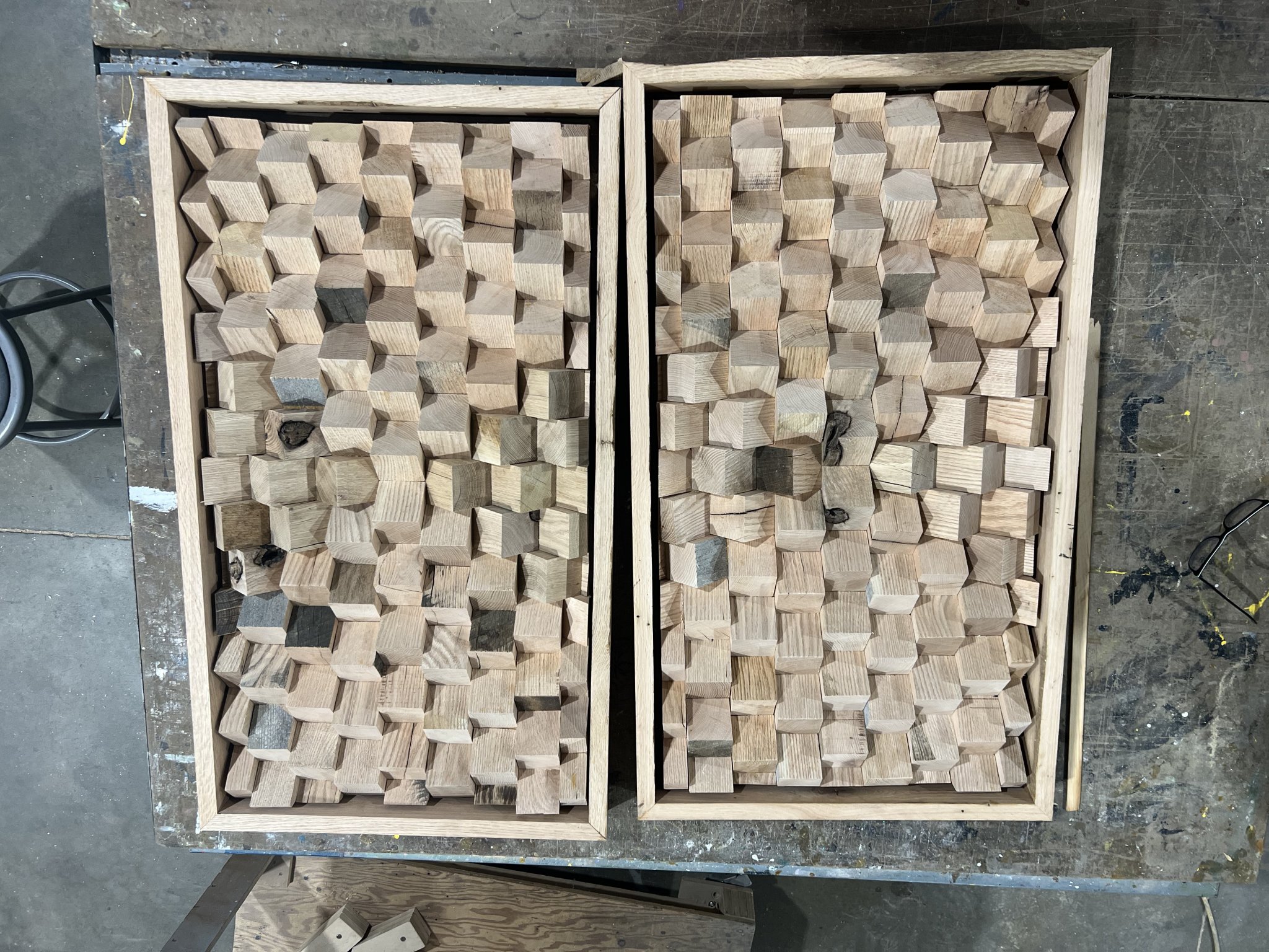

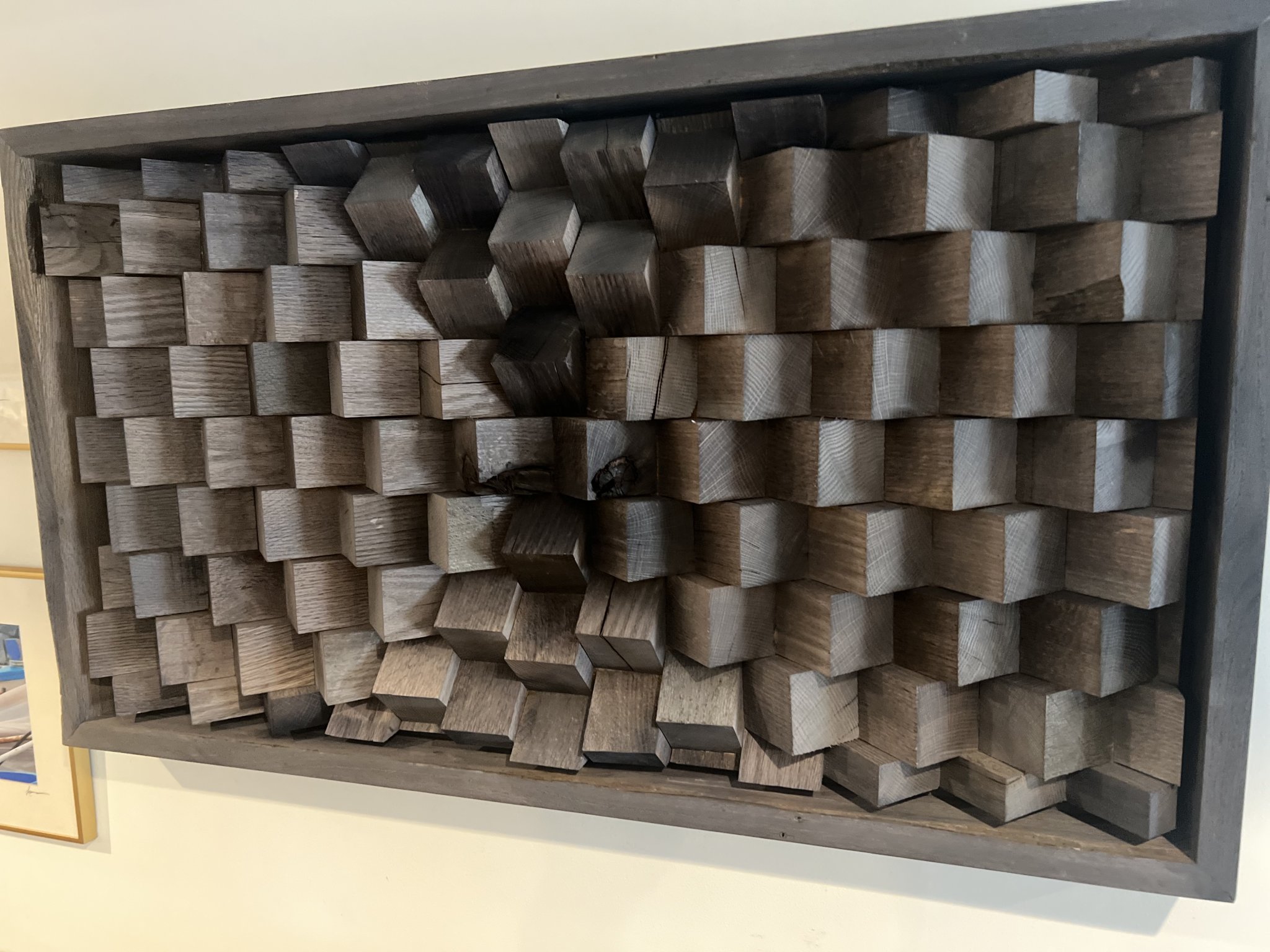

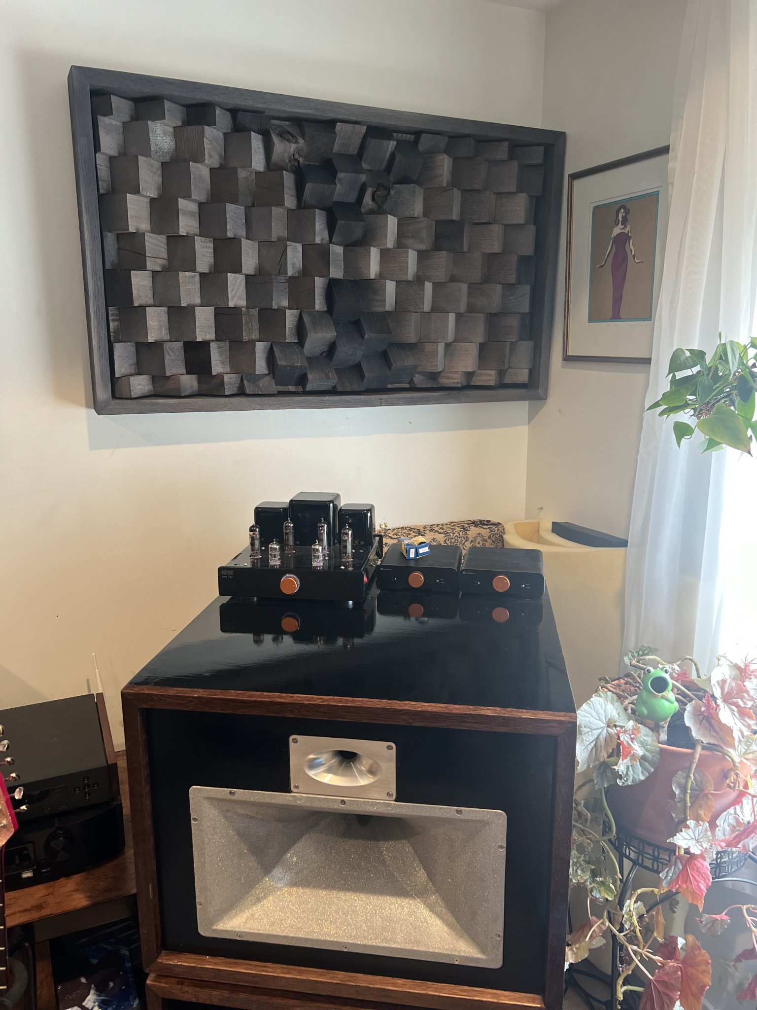

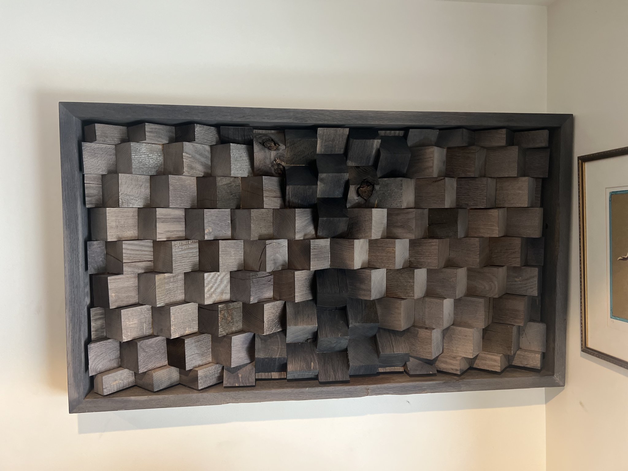

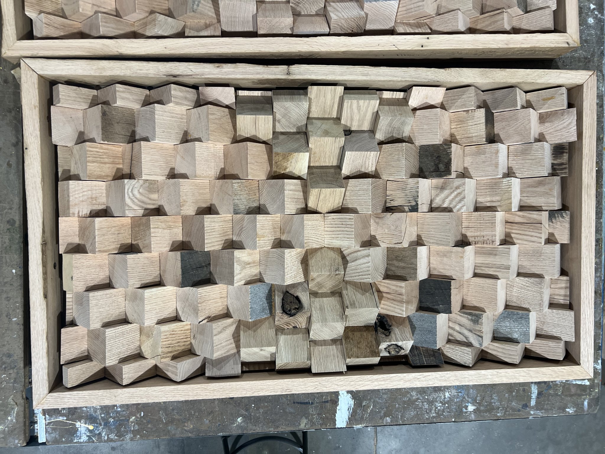

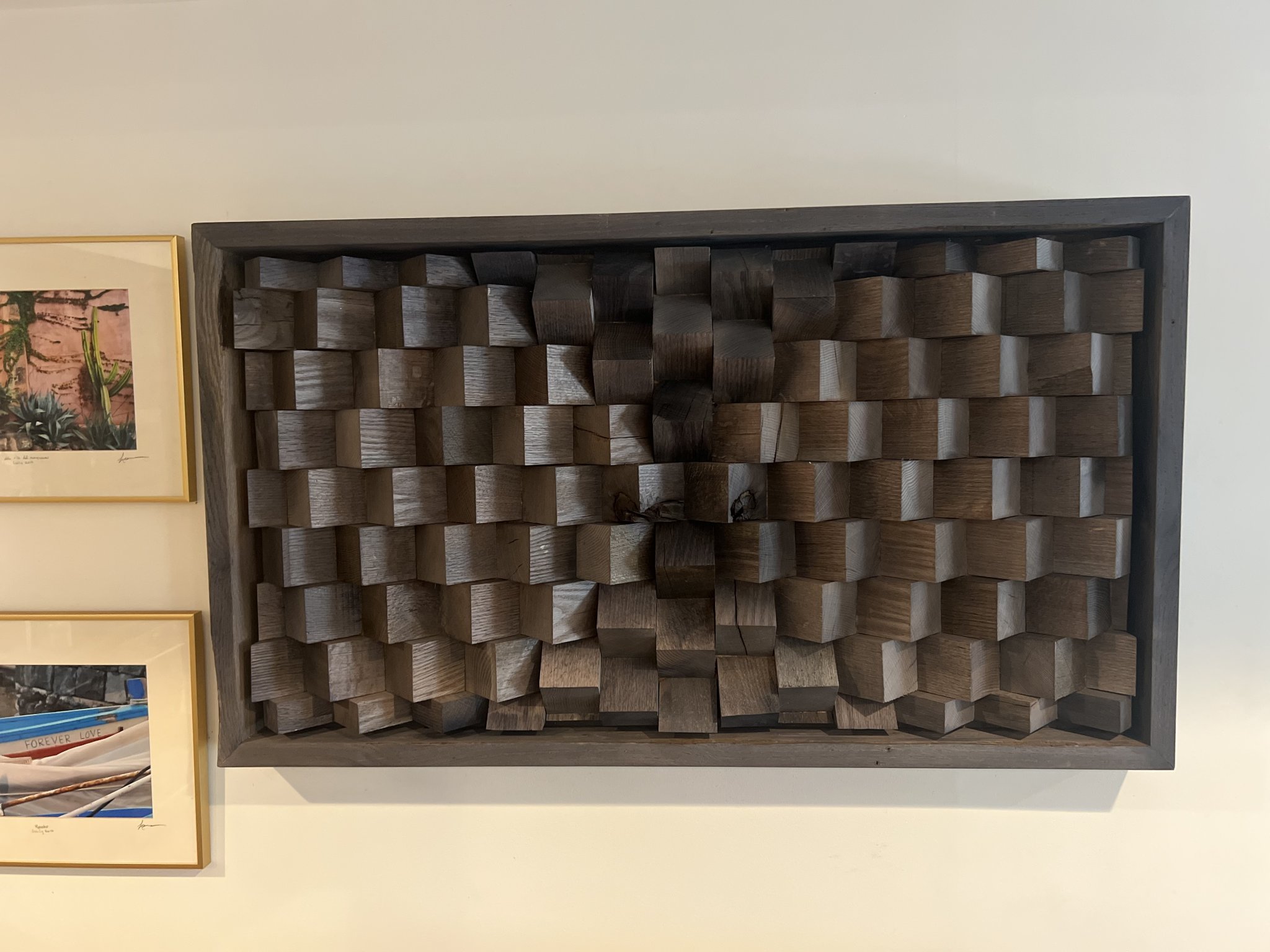

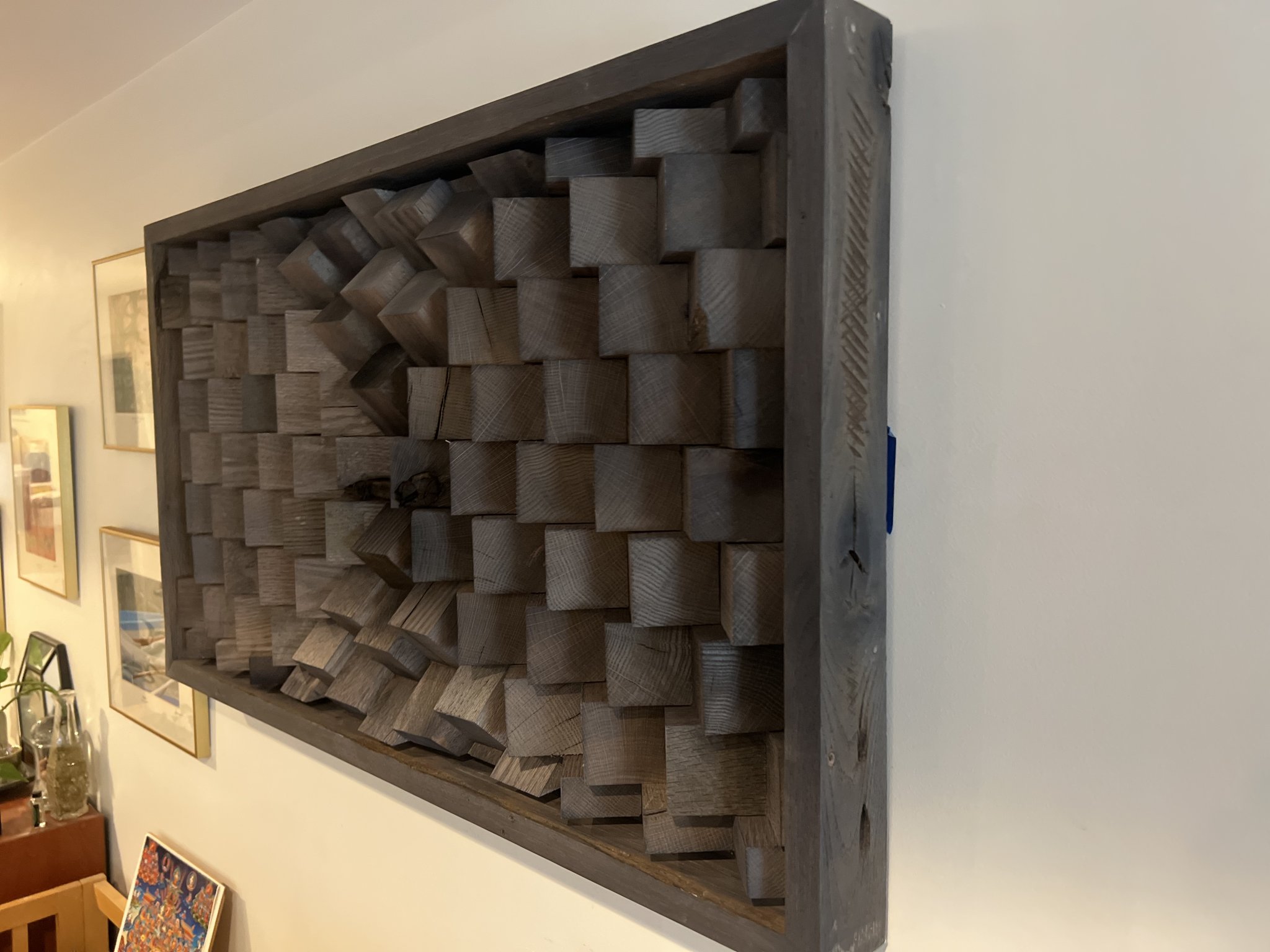

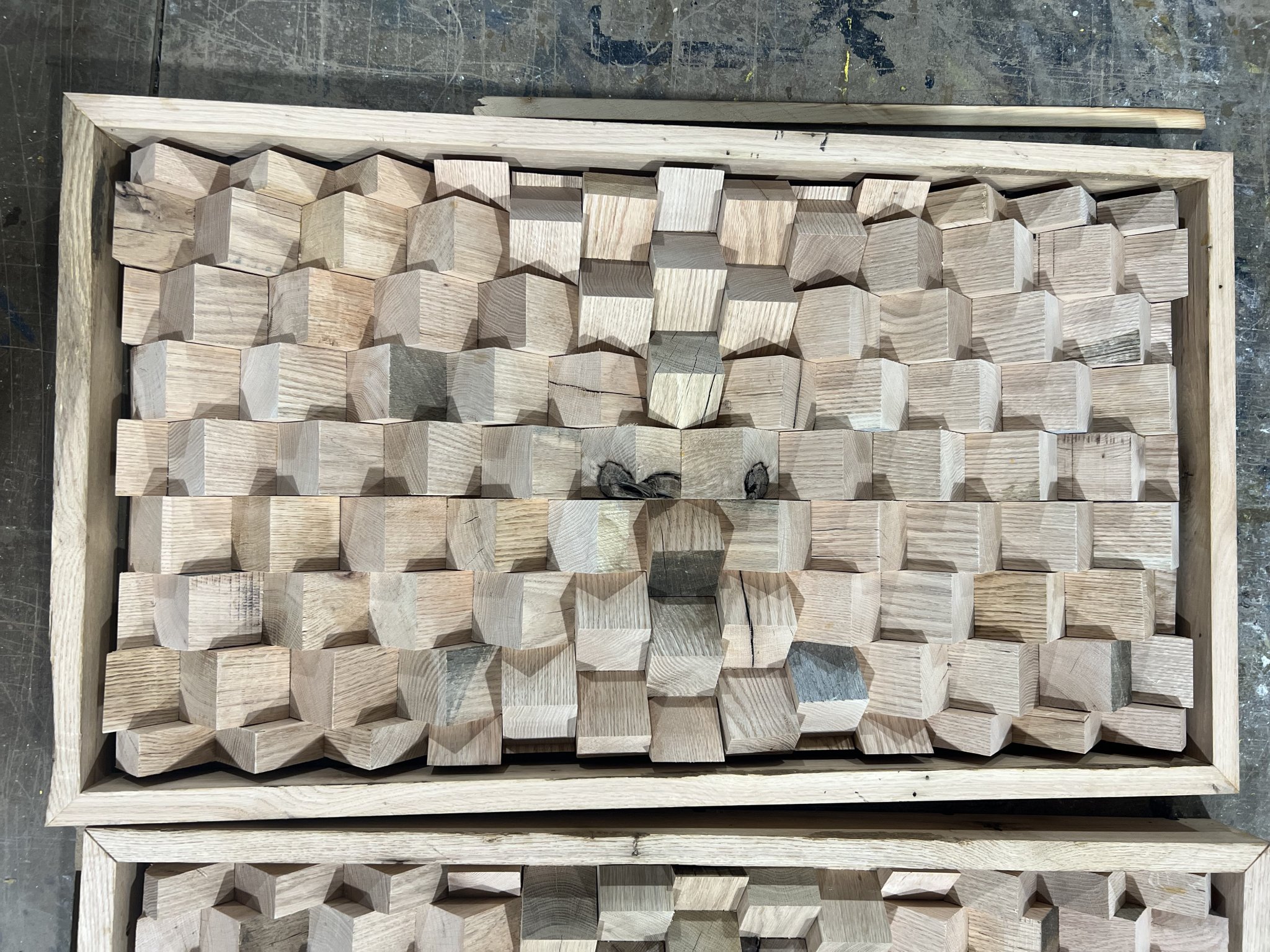

slow progress, but I've made some diffusion baffles for the blank wall space behind & above the speakers.
I'm making them from white oak, salvaged from a 230 year-old farm house. I still have to sand and finish them, I'm thinking I'll use a stain that brings out the tannins in the wood and makes it look old again. I also have frames made for a pair of bass traps (I still need to make a third); I hope to get them done this weekend, provided I can find a supplier of Owens Corning 703, locally. I'll cover them with a fabric that's somewhere between burlap and linen. I showed the photos to my spouse and told her that I'm "making art again" and her response was to roll her eyes and proclaim "it looks like speaker stuff to me." She's been pretty supportive of my hobby, but I can tell I'm pushing the limits of WAF pretty hard. That said, I have a pair of 24" x 24" x 44" horns in a 1200 sf inner city apartment; I'm doing pretty good.
Sorry to dissapoint you ... but this diffuser will only work in the region of 7000 Hz an upwards 20000 hz.The wavelength of 1000 Hz is 34cm
and at 100Hz it is 3.4 meters. so if you want to diffuse lower frequency the features needs to be bigger. Try to build BAD panels instead!
Faster, more effective, cheaper....

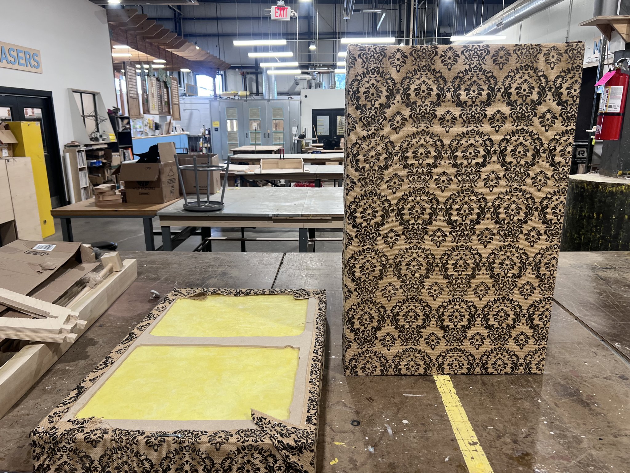

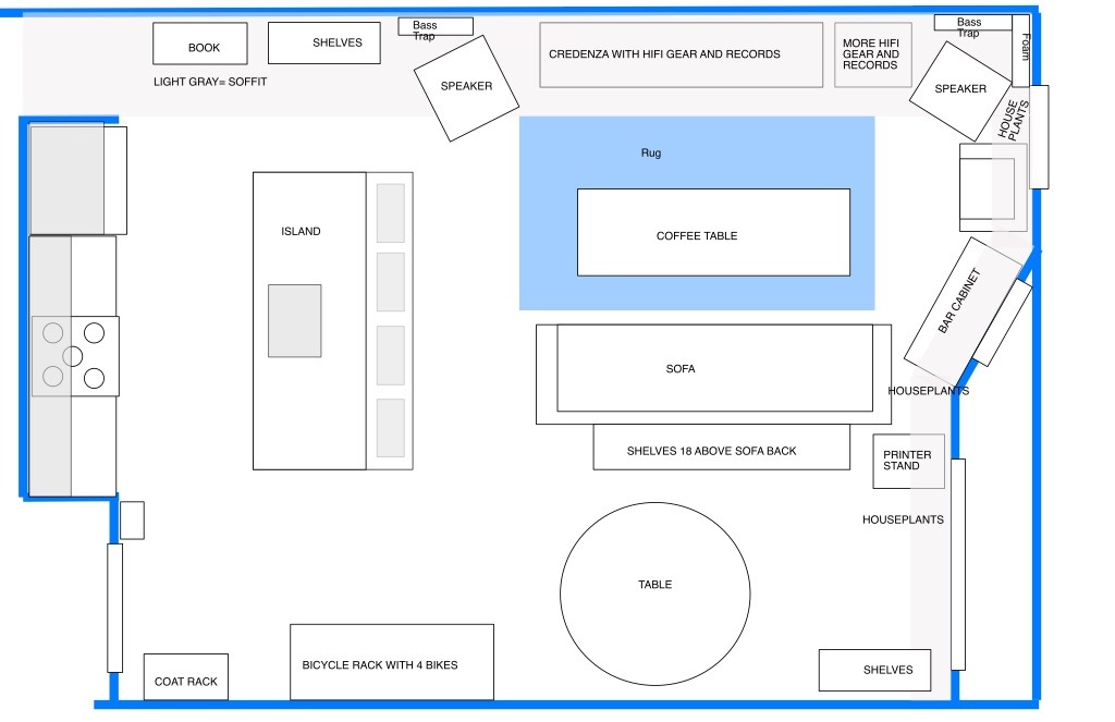

2 of 3 bass traps are done:
And installed
I still need to build one more for the other half of the RH corner, but so far, so good. They seem to perform better than my ad hoc foam traps, but measurements will say for sure. The diffusers need a little more stain, hopefully, I‘ll have them completed by this weekend.

Looks much too small and too thin to be effective for room modes I'm afraid, but for mids, sure! Hence, you might want to experiement where to put those.
To have effect on room modes, which make the main issue for bass, you would need about hundred of those panels. Perhaps put on corners of the room with air space behind maybe tens had some effect.
Modes happen with room sized dimensions, so if your room had 6m longest dimension the lowest mode has 12m long wavelength. Now, imagine 12m diameter ball, and compare size of the acoustic treatment to that, and it's much too small, acoustically invisible to such long wavelength. If it was perhaps quarter wavelength in size, it would be already effective. Basically this means such absorber treatment needs to approach size of the room, eat perhaps quarter of each dimension, to be effective for low room modes. Thus, instead of absorption more frequency targeted resonators are utilized to help with bass, to save space.
For absorbers many things affect like surface area, type of material, thickness, whether it is positioned in velocity or pressure node of a mode, incident angle if shorter than room sized wavelengths. Material seems to be insulation so very good absorption properties for a velocity node, But for example 100Hz is 3.4m long so 1m x 1m panel might have some effect on it, and more and more for frequencies above, and less and less below.
