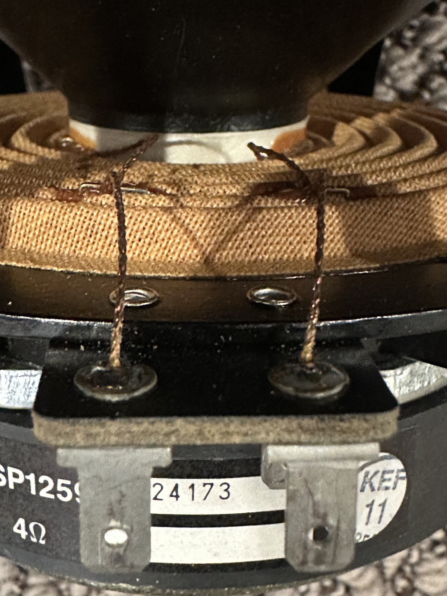

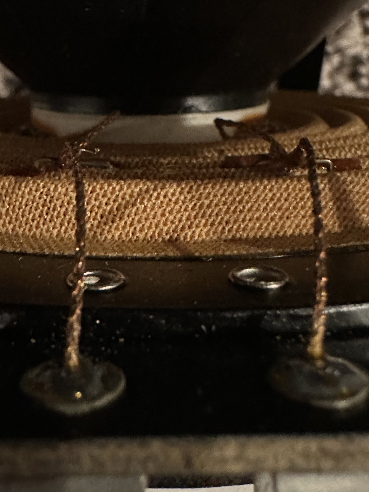

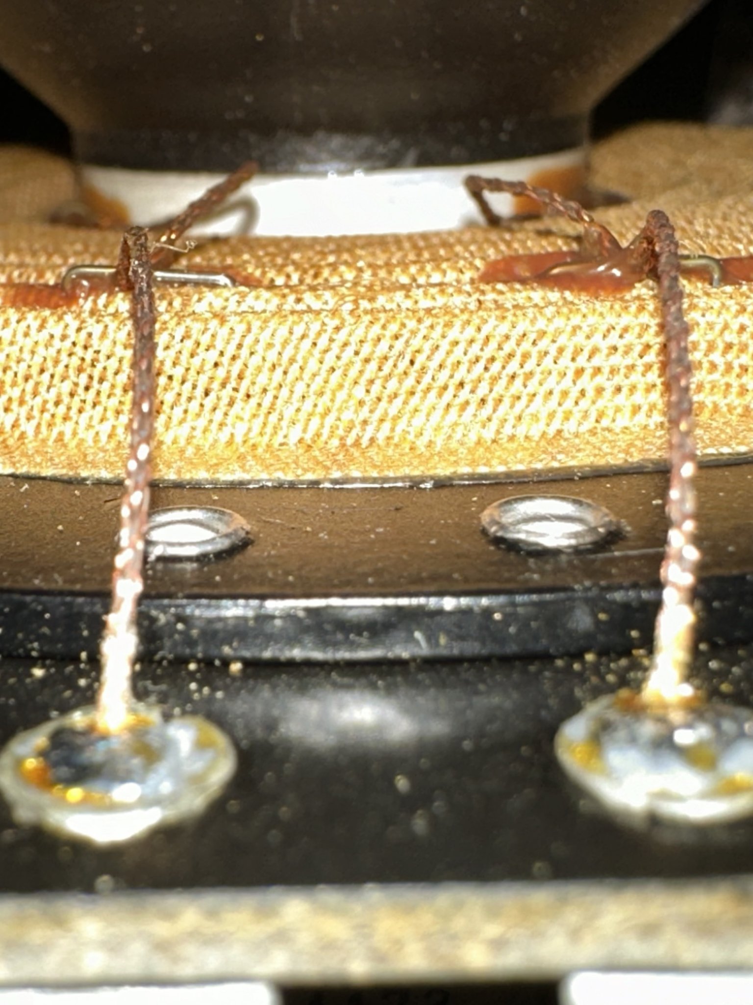

I shouldn't think there'll be any aluminium in there. Those braids are usually either copper or silver and I can't imagine KEF using silver. 😂😂 I think flux is in too short supply to use CCAW in a bass unit but it's interesting that you mention Scan Speak because they pioneered making that joint in their tweeters which, because of the two metals, needed a particularly aggressive rosin - I presume to knock away the AlO3 that would reappear instantly.
But that really is a weak point which at some time gets nearly all manufacturers, especially if spider/coil former/cone and the wires all meet in the same place. You can sometimes find old B139s with burn holes round there, where someone has either been making a hash of things or has corrected a previously made hash (very hard to disguise if you have expanded polystyrene near your soldering iron).
In bass units? I'm surprised. You can probably get back some of the turns if you've flattened the wire but I'm still quite surprised. You are saving some mass but it's nothing like as important as it is on a tweeter or even mid and you need a given amount of mass for your bass resonance anyway. And I'd have thought you'd be sacrificing some power handling too - so that might mean you have to go up in coil diameter, which could mean an increase in magnet size too. I'm sure you can get something out of it but you'd need to do a proper study to see if things can turn out better with CCAW and though I can't do those calcs in my head I still think it's going to be a step back in most applications.

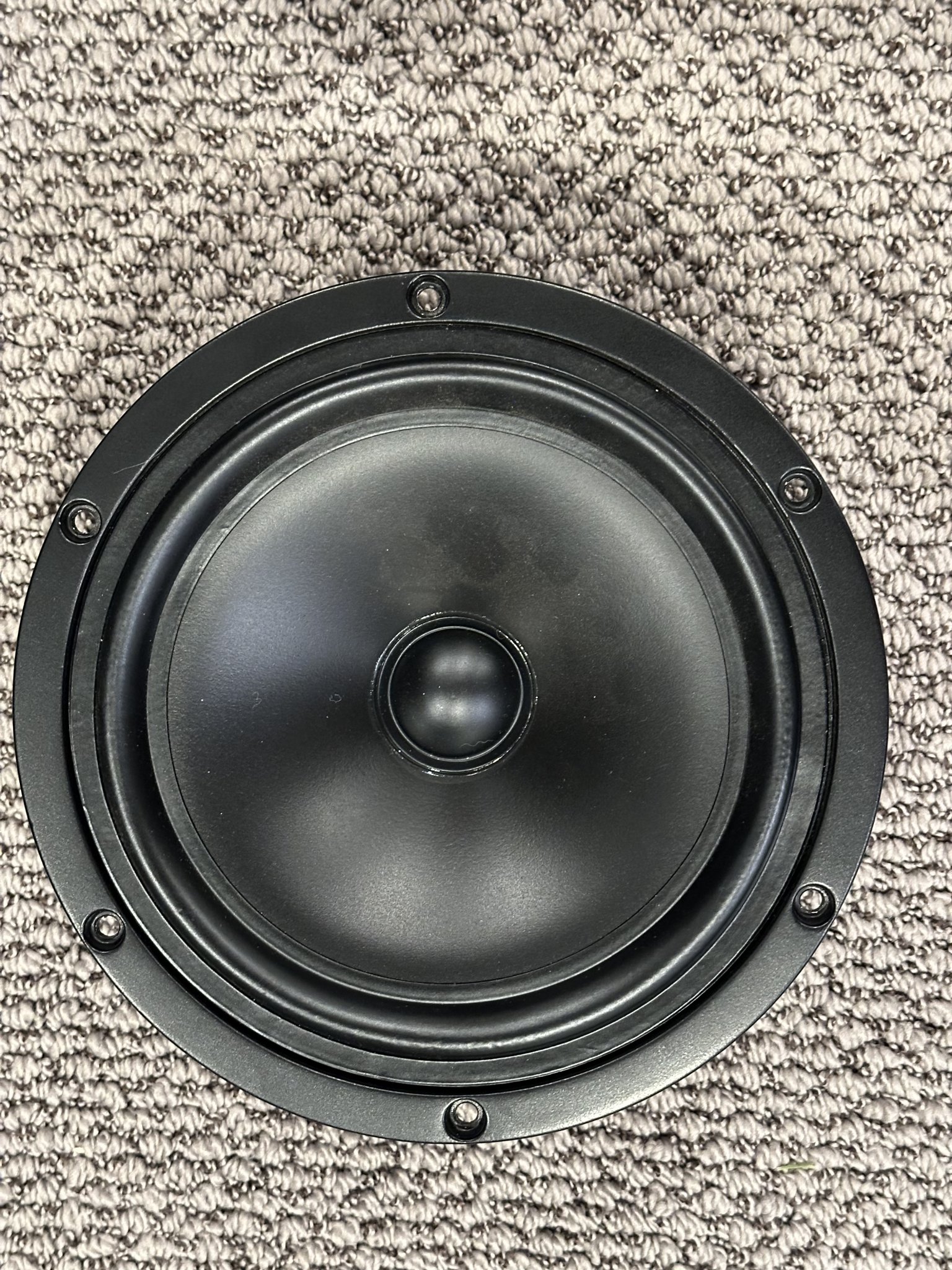

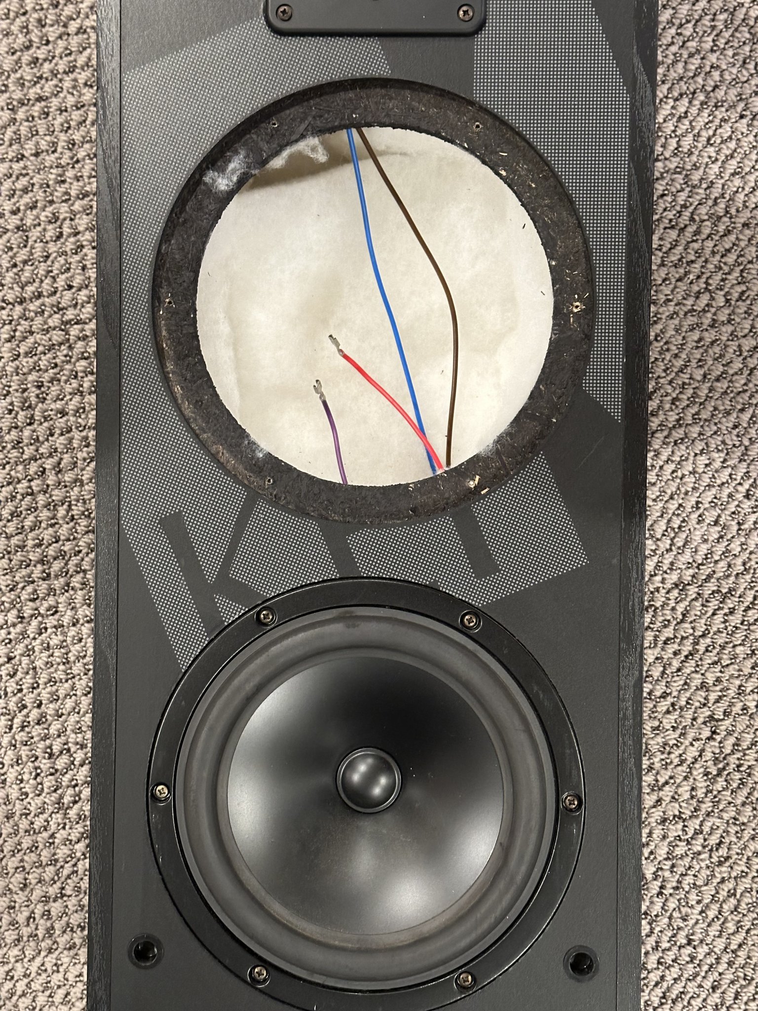

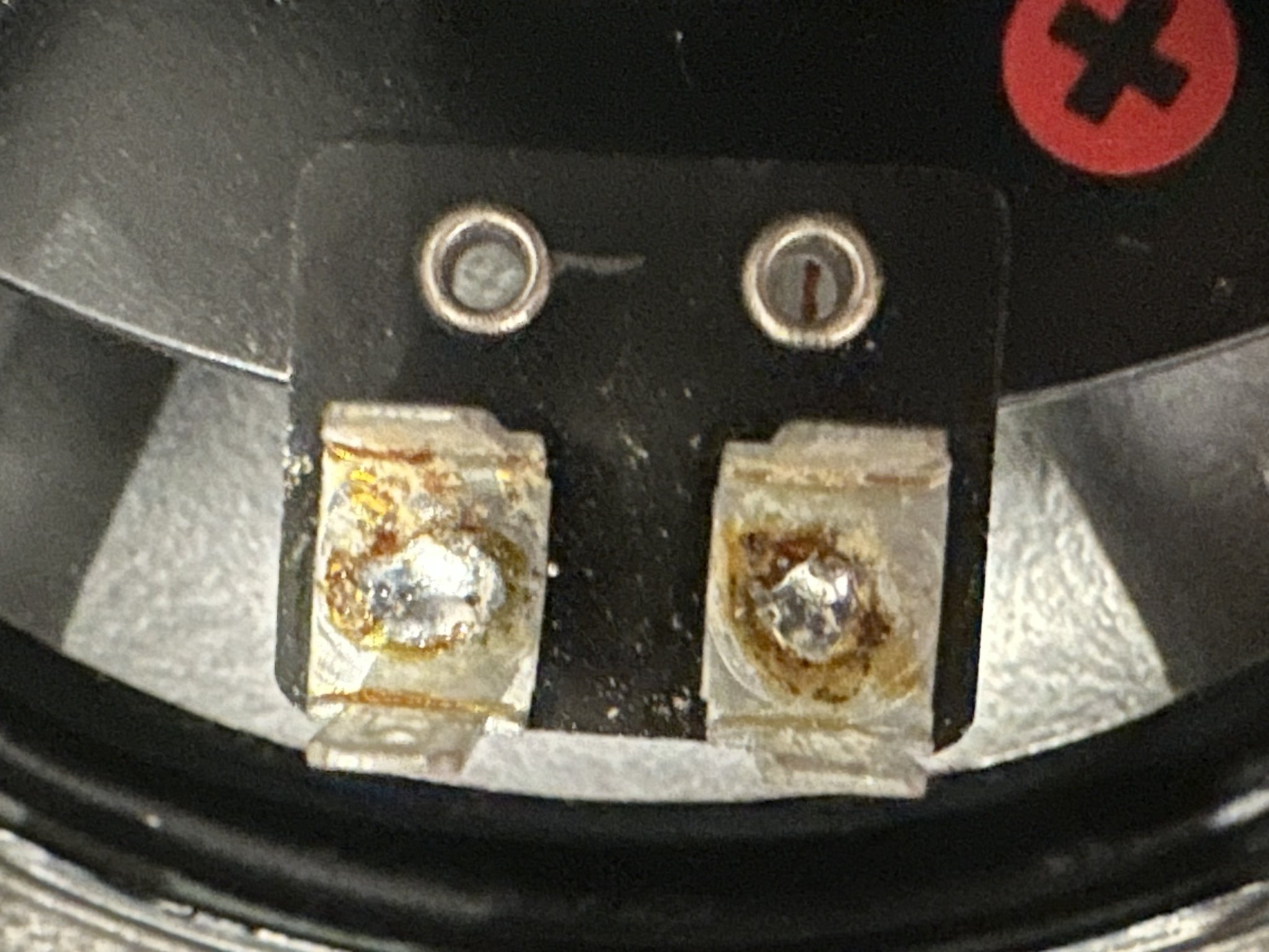

I remember these speakers well, and remember a KEF rep bringing a pair of the 8" version (C45?) to my house because they were the first speakers to showcase Andrew's idea of using a large series cap on the bass unit. They were still a bit too KEF for my taste but the bass idea worked well, if not quite doing the full job. No, the series cap doesn't colour the sound at all (I'd say introducing it changes things less than changing any other capacitor in the bass section) but, funnily enough, neither did it protect the speakers I'd put it on when the A370 went DC. (It might protect a larger speaker. A 3" driver getting 65V DC as its signal was already a shot to the head, long before the coil had a chance to begin burning.)

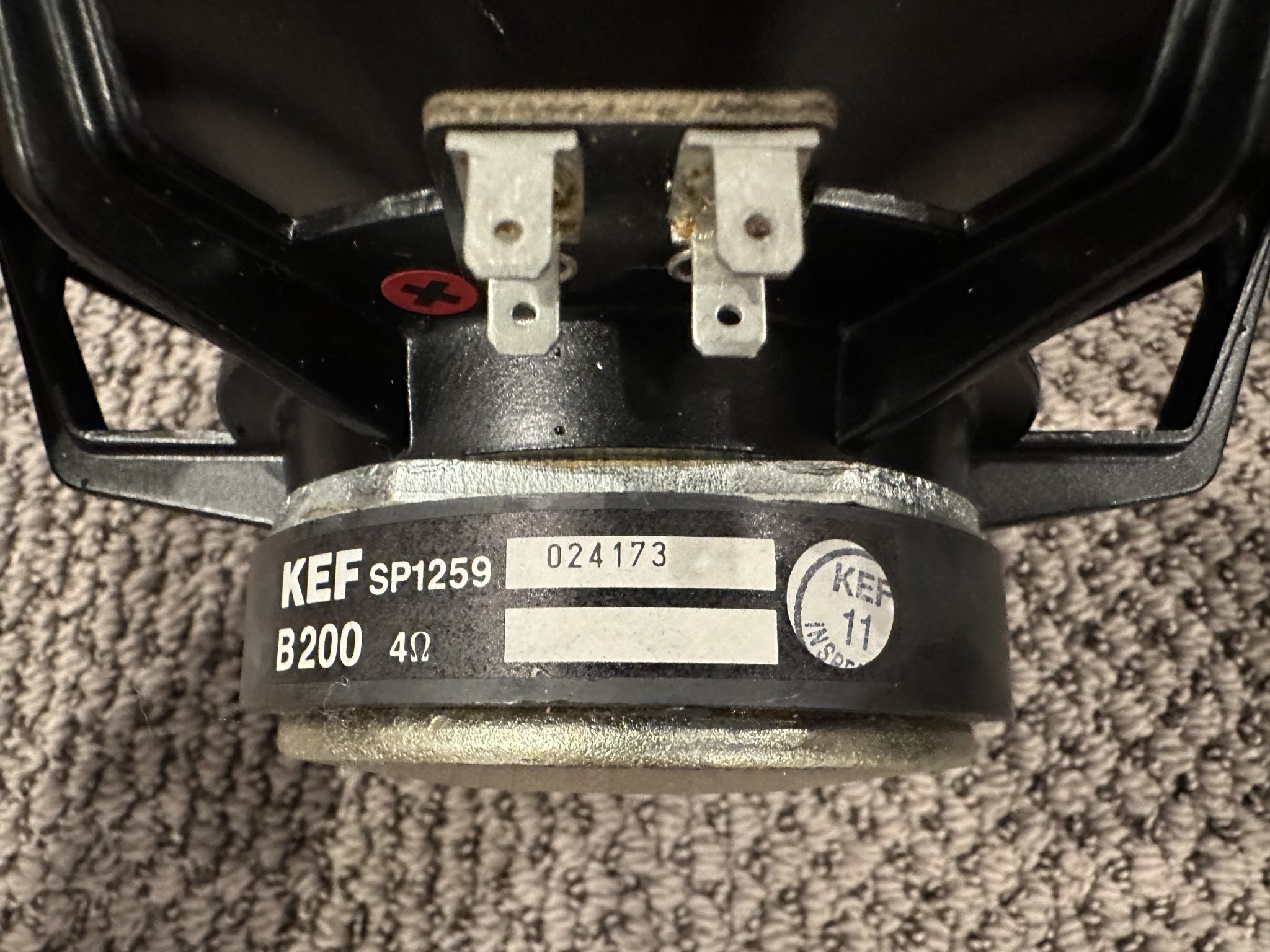

Sadly, yours is completely different B200 and, I believe is a 4 Ohm unit so you can't swap a B200 in. Just in case your drivers can be rescued, have a look to see if the joint between the VC wire and the braid is good. Sometimes you can repair a unit by unwinding a turn, or half a turn, and resoldering it to the braid (which, incidentally, is never that easy). But if not, it's either eBay for the same drivers or getting the bass units repaired, which is what I would do.
this is new for me and good news.Volt, who I think moved to Dorset some while ago, would be a good set of people to do it - especially as you will probably have to have the coils wound anew. Send them both drivers and you'll get back something pretty damn close to the originals and, most importantly, properly aligned.

Wilmslow Audio might be worth contacting https://wilmslowaudio.co.uk/ . They carry out drive unit repair.
Also they say "B200 bass - use Monacor SPH-210"

Update: I was able to source used SP1259 (B200) drivers from different sellers on eBay. I replaced the drivers in my c65s and voila they are working now! Time to revisit my 80s youth. I’ll probably start with some Full Moon Fever and take it from there..:
Thanks, everyone, for the advice!
