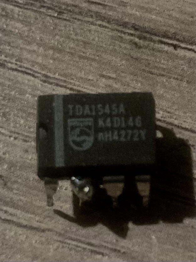

found an old sony mini system in the bin and in it there was this tda1545 ic(along other usefull components) and im wondering how hard would it be to make a simple spdif/coax dac for my tv(that lacks an anlog output) or a crappy dvd player.
i also professionaly soldered one of the legs back on. it works but it looks a bit ugly.

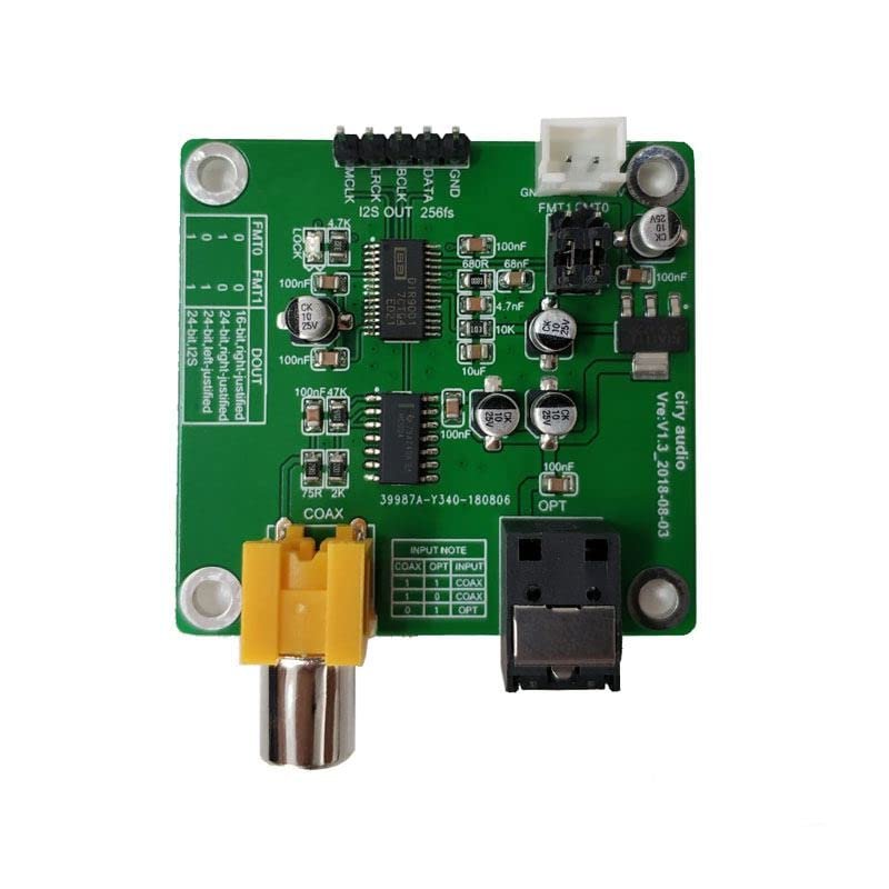

WM8805 will do right justified 16-bit, though. So that could be an option. That chip's now discontinued, but it hasn't been out of production for that long so I bet you can still find them. If the WM8805 can do it, I bet the 8804 can as well. The two chips are identical as far as I can tell, except for the multiple inputs on the 8805.
Tom
Between £8 and £15 depending on the seller or site. Plus shipping.how much does that board cost?
Here it is on Aliexpress, prices on there seem to vary with randomly applied discounts : https://www.aliexpress.com/item/1005004018973544.html
