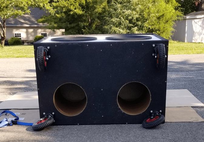

Sonotube is cardboard. Use a stiffer material or reinforce the tube. Use two layers (thicknesses) of sonotube.
Where was the failure? Was it from the audio vibration or from transportation? I’m very curious as to why the port failed. Maybe the front baffle needs more bracing. Pro sound loudspeakers are notorious for being made light for transportation, this often makes for a weak resonant enclosure.

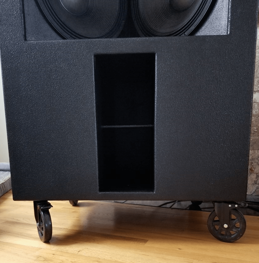

If you want a better pro sound port why not make a square or rectangular port from 3/4” plywood?
I thought about using two layers of sonotube, as the tubes are nested together in the supply houses. Couldn't figure out an easy way to bond them, fill the fit imperfections, other than maybe expanding foam...which proved to be too sticky to allow insertion.
On the box shown, there was an internal divider separating the sub into two single subs. I braced the sonotube off that and the other walls.
Ay any rate, it was one vibrating/rattling mess at higher SPL.
The entire bottom with castors was removeable with the sonotubes glued into the base, removeable to I could trim the monotubes to length after measuring.
Instead, i just threw away that bottom and built a new one with rectangular shelf type ports out of 3/4" ply. Same area and length as the tubes, because the tubes had measured fine.
It did not vibrate anywhere close to the tubes. So I built a pair.
And then found at high SPL, that the front baffle and overall box were the weakest links. Great big cabinets are a bitch to brace !
I ditched those subs, and built a new set based on what learned.
This port, about 9"W x 20"H x 24"D is built like a tank....(as is the whole cab)

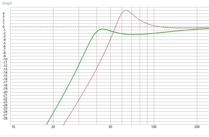

So the driver is either high Qts
or something else is going on
with that high Q bump at cutoff.
Curious what driver
if I missed that.
Port resonance or actual
vibrating port can show a bump in the impedance curve.
Ironically not very audible, but measurable for nit pickers.

But close to what a alignment should be.Less audible bass @40hz
The high Q bump is a indicator of not happy
suspension.
Box too small or big
and tuning not near Fs
Of all things it might wanna be tuned lower.

My understanding of tuning is pretty basic - nothing is for free. If you tune for power you will lose torque.
In this instance: LF output @40hz can be gained at the expense of SPL @ the 60hz region.
Trimmed 20mm off the ports for 42hz tuning - markedly better performance.
