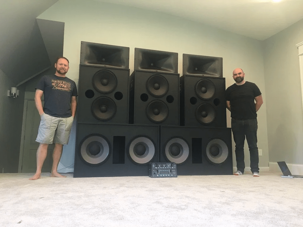

newvirus2008, cool set! While this big is not necessary at home it well illustrates it takes quite a big system to really get loud sound. Small bookshelf speakers, well, perhaps they are fine for bookshelf, it's just important to realize serious application really needs serious system, and it's not too hard to figure out what an application requires. At least, the ballpark figures are easy to estimate.
