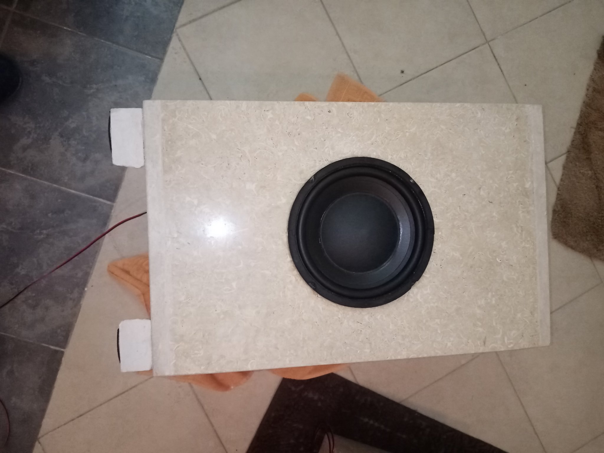

I have good experience now with just one 8 inch bass in a low tuned bass reflex marble enclosure with corner placement.

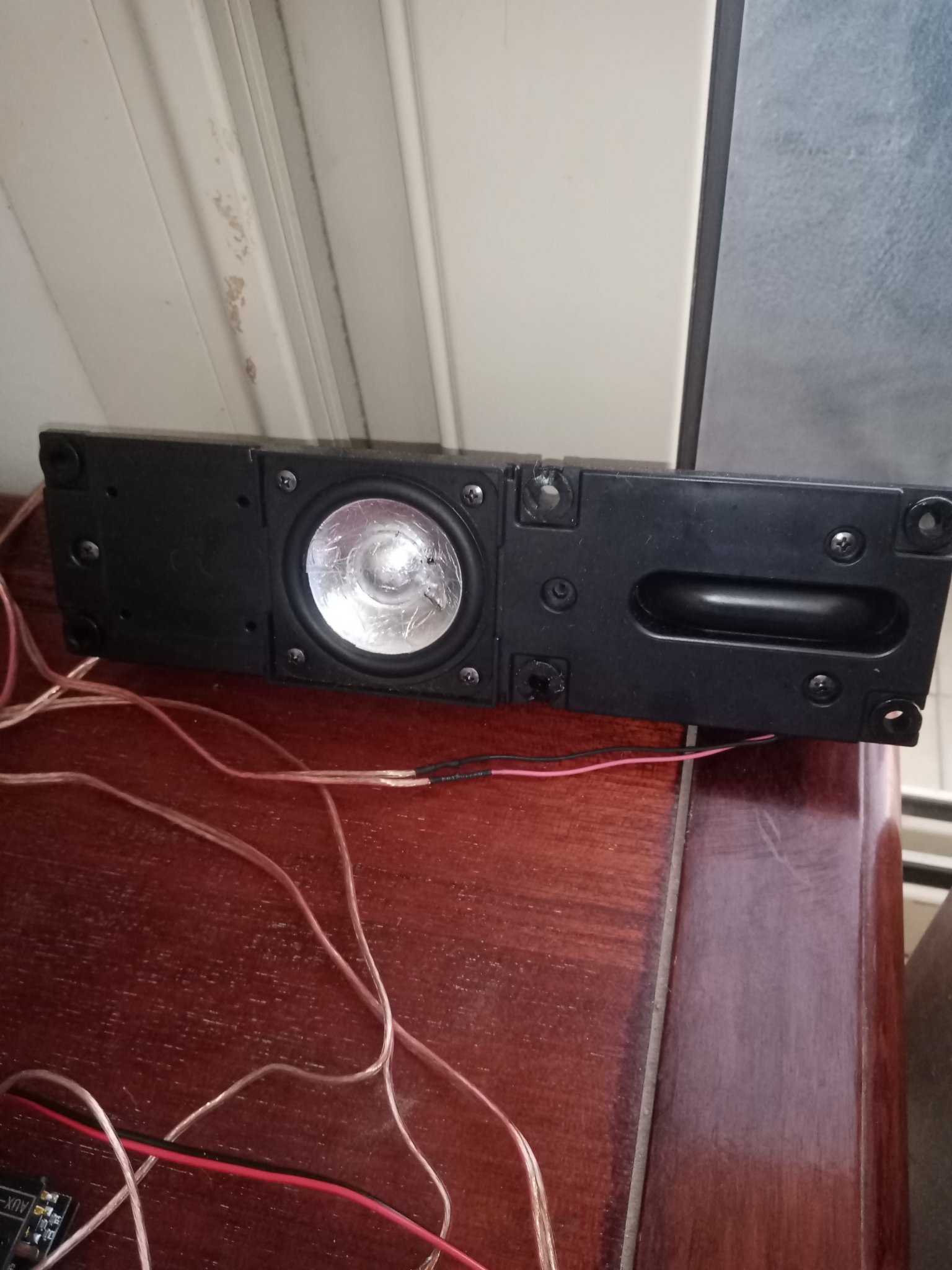

Together with two close to wall high end 8cm full ranges and 2.1 amp.
Works and shows tonal fidelity and impulse response
It's not about total loudness but about fidelity

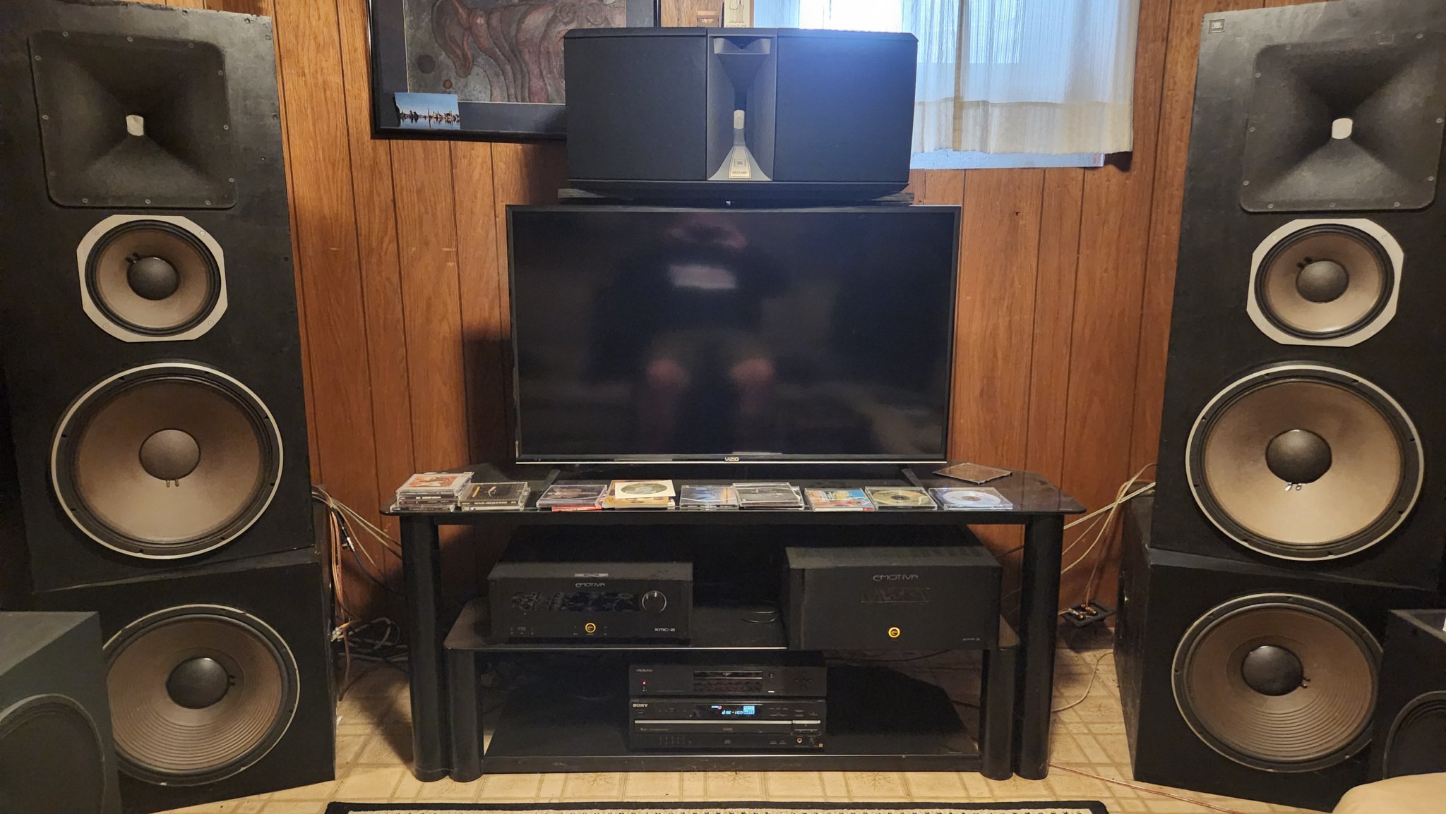

I'm doing that presently. my main speakers in both my home theater and 2 channel system are 105 db sensitive horns that measure +/- 3db from 23Hz to 20kHz and by integrating my multi-amped 2 channel system into my home theater instead of driving them with an AVR, I give up zero dynamics. My horns are "loaded" with pro drivers: JBL 2225 H 15" woofers, PRV D2200PH midrange in an 18" x 10" horn and B&C DE120 drivers in elliptical, tractrix waveguides. with a DSP processor to time align, flatten response and deliver a quasi-linear phase to 4 mono blocks on the woofers and tweeters and a stereo tube amp on the mids, I give up nothing for either hi-fi or home theater. it is glorious.Hi All,

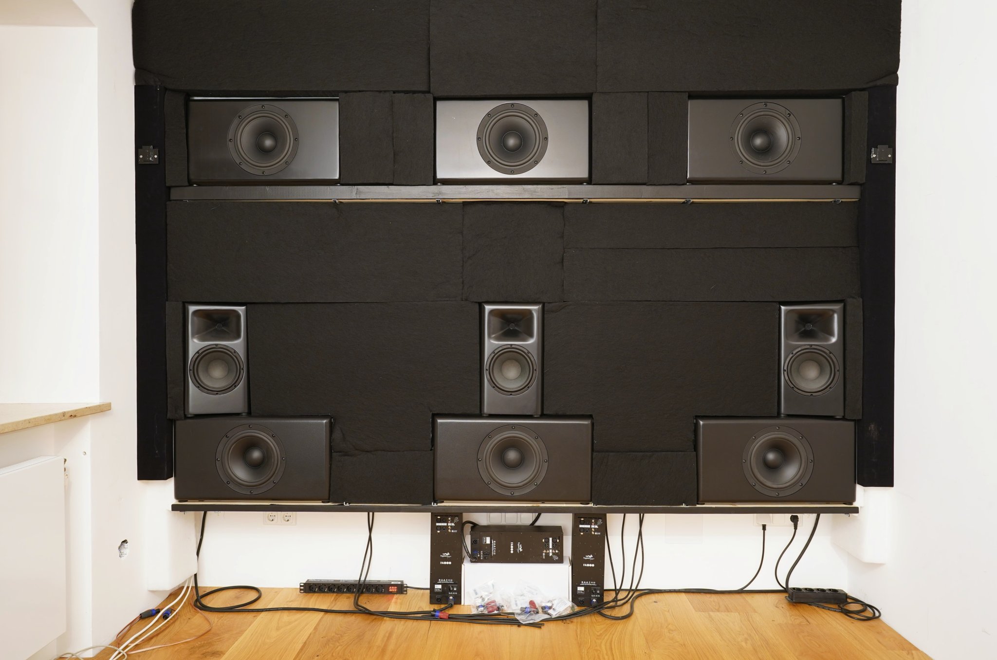

This is my setup:
6x 10" in closed volume arranged as single array. And active 8"/1" main speakers from 90Hz. I searched long for the best components for these mains but am pretty happy with the result. In a larger room you would need 2 8" in a 2.5 way setup to keep ATMOS level.
So - I would not be happy with a PA woofer, ported at 40Hz - you would miss a lot with movies. You could add a shaker for lowest frequencies but I would still aim for 30Hz in the room, prefered from a closed cabinet (cause they fall off slow and are easy to EQ to the room).
PA chassis for the rest is fine but when you want HiFi sound and great midrange you have to chose the right drivers!
p.s.: with screen, still during construction:

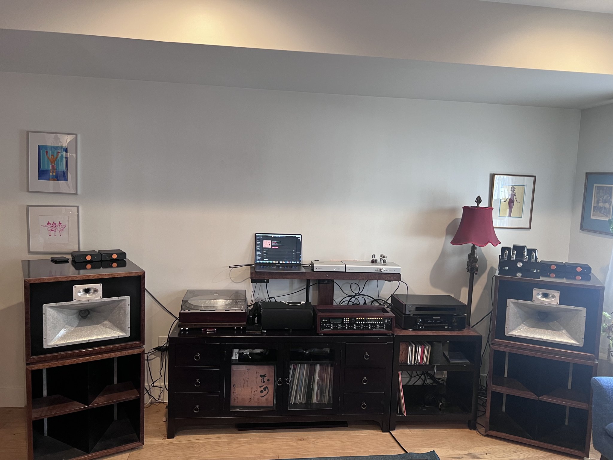

I’ve tried a few different scenarios over the years. I have found two different set ups to work very well. One is a big t.v. in an apartment, flanked by a pair of old B&W Floorstanders driven by an old Marantz receiver (a good Class AB amp). There’s no sub, no surrounds and misses nothing. Key thing is these stereo speakers are large enough so they dig deep, have impact. Sounds superb on movies and music.
The other is a basement set up, projected image onto a wall painted screen flanked by two large Khorn speakers that are bi-amped with a dsp XO and a pair of PMC Floorstanders at the back for surrounds. A modest 2x8” sub and no centre channel. Dynamics are good and it can go loud. Recently did itself proud during a screening of Master and Commander, blue ray with award winning sound track with an opening sea battle. It needs a sub because the Khorns don’t dig deep with any strength.
So, I would agree that dynamics is a quality to give priority to but there‘s no one answer, depends too much on the room.

... I give up nothing for either hi-fi or home theater. it is glorious.
