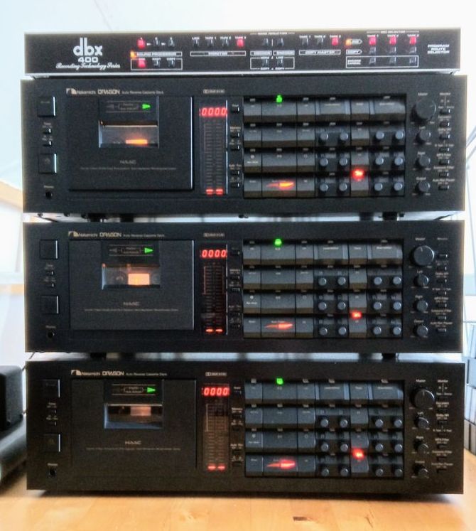

I was lucky enough to have 3 Nakamichi Dragons on the bench until recently. 'failure-anxiety' got the better of me (those things are EXPENSIVE to repair) so 2 were offloaded and I kept the first one I bought which is a mid-term production run example in pristine condition and last serviced in 2017. Hoping it doesn't go koff-wheeze on me during my ownership but it's a joy and an occasion everytime I use it.

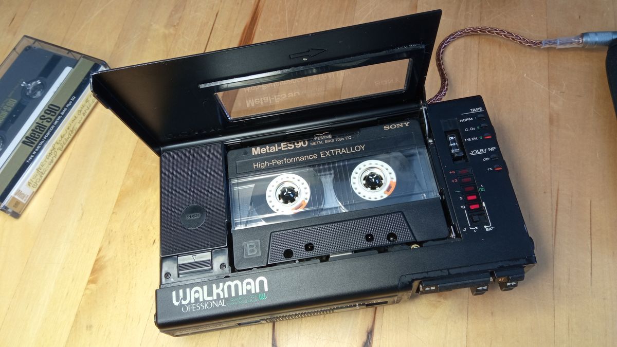

I have quite a few portable cassette devices including models in the Sony 'Professional' range - D3, D6, D6C, TC-D5m's and my absolute favourite is the TC-D5M as it sounds incredible and is built like a tank, even though it's not the most portable of portable devices! 😆
A few piccies of my little collection.

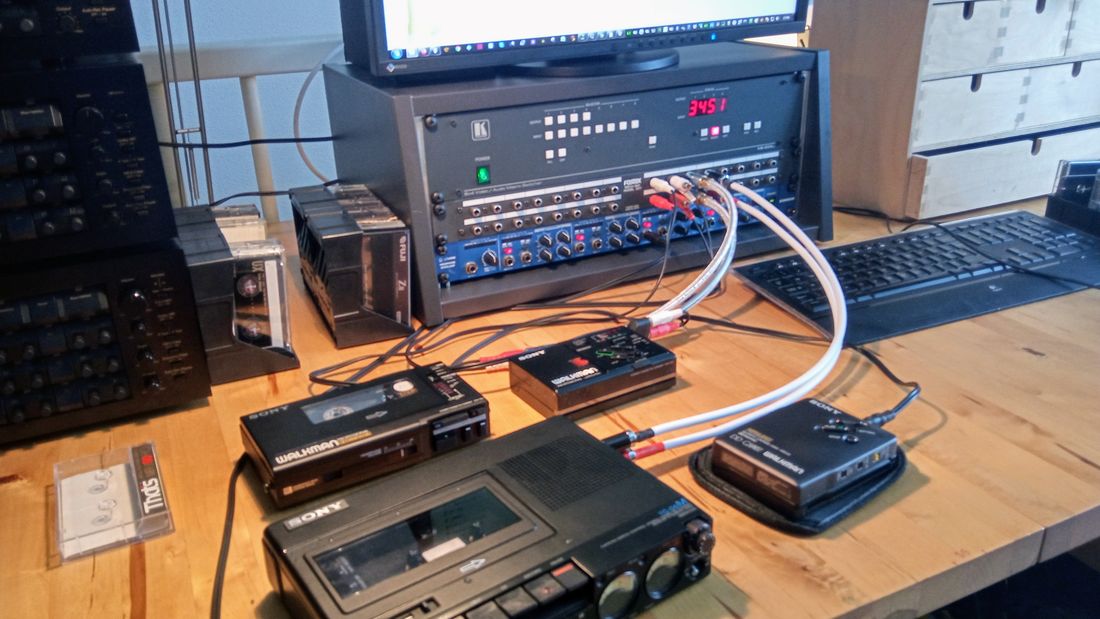

Portable sound comaprison test on the bench.
Result = they all sound great! 🤔🤣

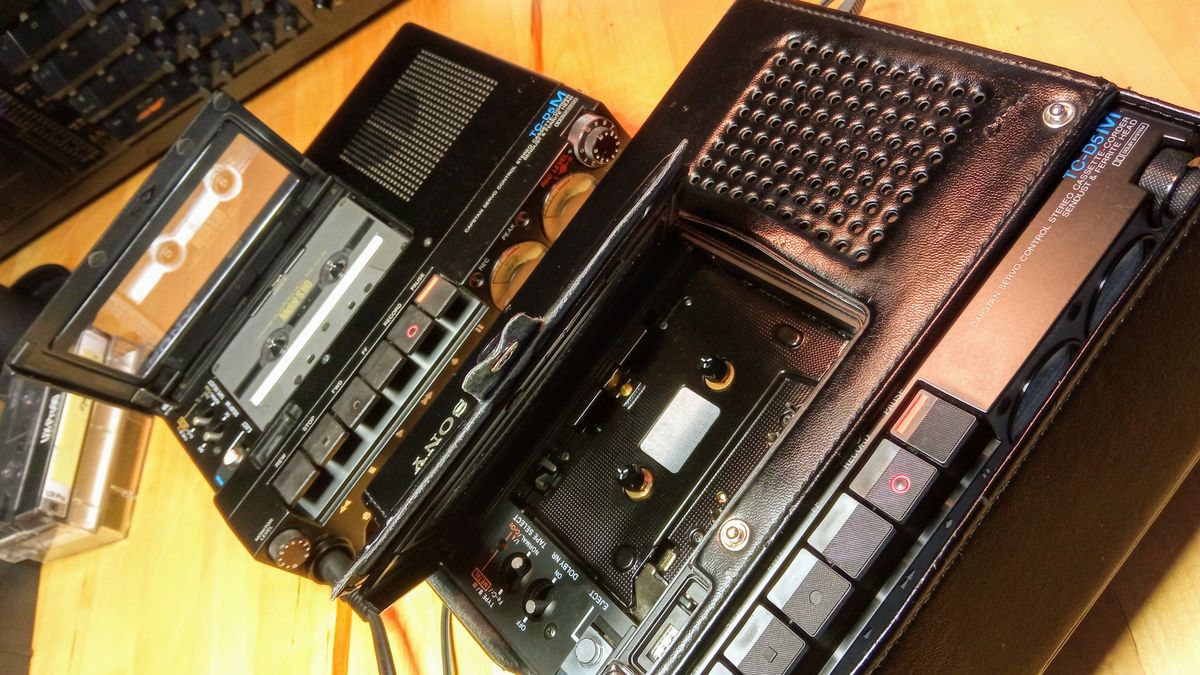

Favourite 'portable' tape device; the vox-pop journo's favourite - Sony TC-D5M. The one in the foreground was a beautiful score - no marks or signs of use anywhere and still played flawlessly after languishing in a box for 30 years!

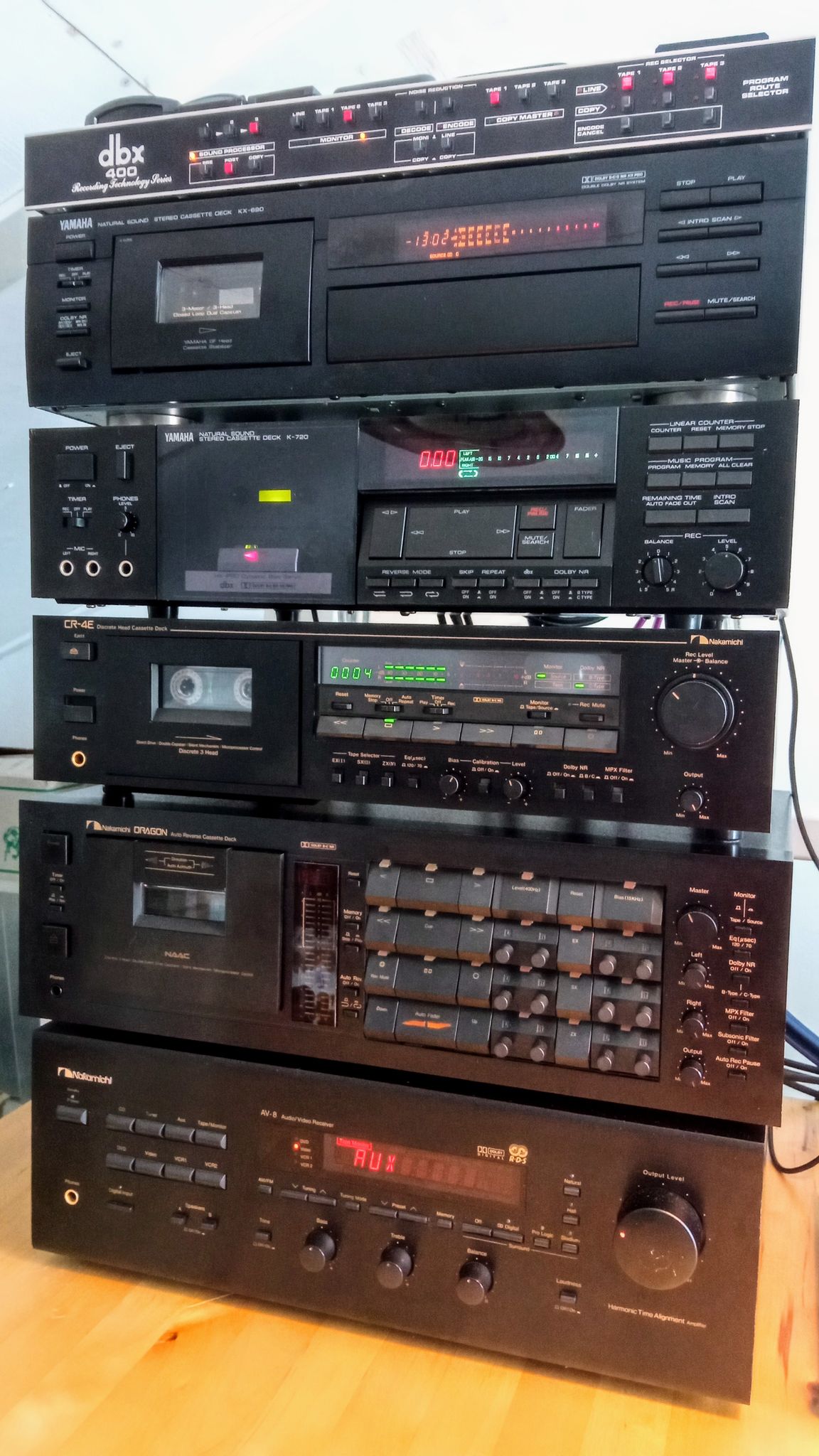

Current bench stack
The latest acquisition - A lovely Sony D6. Needed some fettling to bring it back into spec, but now sounds epic, better even than the D6C which came later. Contentious claim amongst Walkman afficionados, but true! 🤔

3 Dragons. Who really needs more than 1 Dragon??

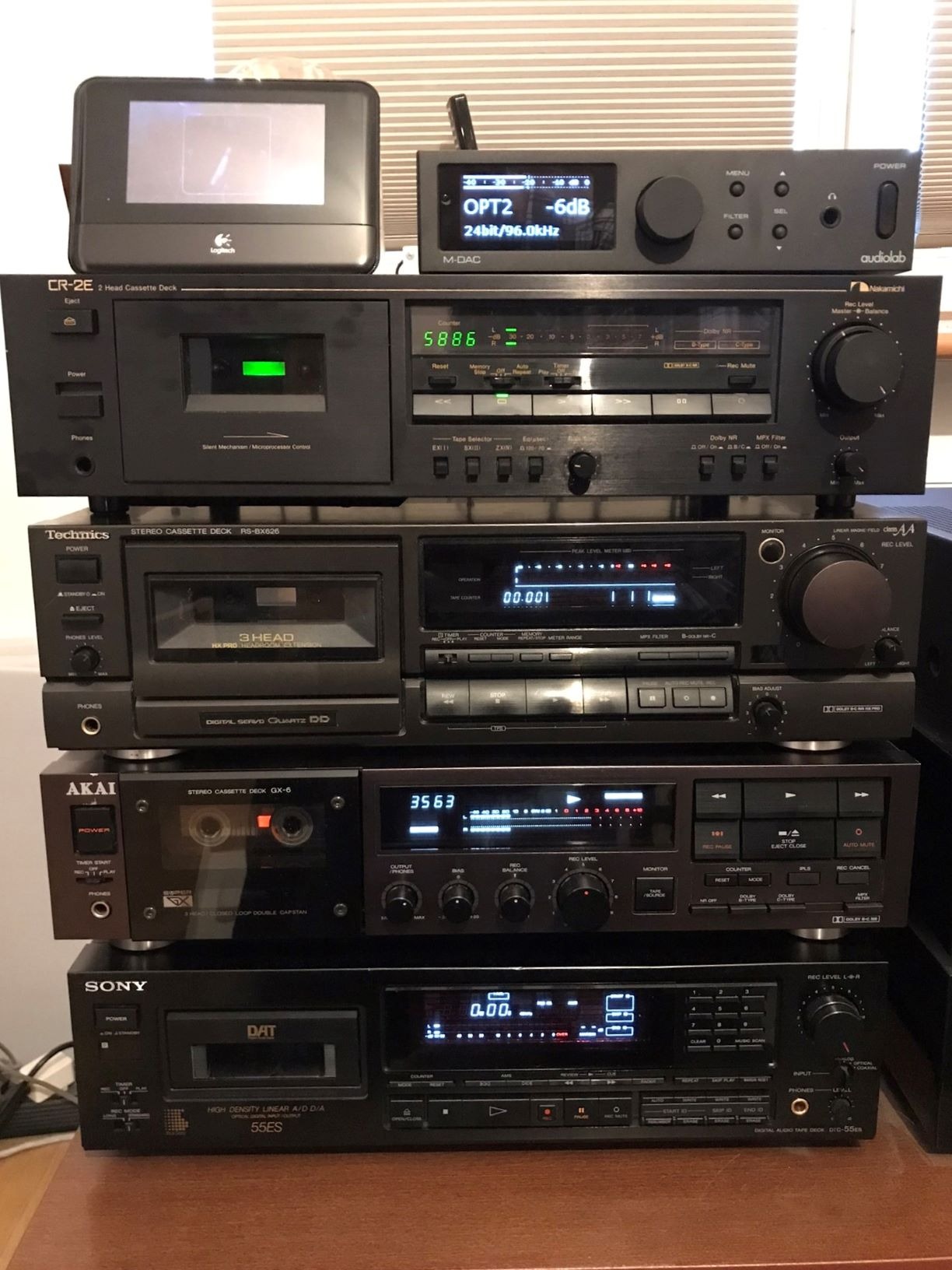

@Triodos Which one of your cassette decks you like the most?
The Nak is a proper Nak even if two head. Their same line models had very alike circuitry and parts. Your AKAI is very nice with Hitachi Dolby chips and a straightforward enough signal path. Being DD dual capstan is cool even if not Quartz.
Your DD Quartz single capstan Technics is also nice. Better its not a dual capstan because more reliable than their TOTL dual capstan RS-BX965 which is known for mechanical troubles. The dbx NR is an extra feature I enjoy in that bigger model though. A friend has one and its dbx recordings also play 100% compatible on an AIWA Excelia XK-009. In my experience dbx renders more impressive impact and dynamics than any Dolby. Even Dolby S.
Its a pity both the AKAI GX-6 and the Technics RS-BX626 miss rec level Cal oscillators in case you want to record with NR fully properly on any tape in hand.
For DAT I used to also have a SONY 55ES like yours but with wooden side panels. I bought it in the UK in 1991. Very good performance from the machine itself but I was disappointed to find out that my DAT tapes could develop few dropouts with use. Especially after re-recording on them. I eventually sold it in mint condition and later bought a portable MiniDisc and a double CD Recorder deck. Both SONY.
