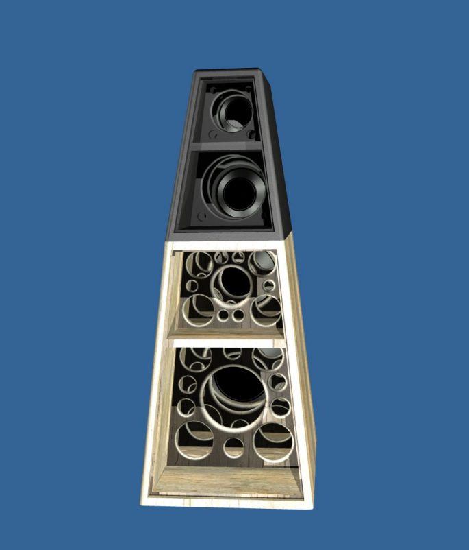

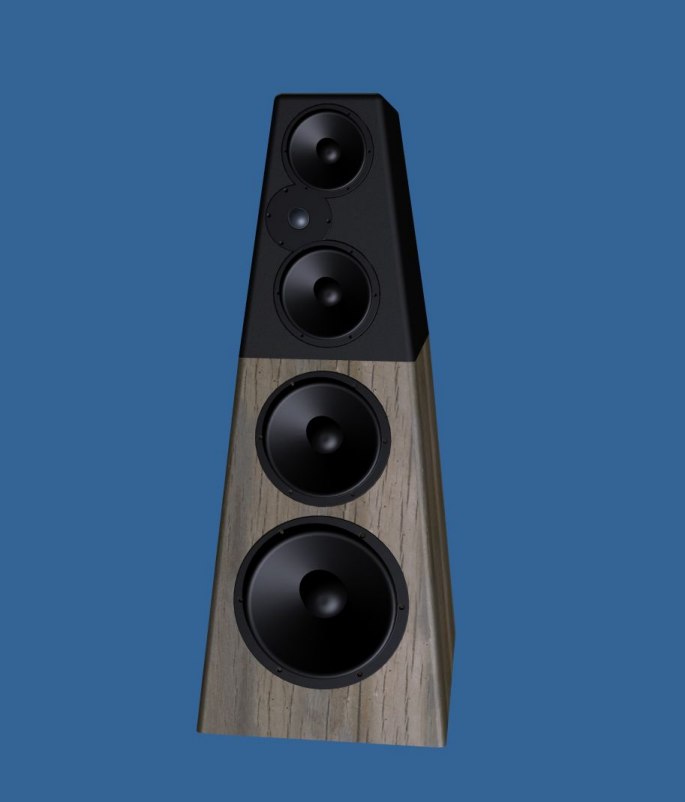

This is the solution that I am working on at the present for a higher efficiency design. The plan is for a series/parallel network similar to the Elsinore's.
Most of the drivers I already had and since this is primarily for A/V mains I wanted more headroom and dynamics over absolute resolution. THe cabinet is 40 inches tall and the bottom footprint 16x22 inches.
The offset tweeter was a design necessity to keep the height at 40 inches. The lower woofers are about 3db more sensitive than the uppers so my plan still remains to be settled as a 3 way or a 2.5 way. Either way the lower crossover point will be at the approximate BSC frequency.
Driver's
5.5 Silverflute mid/bass
6.5 Silverflute mid/bass
Vifa 1 inch D27 linen dome tweeter
Vifa P21W 8.5 inch woofer
Aurum Cantus 10 inch poly/carbon/mica woofer
You cannot tell from this picture but the lower cabinet front baffle is slightly angled toward the listening position. The upper cabinet front baffle is vertical and the tweeter is about at ear height when I sit on the couch watching a movie.
Driver's
