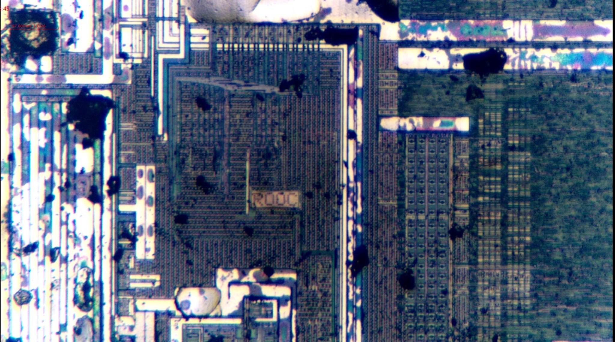

So, Is there any chance to get nice pics without $5000 Zeiss metallurgical microscope? Hell yeah, quite compact and within $100! First I bought a used VSZ-0530CO Japanese precision optical zoom device $53(with 12V coax LED!), it is a machine vision element massively used in China to control production parameters and measure dimensions. Vital Vision Technology promises a good resolution(4um) and minimal geometric distortions(.001) for the device, you need just add the C-mount CMOS camera 1/1.8"(from $30 for a secondhand) and 160mm RMS standard 4X lens aka objective(I paid $8 for used Canadian Motic EF plan 4X/0.1) with a thread adapter($4). The small like a book table + holder cost me $15, that's it. Check this out:

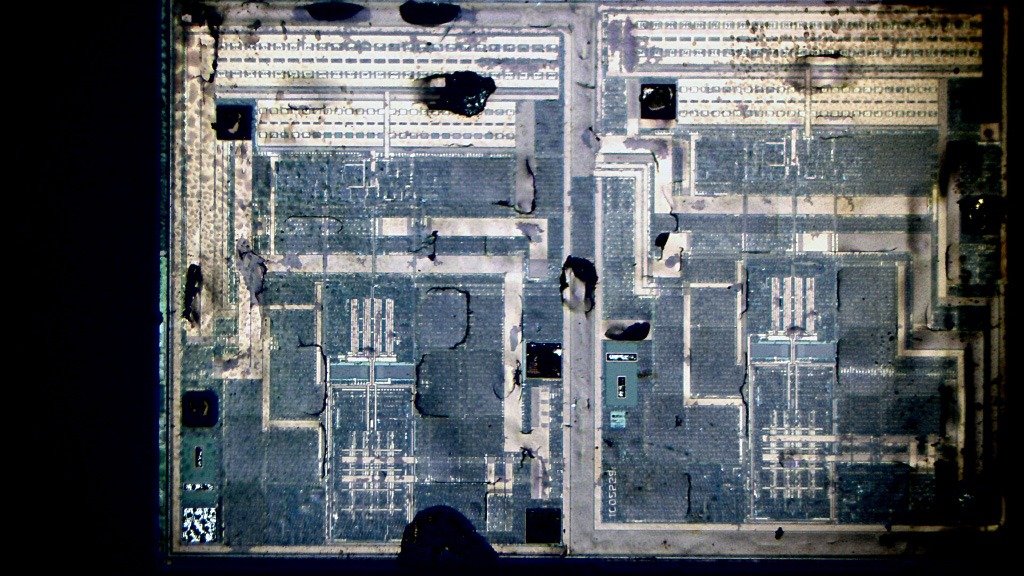

Low phase-noise EPSON_SG-210STF oscillator chip.

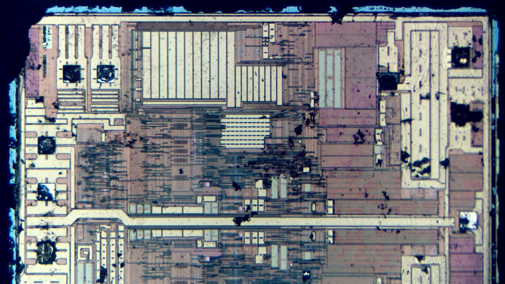

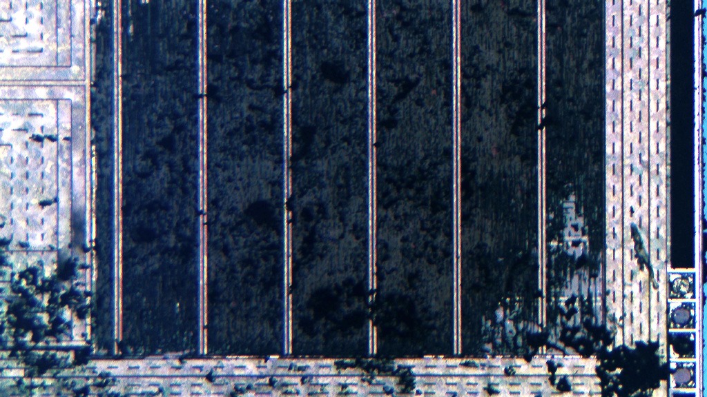

BC856B

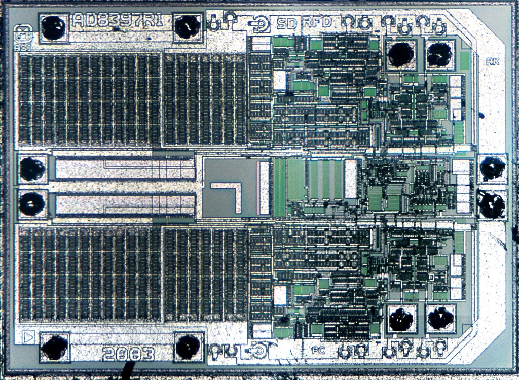

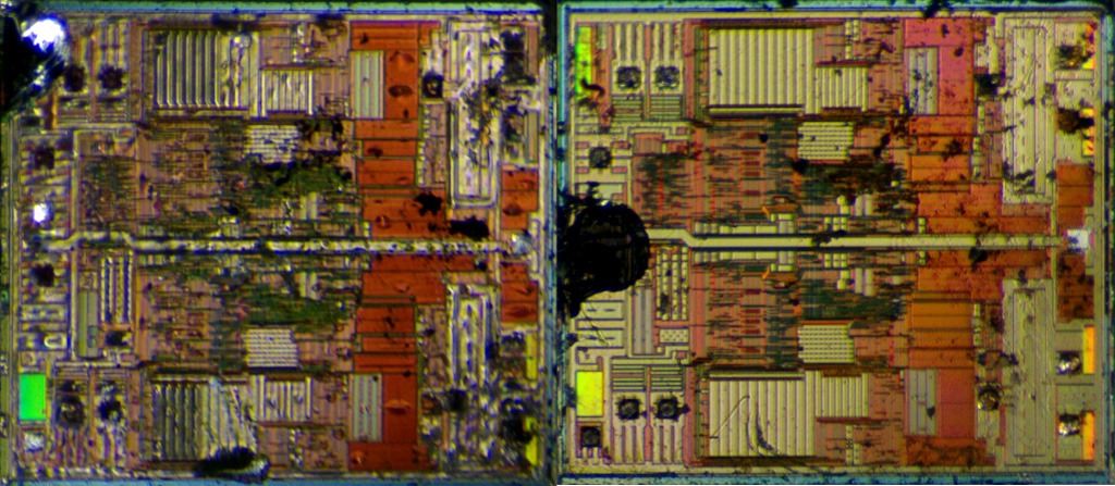

AD8397 is a bit dirty with the residual plastic on the silicon.

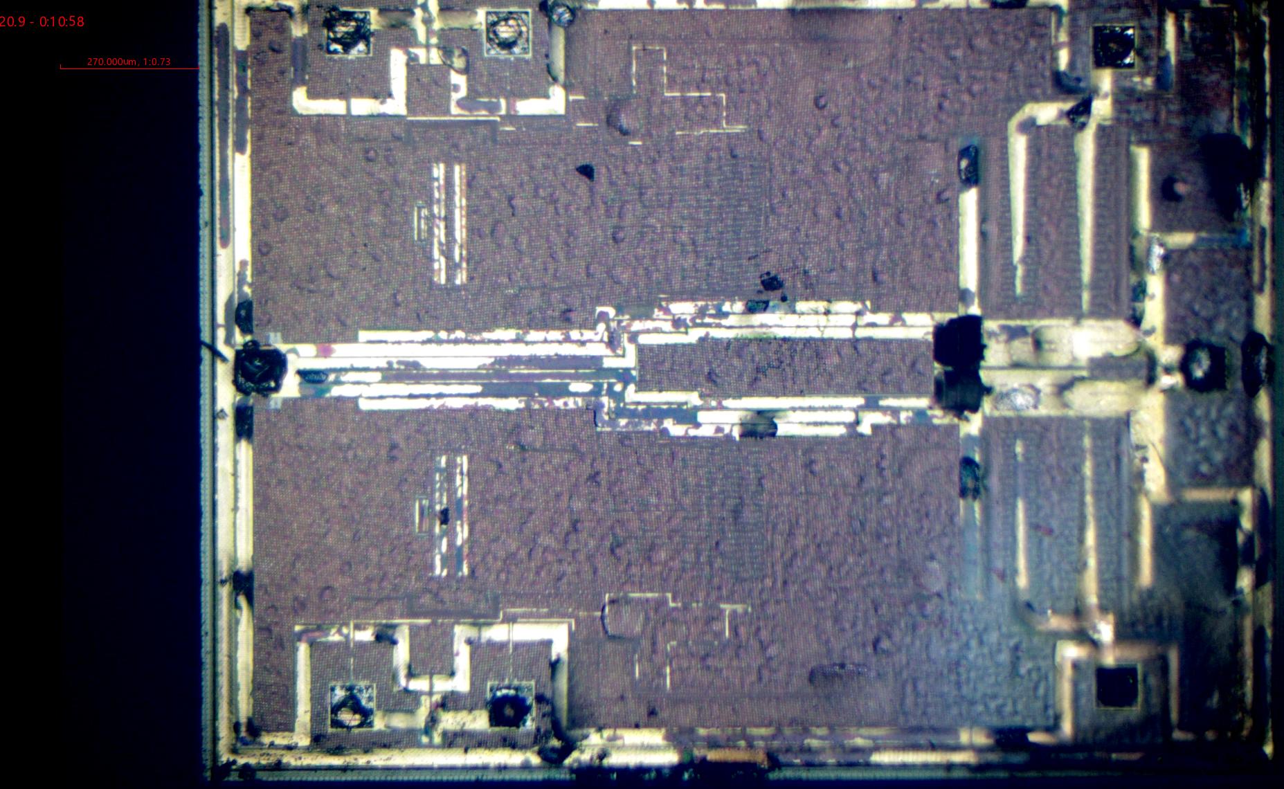

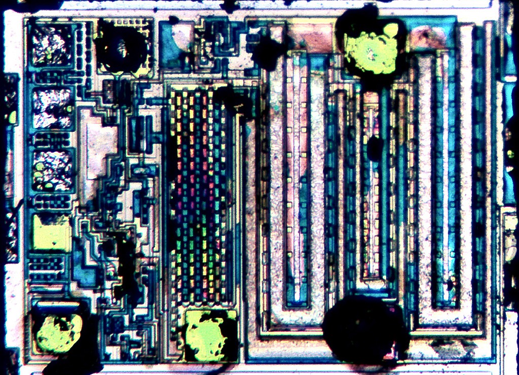

Ti ISO7240

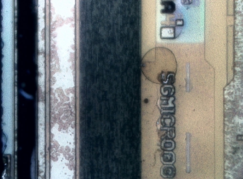

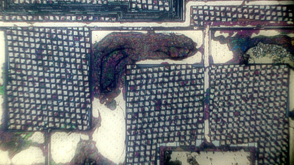

OPA1612 has such a tiny marking, the symbol's thickness is 4um, and the minimal visible elements are 1.5um. That pic taken with Motic 40X lens.
BC856B
Ti ISO7240

What did you use to get the plastic mould compound off? Hot nitric acid?

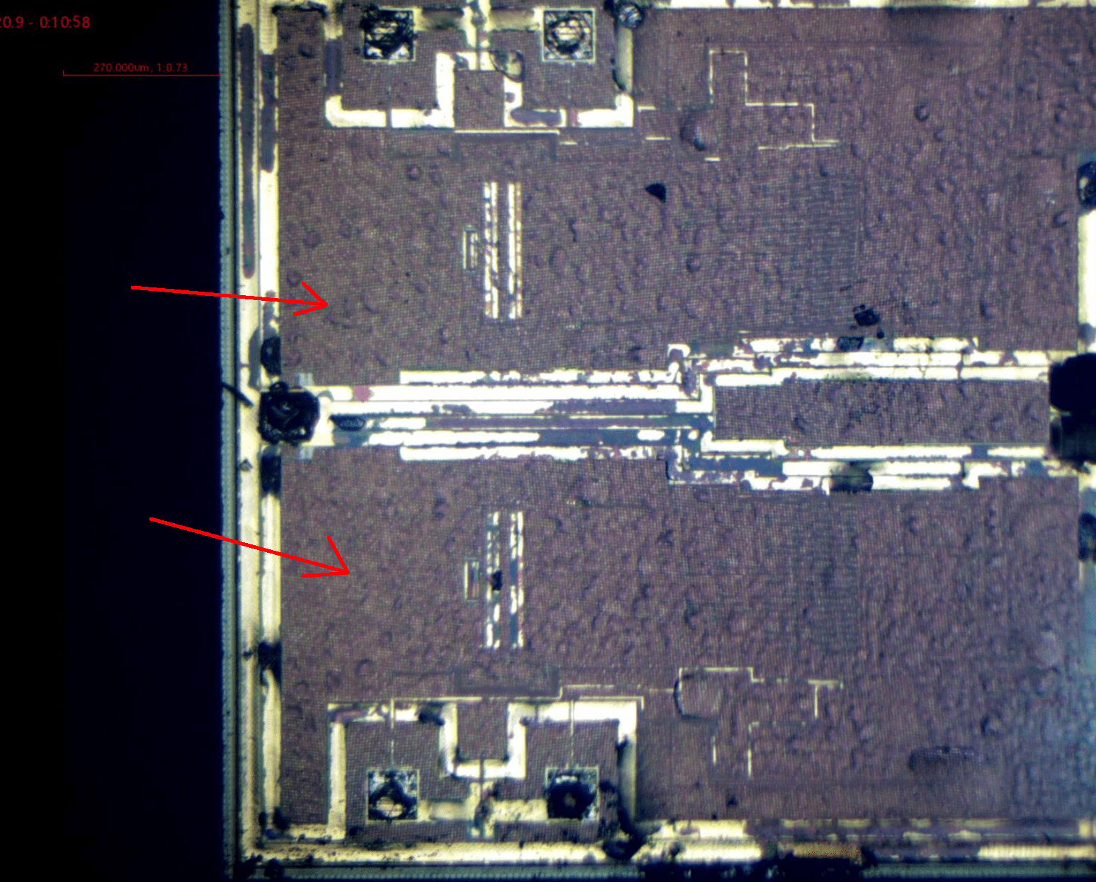

The black "shield" on the OPA1612 is probably a stress relief coating. Without it the stresses from packaging wrecks the DC offset.
The picture of the OPA1612 in the first post looks like density or fill structures.

I burned the plastic on the kitchen propane fire. No extra cleaning only a soft eraser. Some chips are clear enough after that, but some still need extra cleaning. As I remember from the NXP report(we had the case when 20K mosfets were returned), the plastic compound was resolved with hot H2SO4.

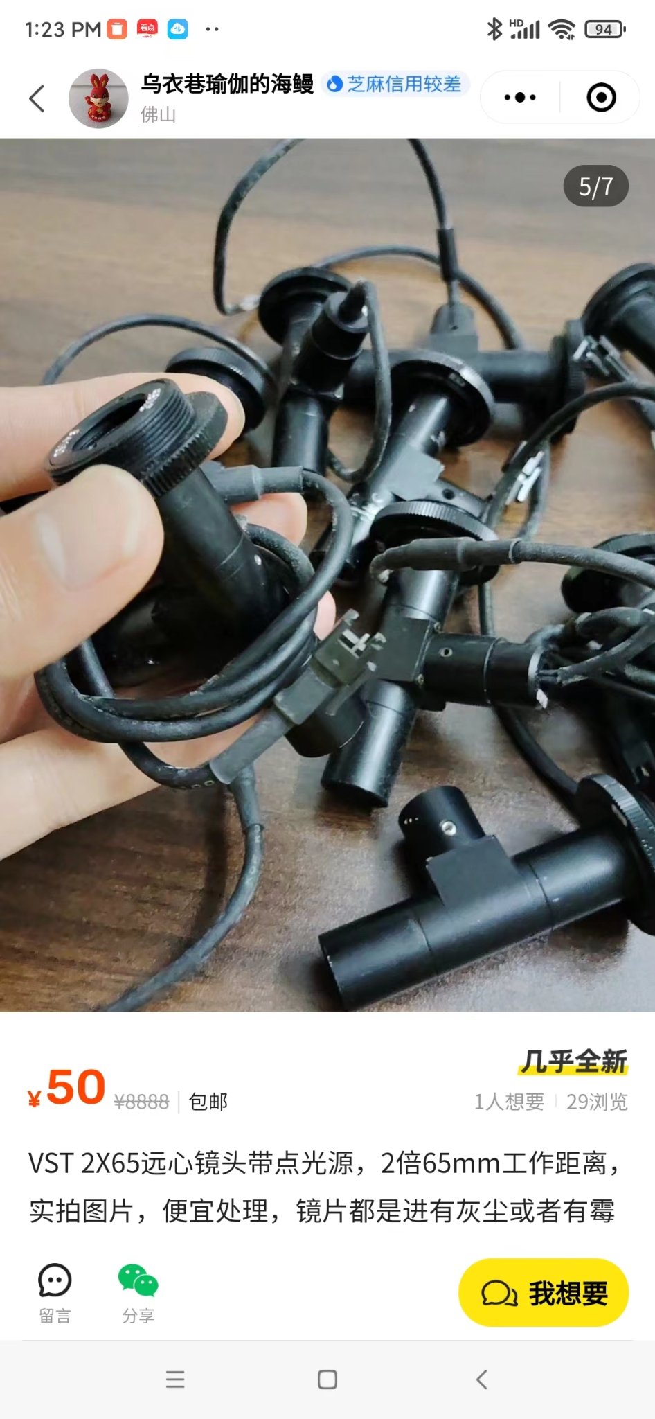

BTW, I found a similar optical device from the same Japanese company with specified resolution and distortions but with no zoom, just fixed optical mag-ratio. I see that pipe with the coax-LED cost is ridiculously cheap 50RMB i.e. $7.. I have no doubt it should work too.

Oh, I see now it was OPA2156.Mostly I was impressed not by the quality of these pics but by the price difference DIY version vs pro metallurgical microscope.
I found some die but not sure if it is old OPA1612(maybe 1602), however, you can see the dark film over the silicon I mentioned above.
