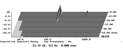

However i am a firm believer in measurements with accelerometers like some magazines like Stereophile do.
I would build a very stiff cabinet. Then i glued and fastened those lead plates in the center of all the side panels and then check with the accelerometers for any vibes.
I am pretty sure i will get a result like this (depending on the amount of lead used of course). All the panel vibes will be absorbed completely by the lead plate. There is nothing like the lead. No rubber mat can even compare.
Just hit a lead panel with a hammer ... you will hear almost nothing.
http://www.stereophile.com/images/archivesart/bwll801fig03.jpg
![bwll801fig03.jpg](https://www.stereophile.com/images/archivesart/bwll801fig03.jpg)
And the sound would be spectacular. Completely free of boxiness.

Hi gino,
(i am a fan of Norway due to the landscapes - and the people - btw. I nearly drowned in Geirangerfjord when i was 16 ... then some fishermen pulled me out of the water ...
but "acceleration" or amplitude of vibration of the cabinet's walls does not tell everything.
Imagine a cab. made of "rubber walls". The walls might vibrate significantly at low frequencies. But the propagation speed of the bending waves in the rubber will be low, because "structure born sound" in rubber is typically slow (because of low stiffness).
Wavelengths of the bending waves (in our example "rubber cabinet") will typilcally be much smaller than wavelenths of sound in air:
And as long as this is the case, a modal "vibration" (of a panel) will not radiate sound efficiently, because zones of "positive" and "negative" pressure near the surface of a vibrating plate e.g. will cancel out, due to the "pressure gradients in air" moving faster.
But when you have a panel material with - depending from frequency due do "dispersion" - higher speed of bending waves than "sound in air", then there will be "efficient" radiation (which is unwanted in a loudspeaker cabinet).
So vibration or "acceleration" in a zone (or just a "point" ?) of the cabinet, does not tell the truth about "total sound radiated".
In fact an accelerometer does not tell anything about that:
I have to tell this, although i appreciate the "measurement sections" in Stereophile, as they tell a lot about e.g. speakers and amps ...

Hi gino, (i am a fan of Norway due to the landscapes - and the people - btw. I nearly drowned in Geirangerfjord when i was 16 ... then some fishermen pulled me out of the water ...)
Hi ! i am expatriat here. I am italian. I do not like hot weather, but this is too cold for my taste. Yes the country is very beautiful and wild. But it is for tough people. And the water is very very cold all the year.
my reasoning is very trivial and i am not sure that is right.
We hear a driver because it vibrates and the vibration moves air.
When the driver is still (no signal applied) we do not hear sounds.
The same for me applies to speakers panels. We hear them only if they move, vibrate.
Do you mean that an accelerometer has a limited bandwidth maybe ?
Actually i find this ... it seems that they have issues at higher Hz
so it could be that high Hz vibes are not detected. This is a problem.

It is difficult to understand for me but i trust you.
I wonder why they keep on doing this test that is flawed in the end.
I know that some big manufacturers used laser interferometry to measure panels vibrations
I think B&W has used that. I am afraid not a system that the average hobbyist can afford. That should be the best i guess.
