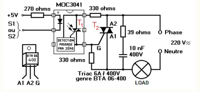

That's the circuit I've been looking at. This will be a stand alone module. I might make it stackable under the control board and swap the control terminal blocks for board interconnects. I'd like to use heavy barrier strip. I hate those stake on quick connects. On board in rush resistor as well. Power in from mains - power out to transformer. No external wire mess.

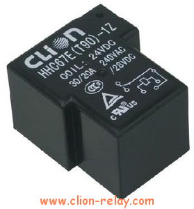

I don't mind mechanical relays. T90s would work good here. I just want to build some SS relays just for the experience. I mainly just want to remove some clutter in my amps with a power module.As I stated - what's wrong with the standard relays ?

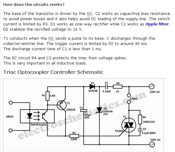

I see few negatives for ckt #1 other than cost and Pd for the triac. Do not really see what ckt #2 buys you, other than more parts or the old way to do before MOC3xxx were introduced. Before that they used trigger transformers.

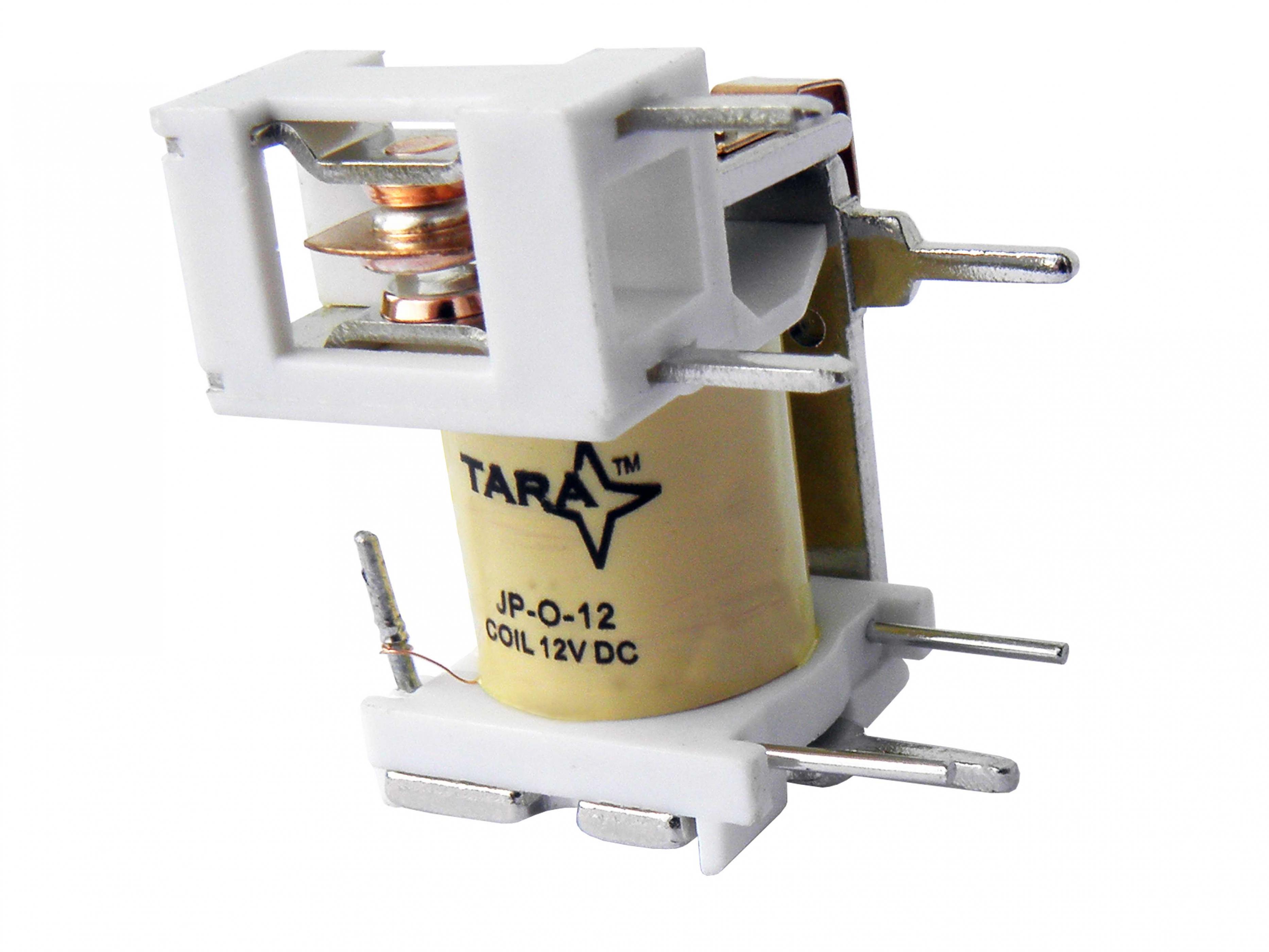

The other possible issue with mechanical relays would be contact bounce from vibration. It could be a problem in a plate amp. It's not usually an issue in automotive relays though.
Circuit 2 is to protect against false firing of the triac due to dirty mains.(This is why I do projects like this. I learn lots fast while designing)

For relays of this size, that is one heck of a lot of vibrationThe other possible issue with mechanical relays would be contact bounce from vibration
So you are saying that false triggering is an issue/flaw with ckt #1, so is it an inherent design flaw and there is no way to prevent it, (with higher dv/dt devices, hash filters?)
I just took a closer look at circuit 2. It's not the circuit I thought it was. From what I've seen on datasheets there is normally a pair of resistors in series on the gate of the triac with a snubber cap in the middle of them to stop false firing. That's the circuit I was referring to.

Edit - T90 ? oh ... microwave relay - yes .. common parts !

I'm accustomed to seeing vibration damage in trucks with millions of kilometers on them so I likely worry too much about it. I've seen wires chewed through by the ties and loom that are supposed to protect them. Older through hole circuit boards and early SMT wave solder boards used to crack solder joints and spit components out. It's amazing where a screw or nut can end up when they rattle out. They don't always fall down. They can easily fly upwards from bumps or other moving parts. These sub amps definitely need a lot of thought."Clutter" ?? I must admit the larger control board made for a spread out clutter

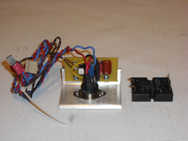

just for your information and consideration. I successfully used the Omron SSR Mouser part number 653-G3NE-220TL-USDC5 to turn ON/OFF my amplifier with no problems. Just as a warning there are two types of SSR one with zero crossing and the non zero crossing. I used the non zero crossing since I used my own zero crossing circuit to turn ON/OFF the amplifier. Just required one output port. At the beginning I used the discrete components one using the MOC3020 with the Mouser triac Part Number 511-BTA25-700B but then decided why invent the wheel when you can buy it already built in a black module so I decided to buy the Omron black module.
Attached it is a picture showing both SSR the black module from Mouser and the discrete component one.
