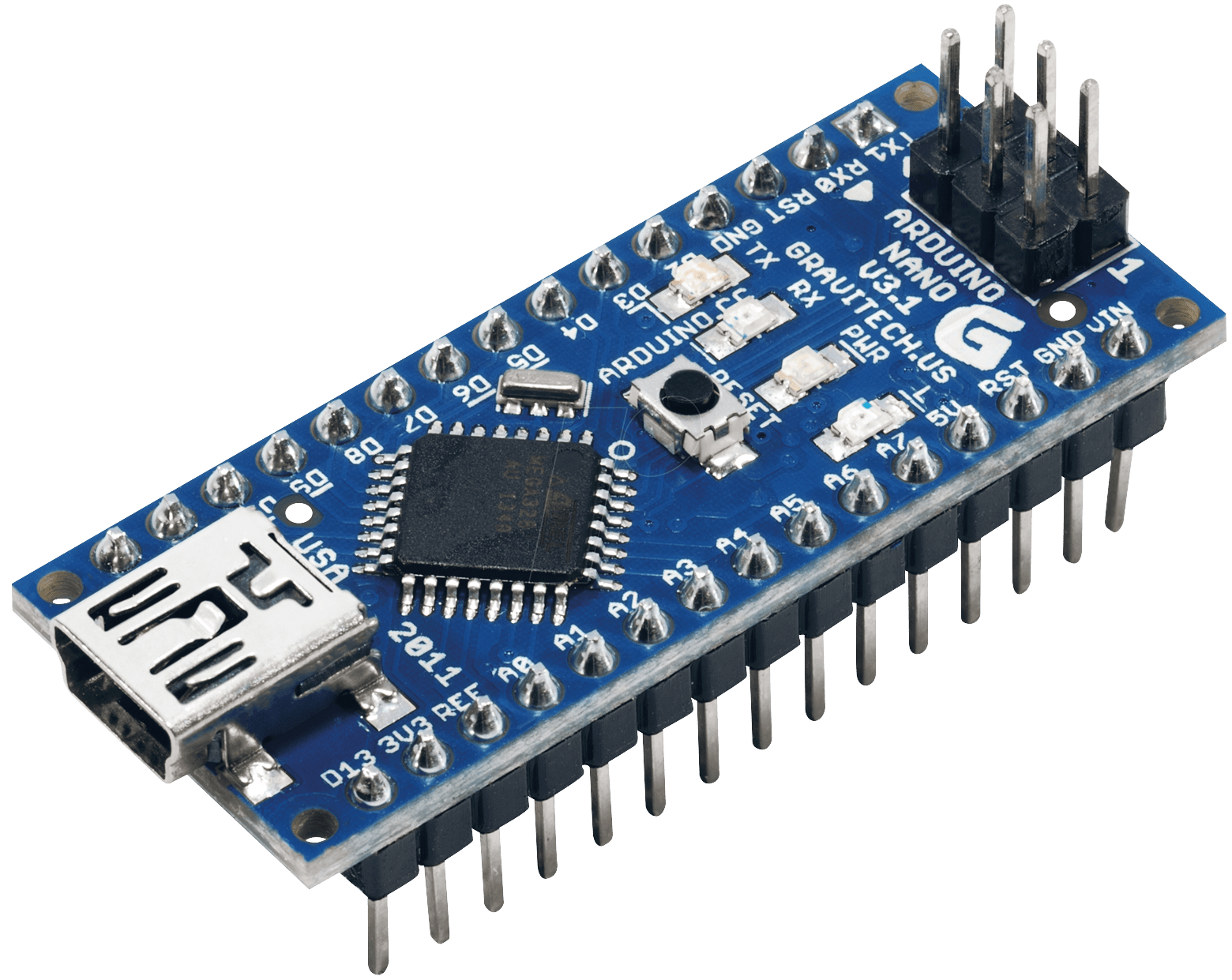

Also , are the "RX/TX" pins accessible for USB ?? I want to play.

That's right. Arduino has got FTDI chip on-board (at the bottom side of PCB - not visible on the picture).
This allows using standard USB interface to access its RX/TX.

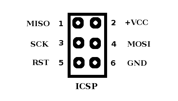

There is also set of ICSP pins on the other side, allowing direct access using serial interface.
For me - USB is more than enough (I'm not going to change the boot-loader or something like that
I just pop the Arduino out and connect it but I think pins D0 & D1 are com lines.
