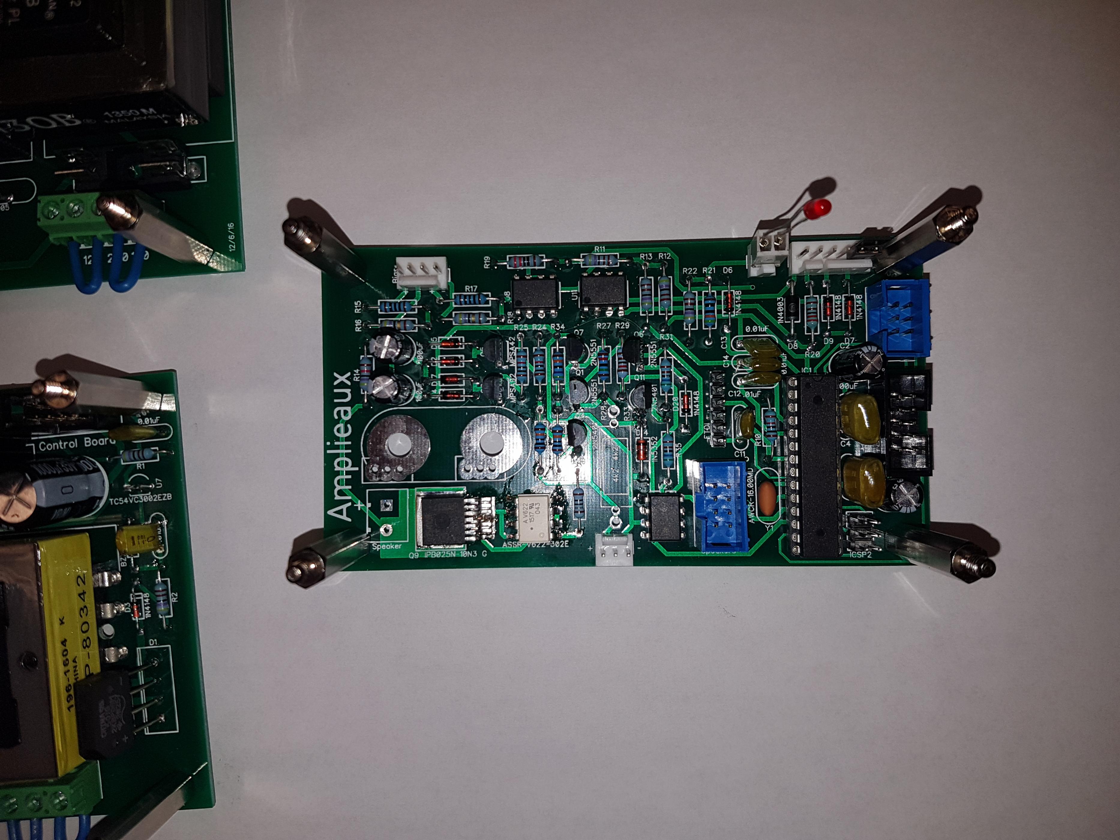

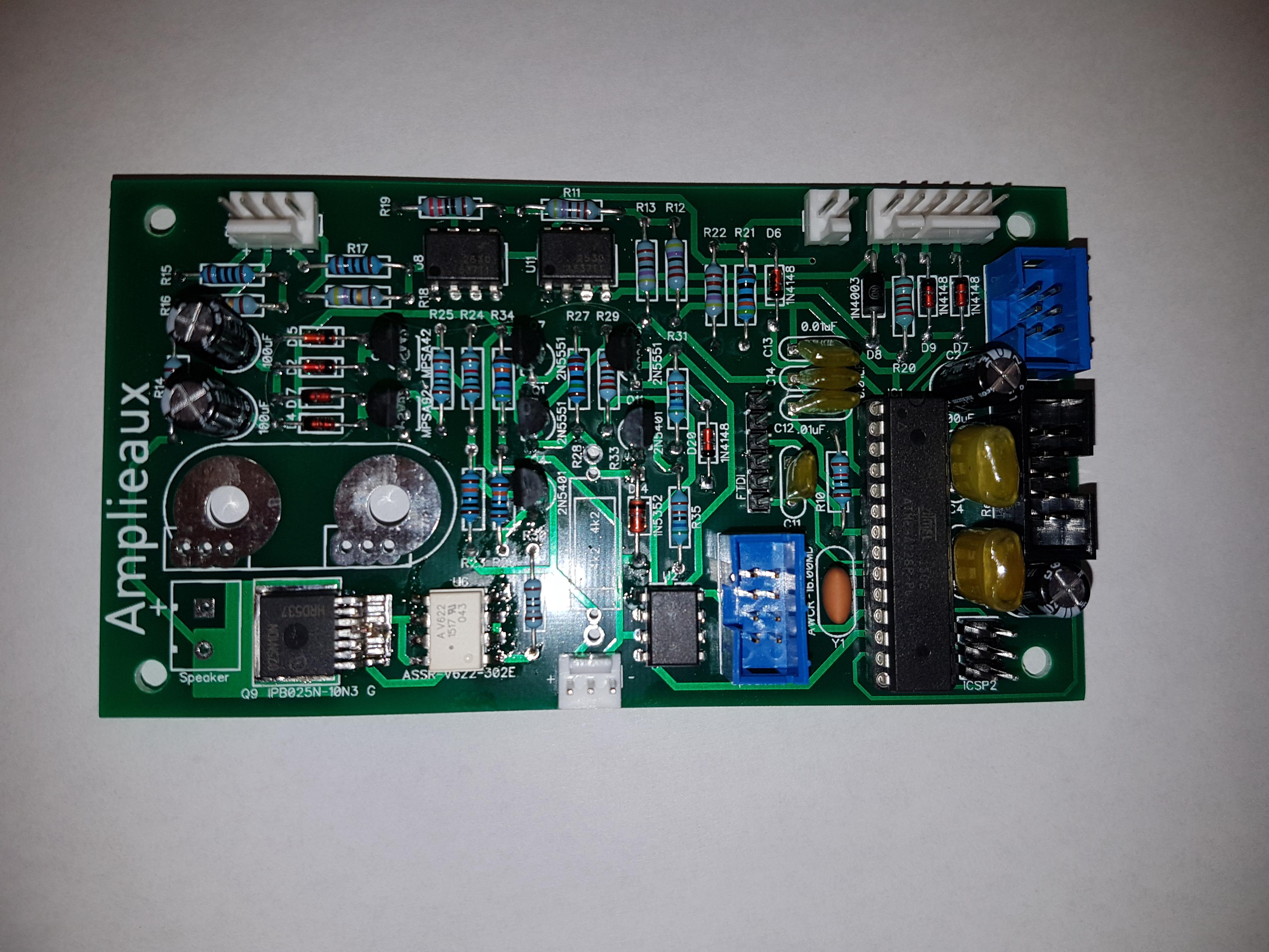

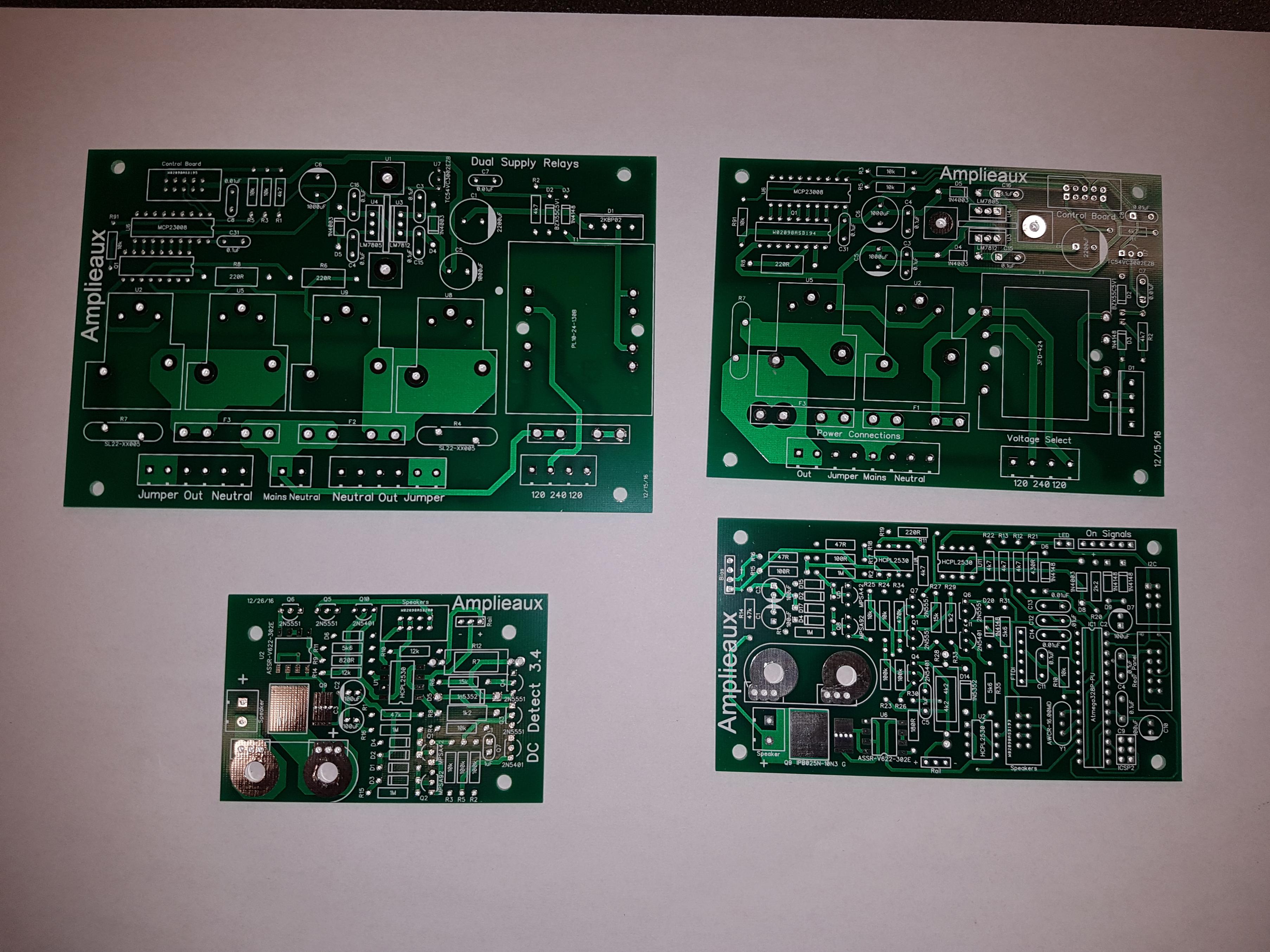

I've had a chance to assemble a set of prototype boards for the new through hole versions of the protection systems. I've got a small bug in the relay boards so I'll need to do a round two. I should have them next week.

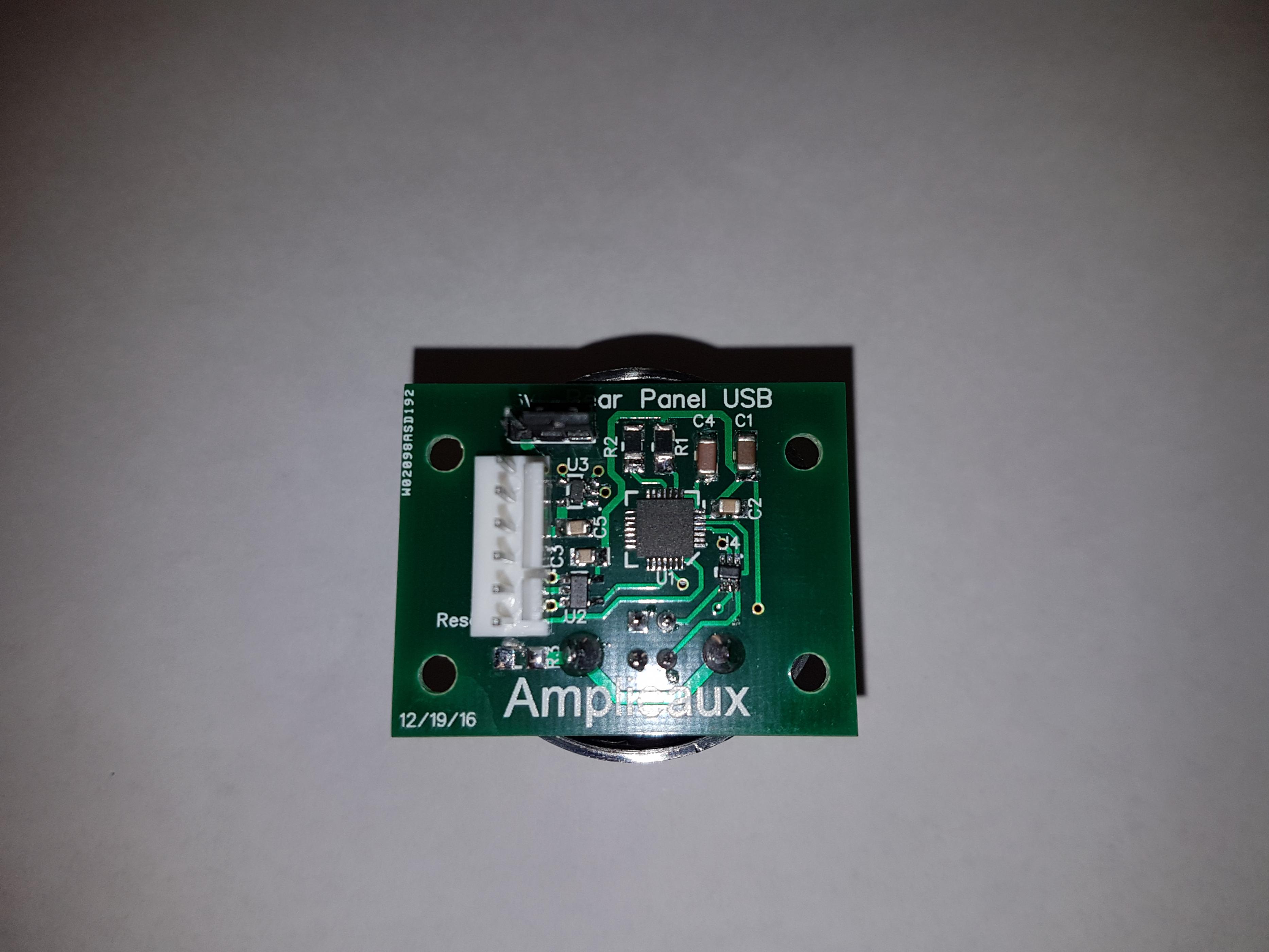

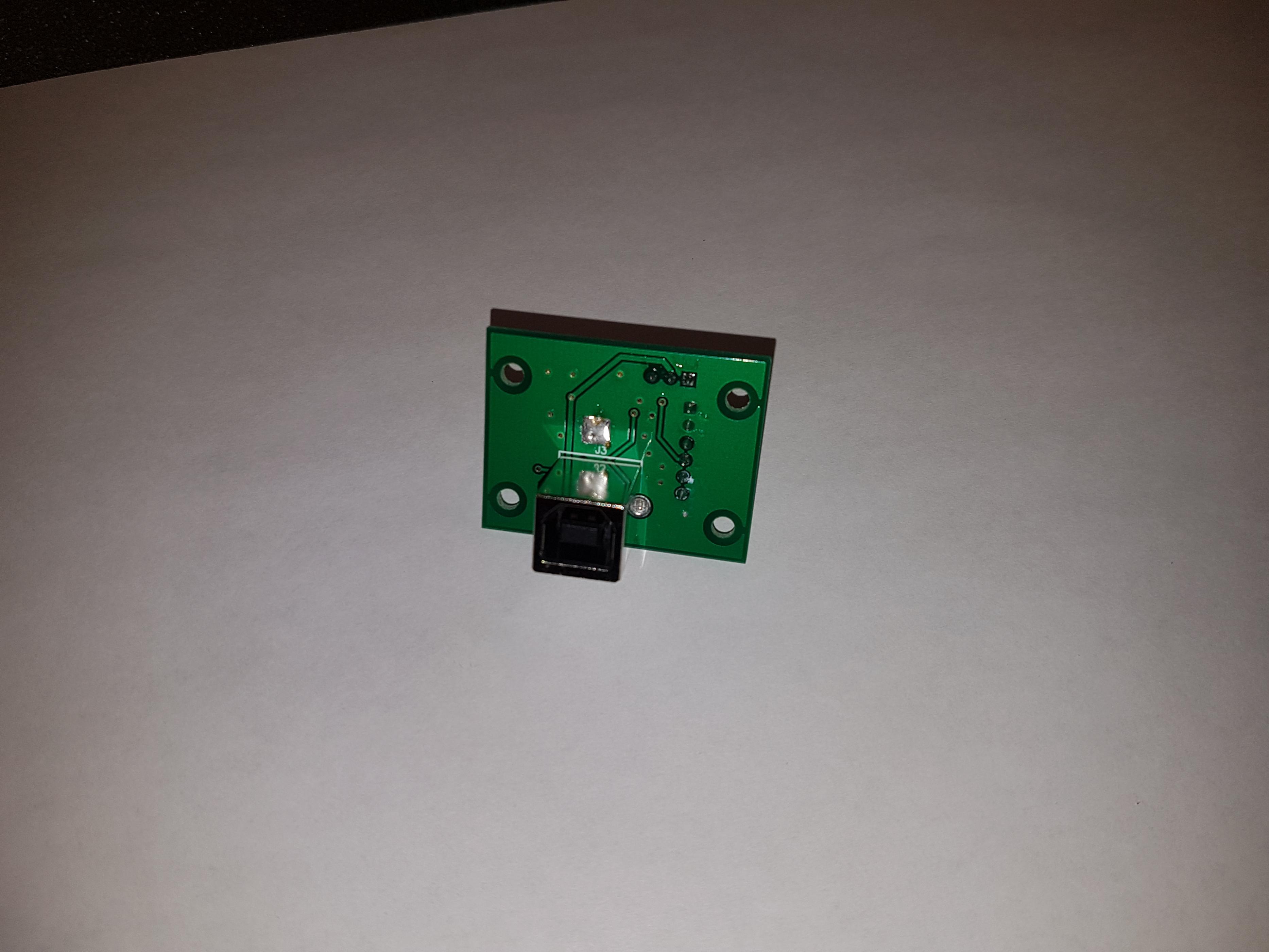

I've gotten my debugged versions of the through hole protection boards assembled and working flawlessly. I've also got a USB to serial adapter that mounts in the rear cover of the amplifier.

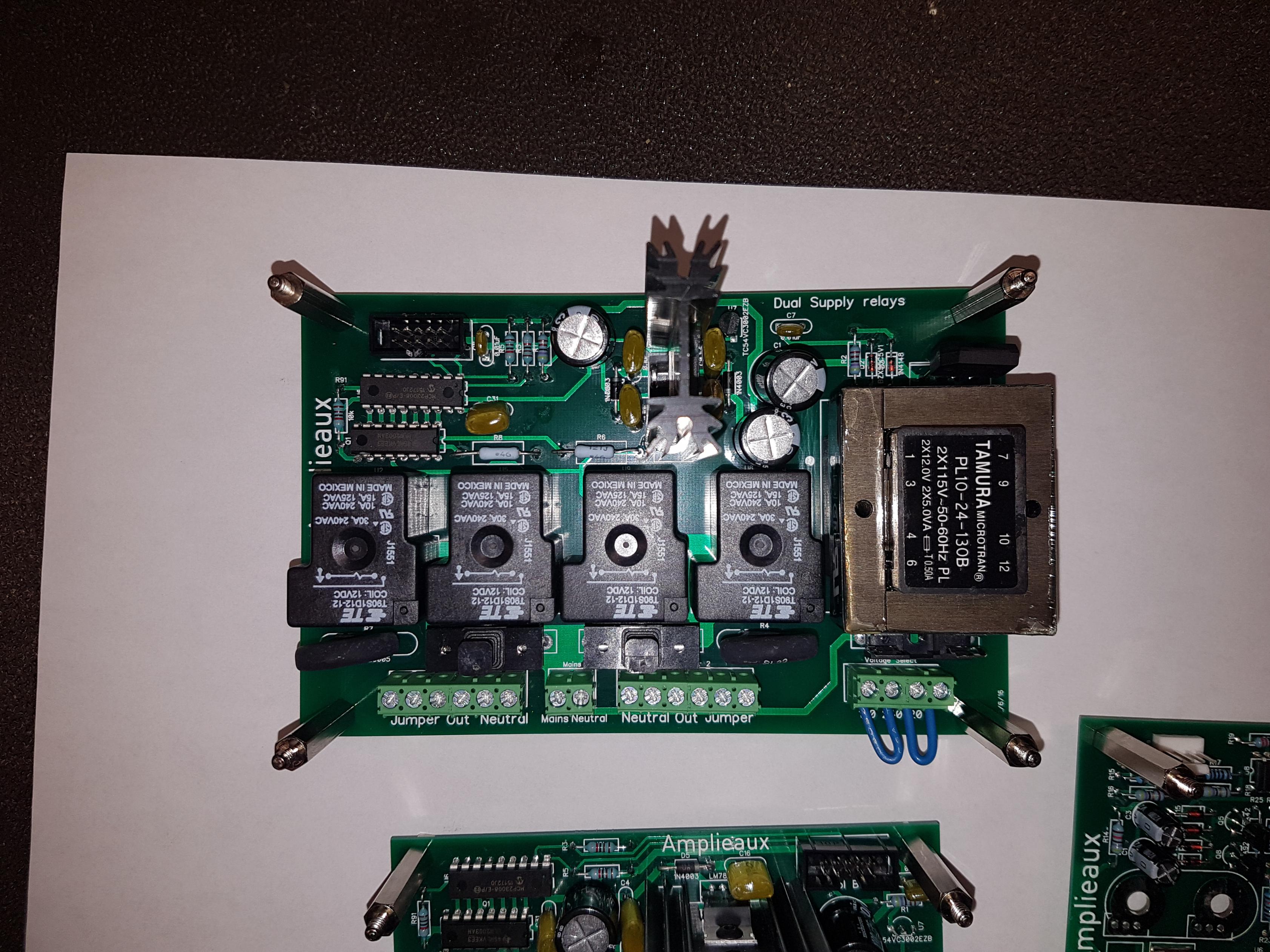

I noticed you have a 4 relay version of this board now, have you done any more tube amp protection boards lately?

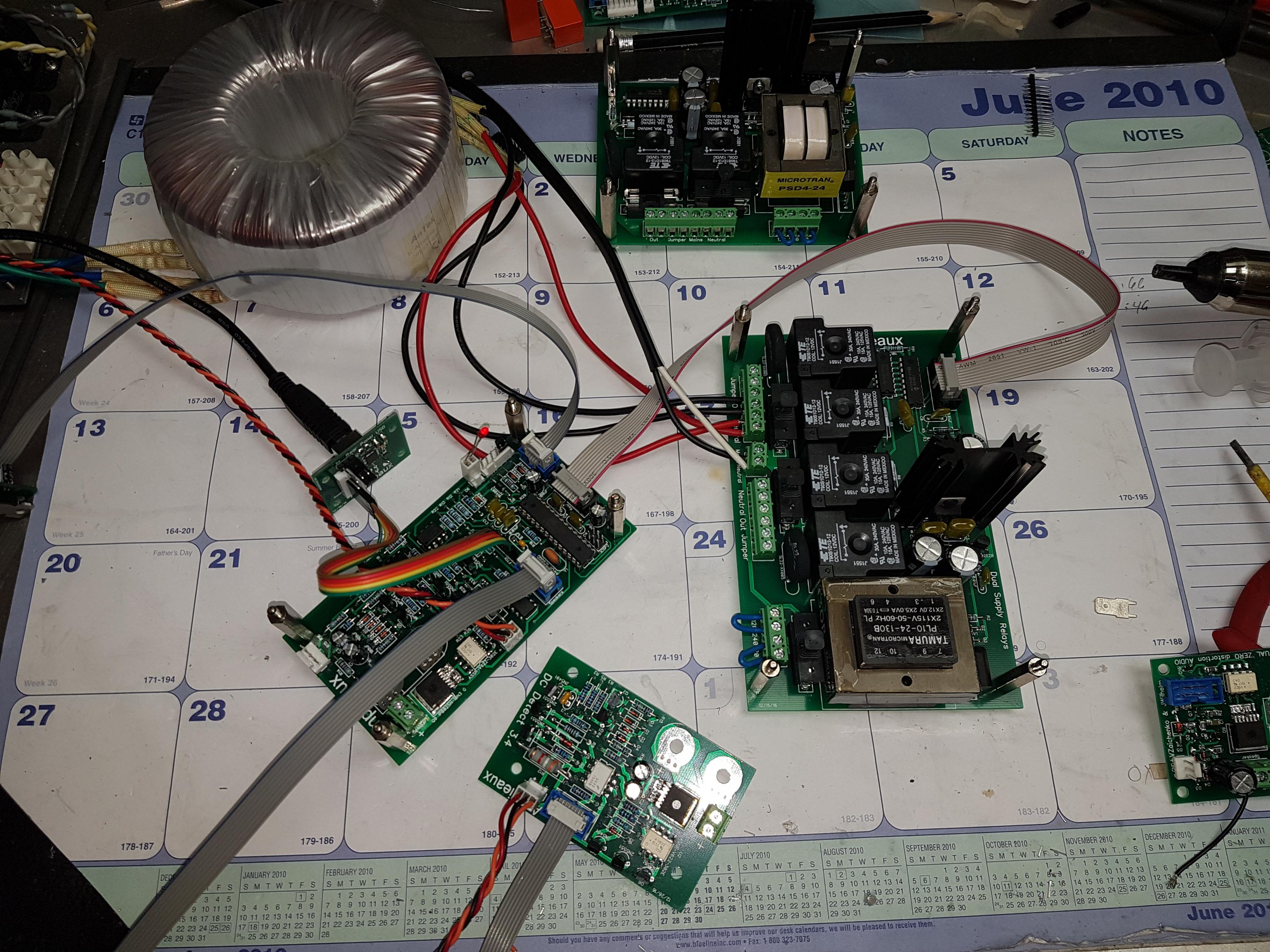

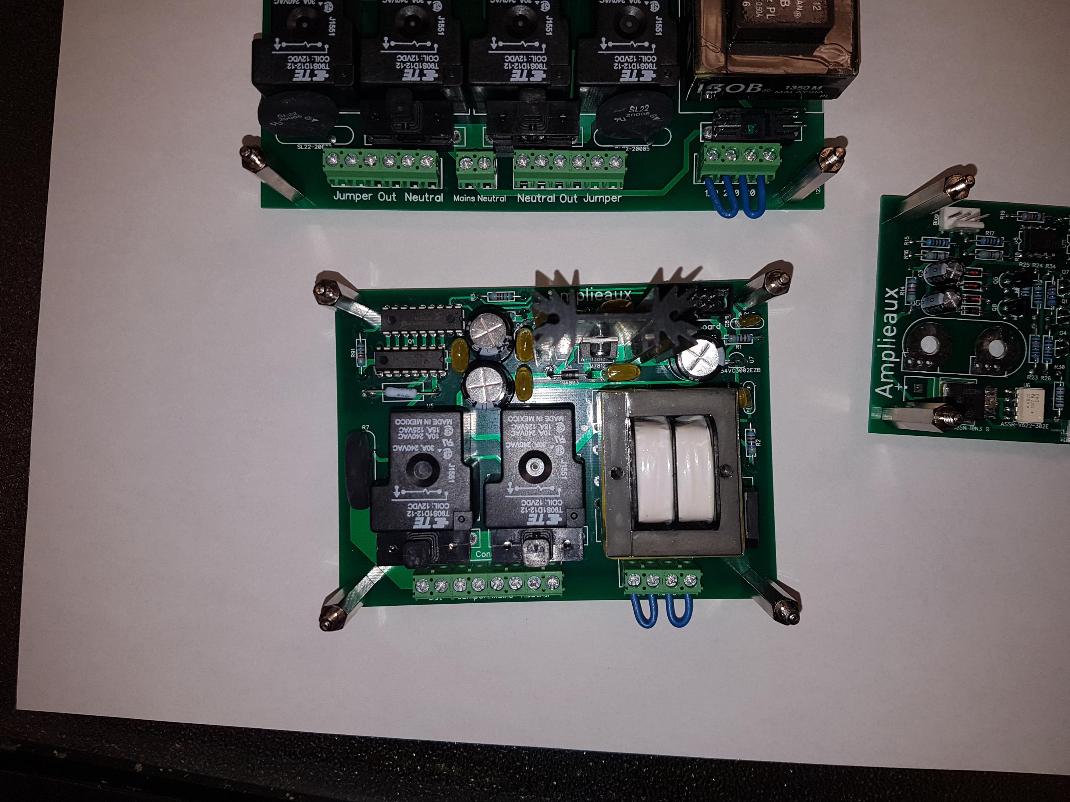

I've got a couple different versions of tube hybrid protection systems running. The four relay board is actually two outputs with softstarts. I've also got a control board with 5 relays on it, but it's two outputs with softstarts and an auxiliary out.

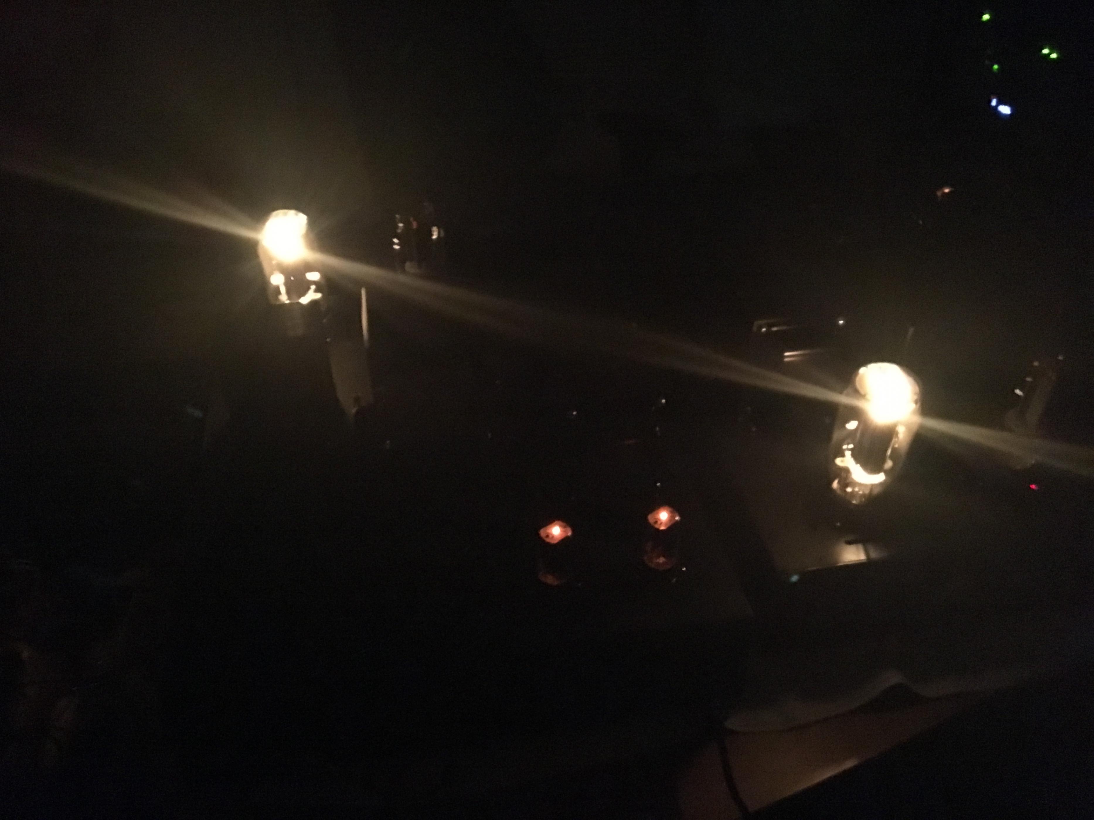

Attached some audio porn
Red glow is led bias on 6E5P
