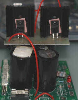

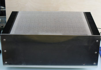

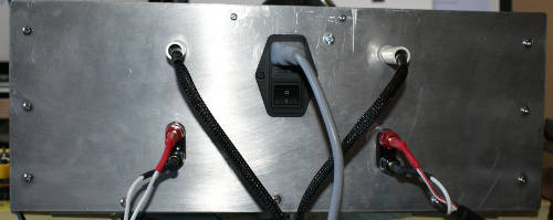

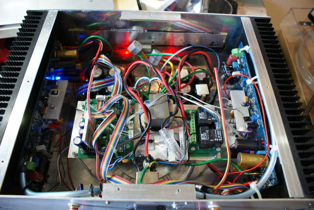

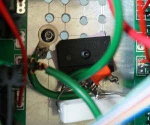

Attached are a few final photos. There's even one showing "attic conversion" extension to fix up the diode shorting on the old PSU boards 🙂

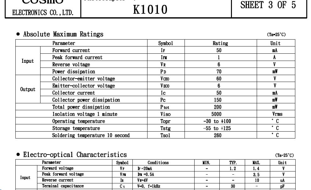

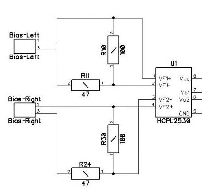

hi vzaichenko, how to calculate the resistance limiter (r10/r11) for a 500 watts amplifier +/-70 volts rails. the emitter resistor is 0.22 ohms.
thanks,
dacz
Hi Dacz,
How many output pairs do you have?
We measure the current in a single pair, so most likely you will not need to change any values (more power / more pairs = roughly the same current levels through each pair). But let's see.
Valery
hi,
thank you for the quick reply.. my amp has 6 pairs. and my opto is k1010
OK, here's what we have, based on a simple calculation.
500W @ 8 ohm means 7.9A RMS, equal to 11.2A peak current.
Dividing it by 6 pairs, we have around 1.9A peak current per each pair.
OK, let's round it to 2A per pair, assuming some tolerance of current distribution.
2A per pair is the maximum we can reach.
Now - let's see where our current sensor is going to trigger.
Our opto triggers at around 1.4...1.5V, equivalent to 2.0...2.2V across 2 x 0.22R resistors in series, meaning roughly 4.5...5A per output pair.
Your opto is slightly more sensitive - it's going to trigger at around 1.15...1.25V, equivalent to 1.7...1.84V across 2 x 0.22R resistors in series, meaning roughly 3.9...4.2A per output pair.
So, the current, protection triggers at (4A), is roughly 2x higher than the maximum peak current through each output pair (2A). On one hand - it's a good margin in terms of false triggering, on the other hand - it must be pretty much within the SOA of your output devices, right?
That means - you can leave the resistor values as they are 🙂
If you'd like to slightly increase the current it triggers at - just slightly increase the value of R11, R24 - up to, say, 51R...56R.
