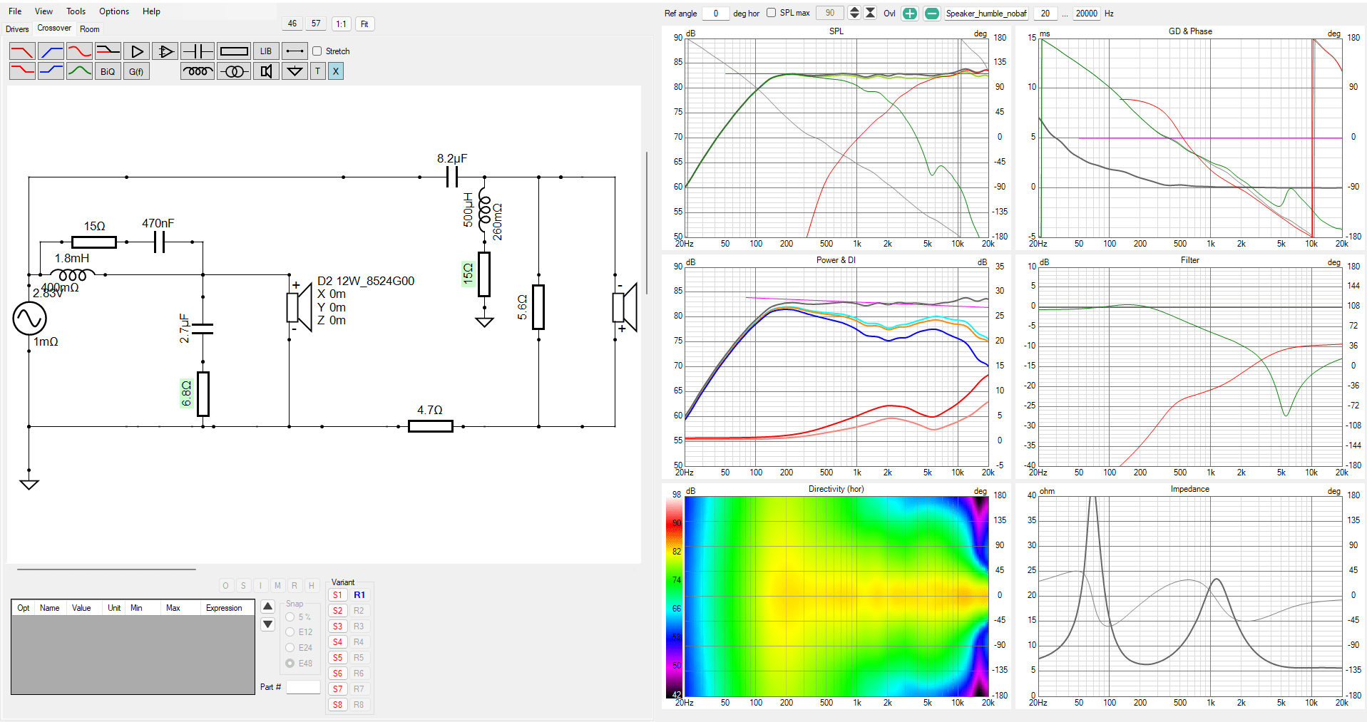

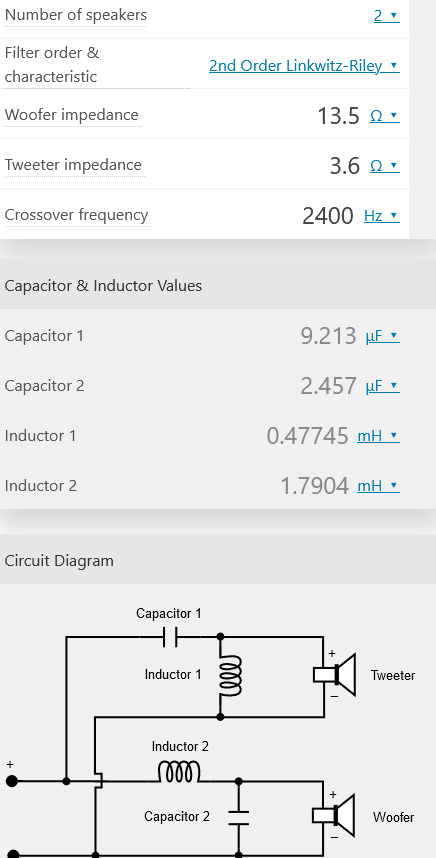

How to calculate the Q factor of the LPF and HPF component? I calculated the following component values
With the calculated component values the Q factor is around 0.5

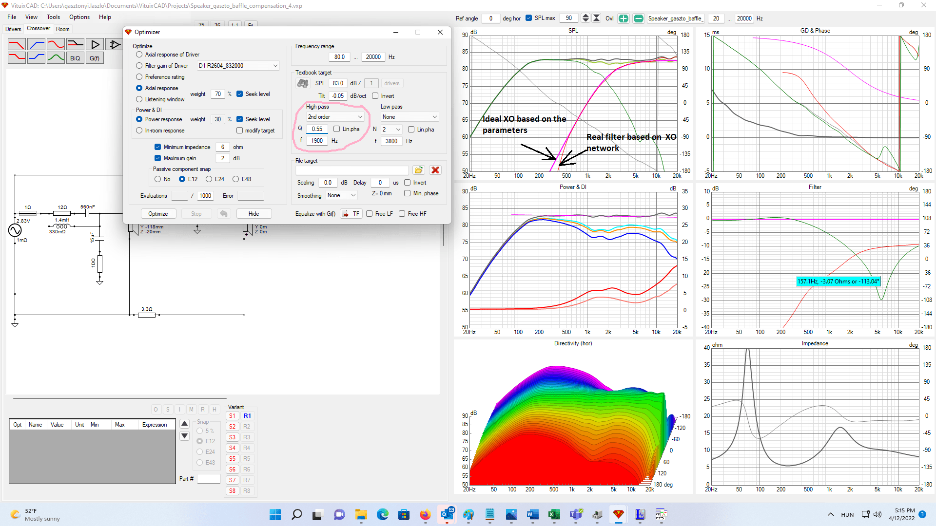

But for the flat frequency response I had to add two more resistors to the 2nd order LPF and HPF. How influences those resistors the Q factor. Resistors are marked green on the following picture
The Q-factor for a Linkwitz-Riley filter is 0.5, as it is the equivalent of two Butterworth filters (Q=0.7071) in cascade. However, in order to find the Q-factor for your circuit, it maybe necessary to evaluate the actual transfer function, as the addition of resistors has caused the same to deviate from that of the LR filter. Besides, the HP and LP sections after the adjustment need not have the same Q-factor either.
