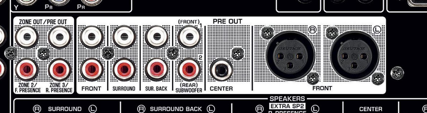

I wanted to use the Yammy as my DAC and was hoping to get line level output for 2 or more channels (depending on if my source is 2 channel or multi channel) and then split each channel into 2 and apply a DSP crossover and then feed the split channels to my second receiver as multi channel inputs and get the speaker level outs that I can feed the tweeter and midwoofer of each speaker individually.
Mooly - If you look closely all the outputs are "PRE-OUT" and *not* line level.
They would work perfectly if all I needed to do was feed them to a PowerAmp.
My needs are different - I need them to be line level so I can split two ways (for each channel) and then do a crossover (to split the signals for Highs and the other for mids and lows) and *then* feed them to an amp as line level multi channel inputs.

You still do not understand that "PRE-OUT" and "line level" are the SAME level.Mooly - If you look closely all the outputs are "PRE-OUT" and *not* line level.
You are confusing level (measured in mV) and Function, absolutely different things.

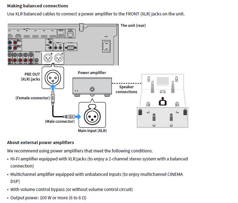

I think what the OP wants is pretty clear. He wants a line level output that bypasses the preamp. Direct from the DAC output.
It seems that the pre-outs are post the preamp and volume control.
Provided that hacking the chasis and circuit is acceptable, it would seem the way to do this would be to find the point in the circuit before the preamp and tap off there. Ideally cutting the traces and installing a dpdt relay on a daughter board to either send the signal to the pre, or straight to an additional set of outputs on the back panel (assuming there is room to installl some). Obviously an additional switch would be required to toggle the relay as well.
edit: note that this assumes that there is an appropriate buffer after the DAC output, before the preamp.

EEEEGXACTLY! Finally!!!! Thank you for understanding the subtle yet key issue!
Basically from what I have gathered, there is no real easy way to get to that DAC output prior to it reaching that preamp and the whole volume control stage unless I do a hack at the physical level - which I do not think is feasible for me.
