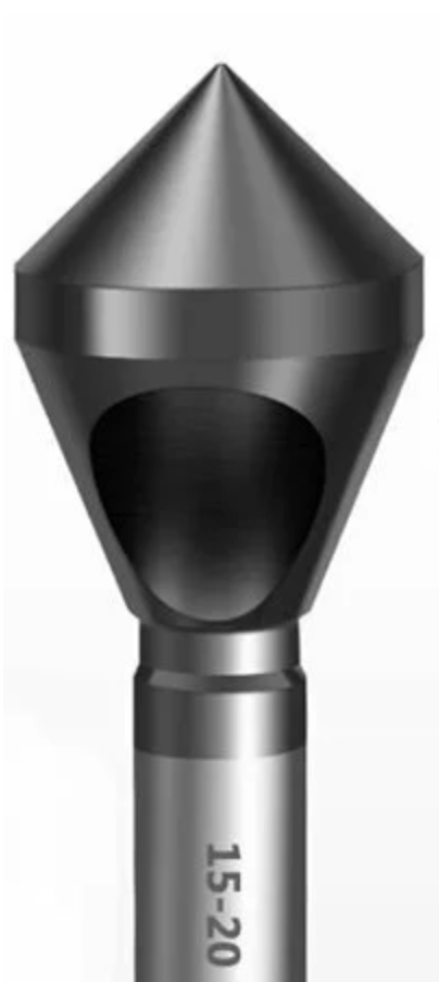

I'll second Tom's advice. Those bits are called ''Querlochsenker'' in Germany.

The more I think how it went, the more I'm convinced it's mainly a dull countersink...
I'll try the Querlochsenker first, plus a hand-tool and maybe a countersink with 5 blades (flutes), said to be efficient on soft metals…

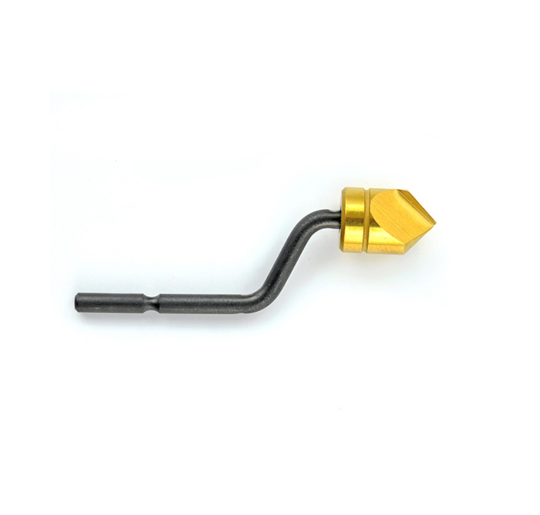

(From the website: „As many engineers appreciate, the cost of hand deburring can be greater than the cost of the manufactured part.“)
on the other hand, @Mark Johnson ‘s advice to make the tool from wood is the one costing the least money and I’m sure it is working as good as I imagine it is a fascinating old school technique—haven’t looked it up in detail yet but glimpsed at the Janka scale and found „snake wood“ 😎 …
(((and I once again wonder where the hell did he gather so much knowledge?)))

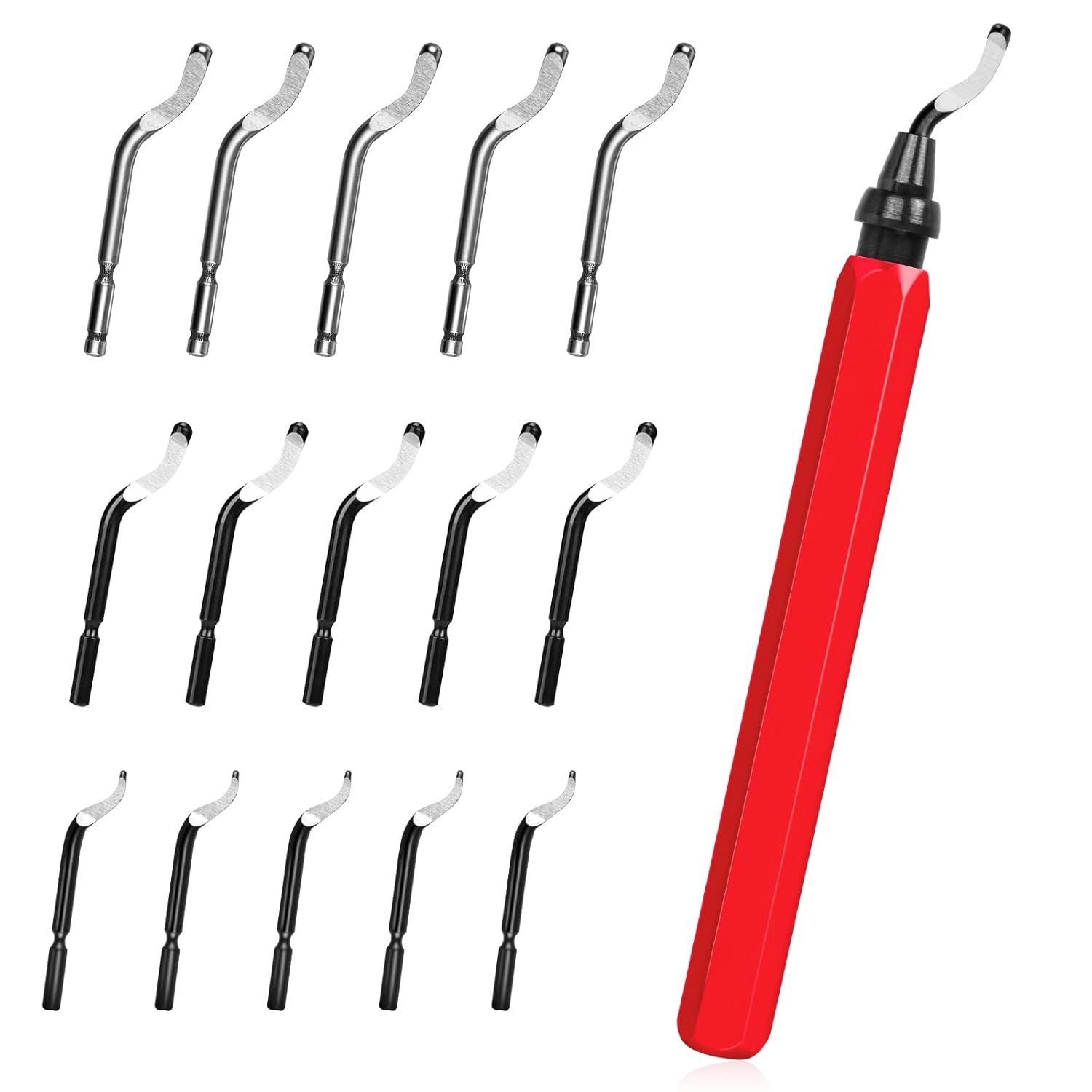

A 10-15 dollar swivel deburring tool is sitting at your local hardware store (or amazon dist ctr) and would make fairly quick work of it. Hell, a slightly larger, sharp drill bit hand spun over each hole would work fine. Sanding, as pointed out would work as well. The bright exposed aluminum hole edges would drive me nuts, so I'd be painting it anyway for a more finished look.

Have you tried googling 'deburrer'? It is a little swivelling blade with a handle. Come in different sizes and you can do hundreds of holes in less than an hour.
That's what we used when I was still an aluminium welder/fabricator.
The ones above are great, and you can also get a bit that’s made for deburring holes of various sizes, which will fit in the same handle and make repetitive hole cleaning much easier…
“Noga” makes a lot of great inserts for deburring tools if you’re looking for something out of the ordinary…
