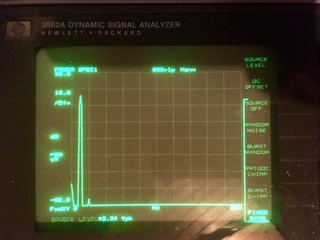

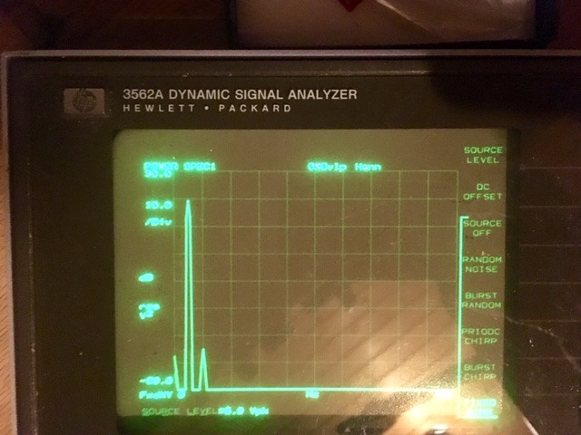

Attached two old snapshots from the spectrumanalyzer. The EMl 30A is loaded by ISO NC 20F interstage transformer, 1 kHz signal secondaries open during measurements. The first picture shows the spectrum at 116 V rms output, The second shows the spectrum at 77,3 V rms output. Tube biased at 400v@ 20ma.
I used the EMl 30a/ISO Nc20F comboas driver for the GM-70 some years ago, but last year I changed the drivertube to the EML12B (Gain 14.5 When transformer loaded). Changed partly because the 12B has lower internal resistance than the 30a Which is a bit on the high side for the ISO interstage transformer. The Iso interstage was used because I already had them. I plan to replace the iso with a pair of nano-x later this year. Suggest you ask Yves/Ward about which "driver current window" your interstages are comfy with. As you up the current in the EML 30a internal resistance go down. I have no experience with the EMl30a running at such low current as 8ma. At the working point I used it, I think it is excellent!
