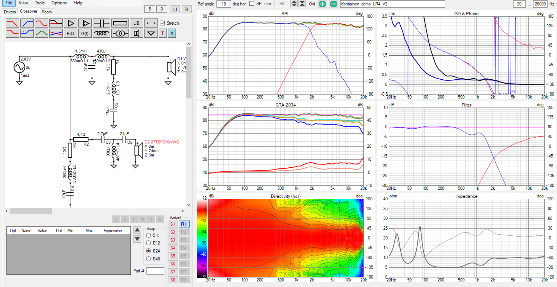

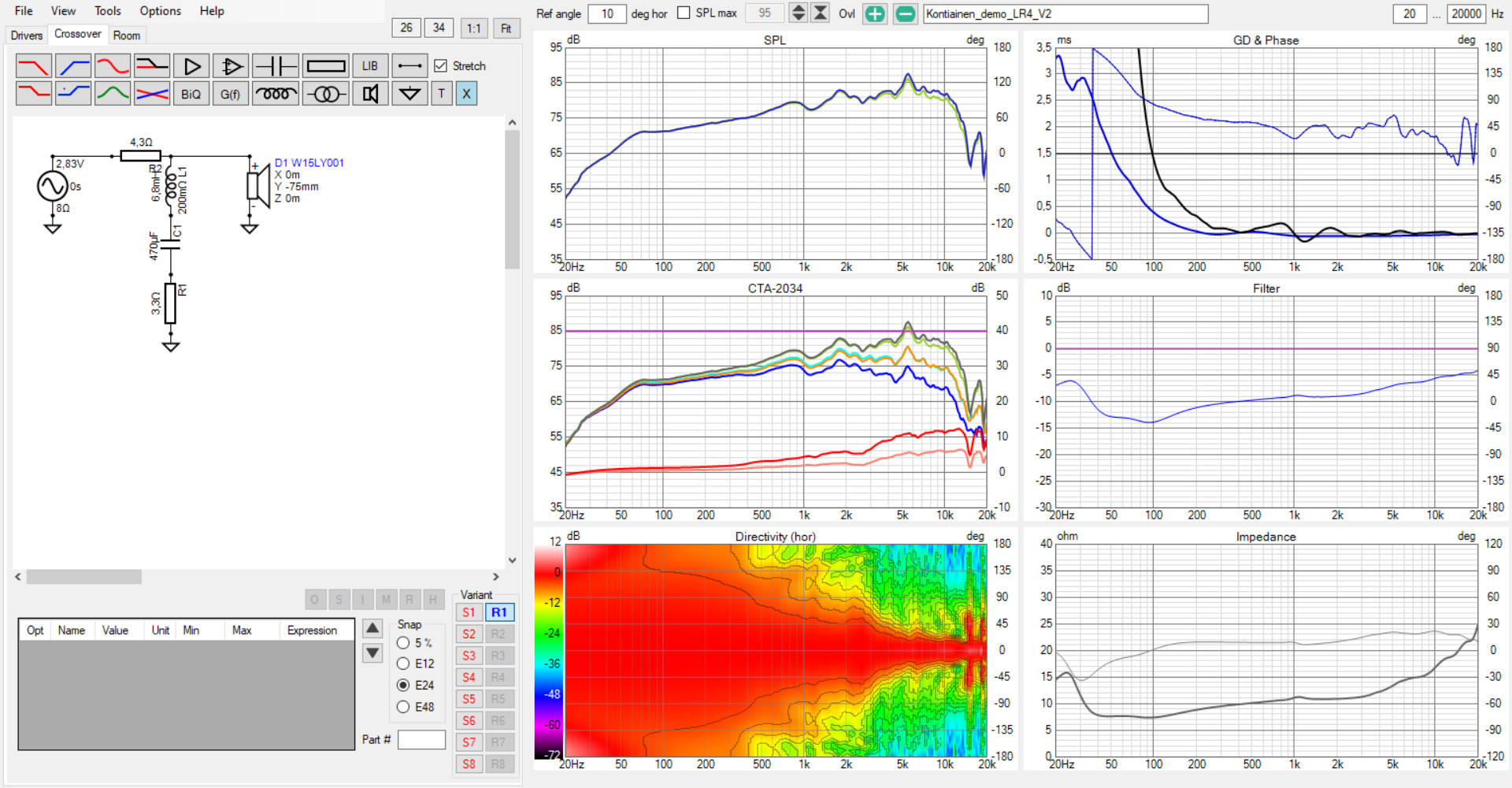

Here example of basic project that comes with VituixCAD. Changing amplifier output impedance here mainly affects woofer resonance, because of the impedance network between amplifier and transducer(s). Tweeter resonance doesn't peak, because it has impedance lowering shunt there.
You could just add another shunt for woofer and the response looks somewhat original, it restores some electrical damping by reducing impedance in series with the driver. It also affects load of the amplifier so works as EQ as well.
Obviously, you cannot lower impedance as low as with low amp output impedance, because the shunt is parallel with the driver as well. You could lower impedance of the shunt, and then counteract drooping lows by adjusting frequency response before amplifier. You could also restore the frequency response just with EQ before amplifier, without the shunt, but it would not increase electrical damping (lower impedance in series with driver) because it does not affect impedance in series with the driver. This you can do only by adjusting impedance in series with the driver.
So, damping factor is actually just low impedance in series with transducer so manipulate impedance in series with transducer by what ever means suitable in your case. That is enabling the transducer dampen it's own resonance with electrical damping. In addition to electrical damping you could dampen acoustically/mechanically by manipulating your box. If your frequency response is wonky after you are done, you could fix that independently with EQ before amplifier.

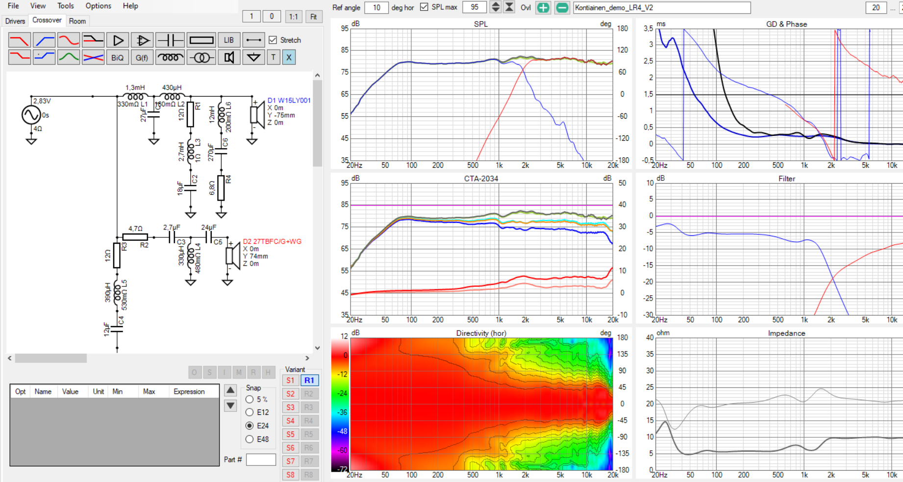

View attachment 1452657View attachment 1452660

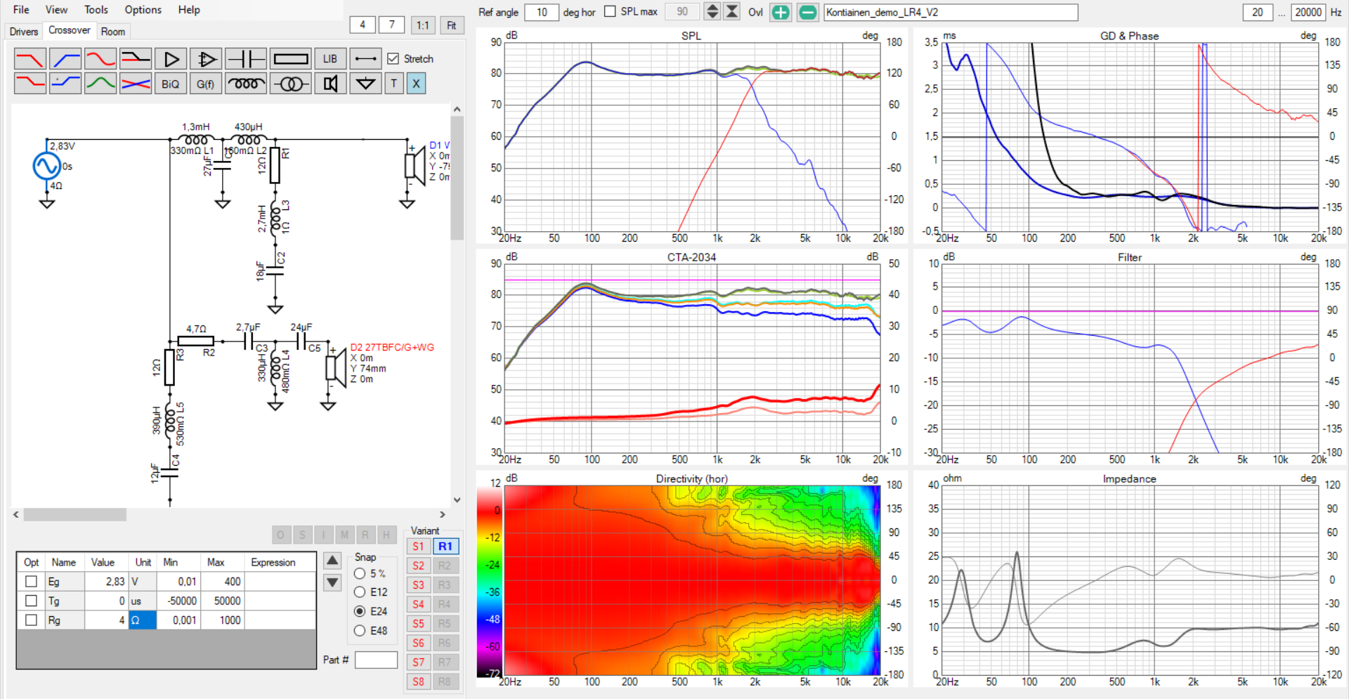

Meanwhile, if there is no suitable amplifier for such low load, and you cannot change the driver, you can try improve the sound by heavily damping the enclosure, which should reduce the resonance some. Also, make sure there is no peak in the response and EQ that out if there is, perhaps the damping is not such a huge problem.
If it's not enough, you could amuse yourself adding the shunt and then a series resistor to increase amplifier load, but if of course gets hot and loses sensitivity so it's a bad idea. But for sake of example this is how you could increase electrical damping some to reduce boom, without touching the amplifier.

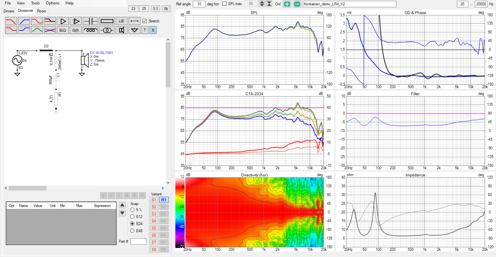

Here I emulate situation, output impedance is similar to driver impedance so there is peak on the lows, the woofer resonates and sounds boomy.
Adjust resistor in the notch filter down until boom reduces some. Use some series resistor to not have your amp oscillating. Here amplifier sees high impedance, and driver resonance sees "lower" impedance. If frequency response is now wrong, you could adjust that with your active xo.

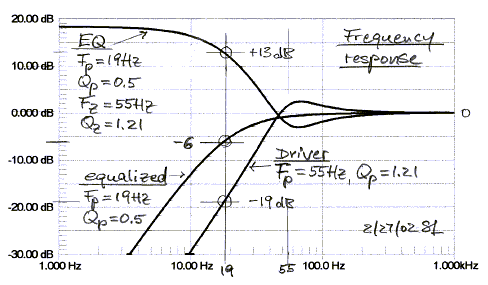

To accomplish what the initial post hints at, changing the Q of the driver in the system, I use an active crossover and implement the Linkwitz Transform ( 2nd order asymmetric shelf filter) to modify the low frequency response to have whatever cut off frequency and Q that is desired for the design. The filter essentially cancels the natural response of the driver and compensates the system to produce the desired response. This works equally well with woofers, midranges and tweeters. With the midrange and tweeter I use it to produce part of the crossover high pass filter by raising the F3 up to the desired crossover frequency. If this is done with a resultant Q of 0.707 a second 2nd order high pass filter with Q = .707 can be cascaded to form a perfect 4th order Linkwitz - Riley high pass acoustic response from the driver.
https://en.wikipedia.org/wiki/Linkwitz–Riley_filter
The Linkwitz Transform:
https://www.linkwitzlab.com/filters.htm
This filter is available in several software programs such as WinISD, the Hypex Fusion filter design software for use with their multi-channel plate amps and miniDSP features it in their filter design excel spreadsheet on the first page labeled LT at the bottom of the screen. I attached this as a zip file.
